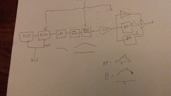

PostPosted: Fri Oct 23, 2020 7:25 pm    Post subject: Reply with quote  Mark this post and the followings unread
Updated URL for circuit diagram:
https://www.researchgate.net/publication/263228583_The_digital_pulse_forming_as_an_oldnew_sound_synthesis_principle
I have tried to reverse engineer the schematic fragment in my head, and there is a block diagram attached of my theory.
What seems to be going on is that the input pulses (which vary in height and width according to dynamics) are
1. low pass filtered (Sallen Key 12db .5Q ) at about 4.5kHz.
2. 6db High pass for some bass or DC removal by cap C2. Probably just DC removal.
3. a TCA740 stereo high/low tone control provide 2 pairs of voltage controlled seesaw potentiometers, arranged in series. Usually the TCA740 is used for stereo high/low Bandaxall tone controls, for bass and treble boost. Here, the high and low overlap, so you get a kind of mid boosting.
3a. The first is configured as a low boost-cut. However it is not at the standard point from the datasheets of 1k cutoff. Instead it is higher, more like 10k.
3b. The second is a high boost/cut. It presumably must use the same cv as 3a. And it again is not the standard 1k, but is lower, more like 600 Hz. So so response woukd be flat at 50%, 100% it would be louder with a boost betwen 600 and 10k (ie 2.5k peak), and at 25% it would be softer with a dip at 2.5k, and at 0% it would be softest. (I bet the Variophon trumpet only uses the 60 to 100%: cannot be seen in the schematic)
3c. The third is a VCA, going to the two formant filters 4
3b. The fourth is a VCA with going to the output. Because the signal goes through two vcas, this will gave an expo law response to envelope or adjustment, while the formants only are linear.
4. The output after the first VCA goes through two bandpass filters U11 and U12. U11 is at maybe about 1.2 to 4.3kHz, 2.5x boost. U12 is from 1.6 to 2.5kHz, higher boost.
So, assuming the expresion/breath/EF/ADSR is controlling the TCA740 CVs in a straight forward way:
* pp sounds go through the 4.5k Lpf and the two formant filters
* f sounds do too, but have the 2.5k boost too (which the formant filters will amplify too), and a little of the non-formant direct. The pulse width will be different (narrower and louder?) than the soft sounds.
* ff sounds will have more of the 2.5k boost and more of the non-formant sound. (Again the pulse width will be slightly different than the f sounds.)
So how does this fit into what the spectrums in the article show? In the article figure 8b, we do see that at pp most of the energy is between 700 and 2.5k, with a peak around 1.5k.
And ff adds more harmonics between 3k and 7k, and below 700. They must come from the direct unformanted signal, from the TCA boost.
 Filesize:  1.42 MB
 Viewed:  175 Time(s)
