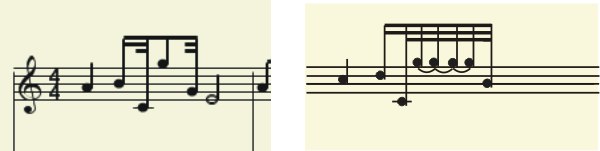

At present the notation interface for the software I am writing auto-parses note lengths to fit the meter but only down to the level of the beat as in the figure on the left. I could have it parse "all the way down" as in the figure on the right. Which do you prefer and how strong is the preference.
BTW I recognize that horizontal spacing still needs work.

Neither - IMO it's best to use ties to highlight the half-beats, not obscure them.

This might be an algorithmically simple way to achieve something sensible:
A note should not start on a boundary more than twice as fine as its length.
So, for example, it's OK for an eighth note to start on an eighth-note boundary or a 16th-note boundary, but not on a 32nd-note boundary that's not also a 16th-note boundary.
This rule is almost surely too simple, but it's a start. As an example of why it's too simple, it fails to account for the notion that in 6/8 time, it's OK to have a measure start with an eighthth note followed by a quarter note, but slikghtly weird for it to start with two quarter notes in a row. The reason, in this case, is that the latter example causes a quarter note to span the middle of the measure.
Thanks James that is definitely the way to do it.

Here's the algorithm I've worked out. Won't know if it's right till I try it Embarassed If any one sees a problem please let me know quick! And thanks again.
START
Find strongest accent in the half open span [ , )
IF that strongest accent is at the start of the span
break span such that the first part is the longest valid note consistent with max dots preference setting
Add note to decomposition list
recurse with remainder if any
ELSE
break span at strongest accent
recurse with first part
recurse with second part
END
The penultimate step is not properly tail recursive and I'll wrestle with that during implementation

It works! Because it is recrusive it should work at all levels of subdivision. And because it is a method of the bar's meter in should work in all meters. I'd say it was elegant except it still isn't properly recursive. But I had an Idea on how to fix that while cleaning stalls today LOL
