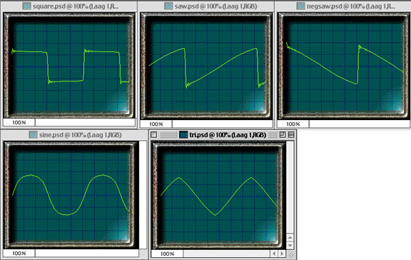

PostPosted: Fri Nov 26, 2004 4:19 am    Post subject: the oscilators Reply with quote  Mark this post and the followings unread
osciloscoop
(square wave's pulsewidth is set to 52 instead of default to produce more accurate squarewaveform)
grafic display of the basic waveforms of the a6
 Filesize:  93.91 KB
 Viewed:  19753 Time(s)
