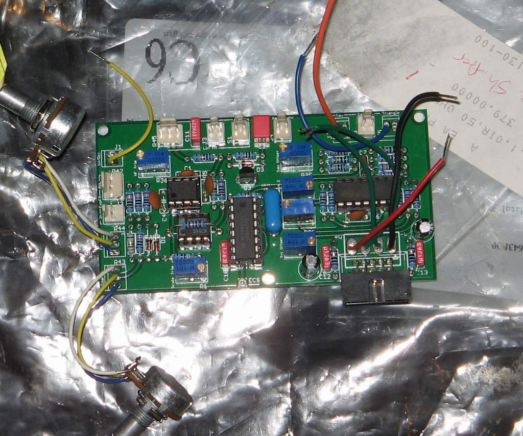

scott, did you yet try the low offset LT1013 together with the matched pairs from my proto for the expo? any difference? _________________

back then i made myself a PCB for the VCO core, using LT1013 and LM394, however i have had access to TI 4046 only, so i could not get it scaled anyways. i just ordered a couple of ON Semi 4046's to resurrect this project.
as said before, i had only the bad TI IC's on hand. nevertheless i still remember the moment when i powered up the VCO and played for about half an hour only with the hardsync  _________________
Tech Buddy at Random*Source |

And the sync I recorded came from the attached picture: that's Fonik's PCB there. It has everything but the Sine output, I believe. I just hard wired coarse and fine tune pots, though you can see he put headers in for the panel connections, and Doepfer/MOTM type power connections.
Tom actually started the X-4046 last year, but, at the time I was using the HCF4046, which I couldn't get going all that well. We dragged Matthias into the project to get a third eye and (IIRC) he had the same type 4046 I had(?). Anyway, during that time Fonik graciously designed and produced a PCB in what seems like no time flat. By the time we got back to brass tacks, the summer was over and Studs disappeared back into the vortex of Academia.
Matthias: Last year while trying to figure things out, I replaced the LT with a TL. I never went back to the LT so I couldn't say how well it works.
If I were to market PCBs for the VCO as a tuned VCO module, I'd almost want to supply a tested 4046 with it; I can see someone getting the PCB and plopping in a TI or HCF and starting a chain of support messages to you. But, that's just me.

scott, it's great to see the boards was of use for you.
| Danno Gee Ray wrote: | | If either of you decided to market a PCB with an accompanyaing tested chip I would buy the set. |
i won't. i think magic smoke would be the right place for such a PCB/IC set!? _________________
