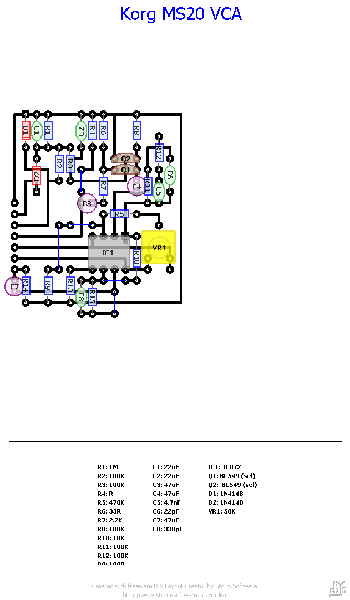

I made a layout for the VCA using Marjan's drawing; I'll post it here if anyone wants to test it. Ill probably layout the LFO also, but I think the HADSR might be a little beyond my abilities. |
brother303
Joined: Nov 02, 2010 Posts: 139 Location: ruhr-area/germany
Posted: Mon Mar 21, 2011 4:09 am Post subject:
ericcoleridge wrote: | I made a layout for the VCA using Marjan's drawing; I'll post it here if anyone wants to test it. Ill probably layout the LFO also... |
Good one! I´d like to test the vca-layout,

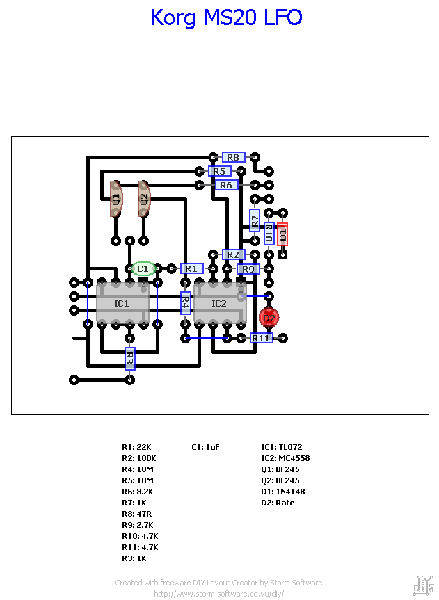

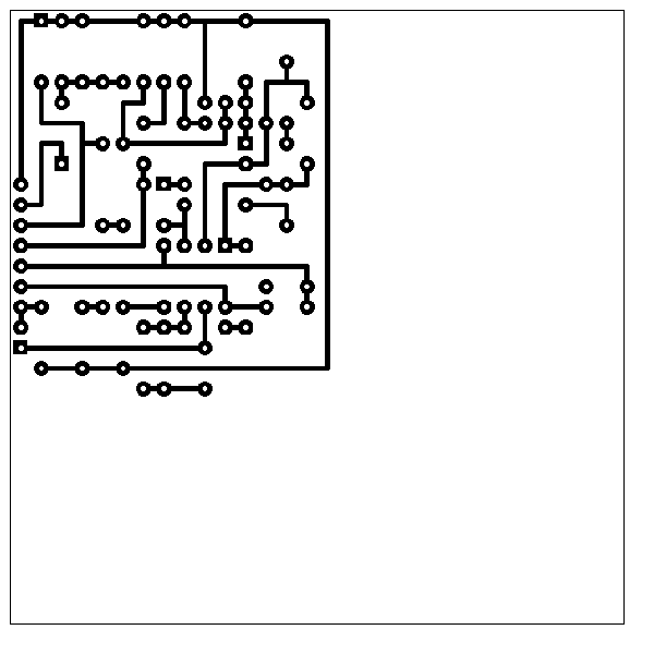

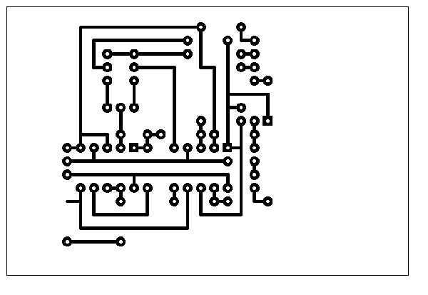

Posted: Mon Mar 21, 2011 1:59 pm Post subject:
This is probably not the best place to post these, but, being that they are related, I'll go ahead for now.
These are layouts for the MS20 VCA and LFO, both untested as of 3/21/11. I was pretty careful laying out the VCA, less so with the LFO; But both are very simple and if anythings wrong, shouldn't take much to get them working. The VCA calls for matched BC549s, but I don't know how critical this is.
I used a freeware program called DIY Layout Creator, which is a little buggy. The layouts will need to be re-sized before printing to PnP, and I think they may also need to be reversed.

ericcoleridge wrote: | This is probably not the best place to post these, but, being that they are related, I'll go ahead for now. |
Thanks lot for posting this here.
The vca looks easy enough,I´ll try to put it on a piece of stripboard.

I have attached the version of the ms20 vca that I simulated. There are a couple of notes on there, for setting line level and synth level outputs. I also added a gain trim pot, as the verson you linked to seemed to output a slightly lower signal level. Also I removed the bias trim, as I couldnt see much reason for it in the circuit. Does anyone know why it was included?
As for the question of puting the ring mod on the vco board, as it stands the vco is realy nicely layed out and everything fits great. If I were to put it on the board, it would either become a very long board, or become a routing nightmare. I quite like the fact that its a very small vco board right now (4.30"x1.50"). The ring mod board is (2"x1") on its own. The ring mod, could have 3 sockets mounted on it, and just attach directly to the face plate, no problem. You could then also use it with other modules.
Im about to finaly sit down and check the vco to make sure its routed correctly. I got a little sidetracked with some tube circuits

Pantheon wrote: | I have attached the version of the ms20 vca that I simulated... |
Thanks mate. I´m going to check it on a stripboard over the weekend. (....thank god it`s friday! )

R12 on your vca-schematics is really 1000K?!?

brother303 wrote: | Hi Pantheon,
Not 10K???
Greg |
Ah yes its a 1M resistor, but it realy isnt that important, 47k or something might be more resonable It was just to tie that end of the cap to ground.
I hope it works for you, let us know your results!
I finished checking my board layout, and after a couple of tweaks everything looks good and checks out ok So when the printers are open on monday, i'll get this printed and etched. Once i'm happy that its working correctly, i'll post up the final layout, schematic, parts placement, etc.

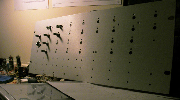

I also started machining a front pannel for this MutantMS20 clone (a partial clone realy), it should all fit on a 4U 19" Rack pannel, there is a pic of the partialy machined front pannel attached. Sorry for the crap quality, my camera is lame in dim light.
Does anyone have any good tips on how to apply text to a face plate?
I have tought about toner transfering it on, then sealing it with some spray. My dad suggested silk screening, but I dont have any idea how its actualy done.
