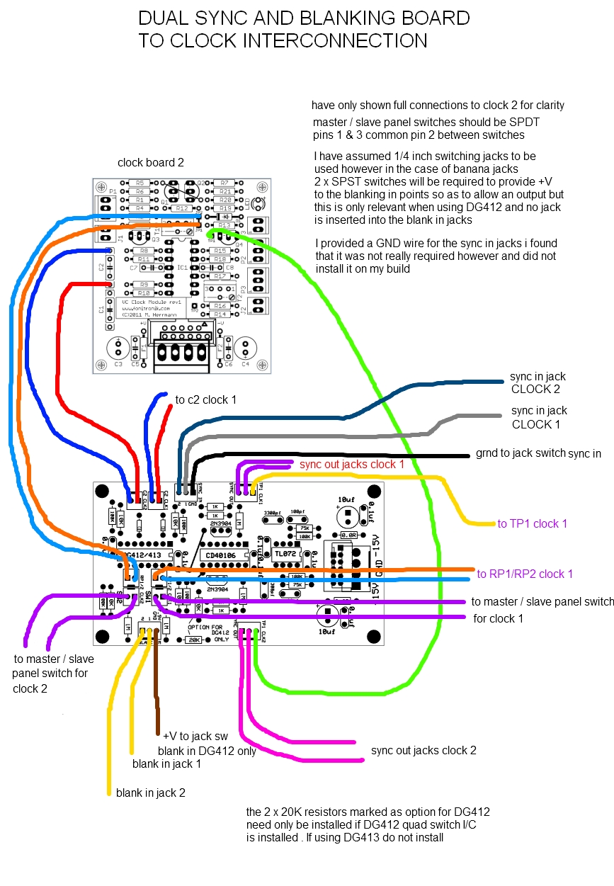

PostPosted: Wed May 18, 2011 8:44 pm    Post subject: Reply with quote  Mark this post and the followings unread
Please make the files and a little wiring instructions available for us home-brewers
It all seems to be working acceptably now and i have tested it every which way i can without any magic smoke Shocked coming out , so
i think this is about as ready as its getting. therefore here you go Very Happy
hope the doc's are up to scratch but if anyone has any queries or any probs just let me know here and I will help to the best of my limited abilities
cheers
 Filesize:  173.45 KB
 Viewed:  28200 Time(s)
 Filesize:  523.5 KB
 Viewed:  28201 Time(s)

I made an extra dual sync board beyond my requirements during my testing. it is the one with coloured straps in the photo
and is up for grabs Shocked
comes fully populated except for the DG chip.
it has been tested .
first come first served please PM me if you want it

just a bit of clarification on the master/slave panel switches
with this board they probably shouldn't be called master and slave
at all in this case as they just do rather odd things
as you start to work out how this cct board interacts with 2 clock boards
with different switch settings, different patches and different pot settings
both clocks can at times be master or slave or neither or something else
inbetween
I have some idea's using DPDT center off switches but
to be honest it's doing my head in trying to work it all out and in the end
i am not sure that its actually worth the effort for an addition that is not that usefull any longer
so i think i will just refer to the switches as Dave and the other Daves for now on my quad build. they can be interesting to flick on occasionally but
I probably won't include them on any more of my builds . so if someone comes up with a master/slave solution thats works correctly please post it here for any others that may want it
