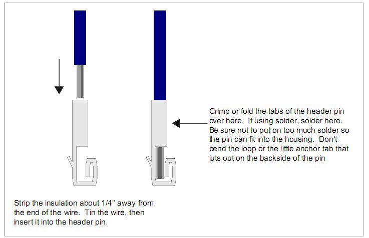

Attaching the Pins to the Wires
The header pins attach to the ends of the wires, and are then inserted into the housing. The pins
have a couple of tabs at the top that are intended to be crimped, or folded over the insulation of
the wire. The end of the wire is stripped and tinned, about ¼” from the end of the wire.
This stripped and tinned part is to extend down so the “loop” of the header pin compresses down onto
the bare wire when the wire and pin are inserted into the housing.
Crimping tools can be expensive, though fairly inexpensive types that resemble a pair of wire
cutters are available. In lieu of a crimping tool, many people will fold the tabs over the bare wire
and put a small amount of solder there to hold it in place (a large “blob” of solder may prevent the
header pin from fitting into the housing). Generally, during the SN Voice build process, it was
found that the small amount of solder made a much more reliable connection.

Once you’ve got the terminal pins attached to your wires, you can insert them into the housings.
When you insert the pins into the housing, make sure that little barb on the back of the pin is
oriented towards the side of the housing that has the small “window” in it – the barb is designed
to “catch” in that window like a hook in the mouth of a fish, and make it harder to yank it out at a
later date. When the pins are inserted into the housings, there should be the sensation of a soft
“click” – this is a good sign that you’ve done a good job getting the pins on the ends of the wires.
Figure 12 Inserting Pins Into the Housing
Remember that “loop” on the pin must not be crushed or misshapen – it is intended to compress
down over the wire, making a good connection, and also provides a certain amount of tension that
helps hold the pin in the housing. And, again, too much solder (if you put solder on) or solder in
the wrong place can inhibit the actual installation of the pin into the housing."[img][/img]

You will have to cut each pin from the Bandolier in order to use them.
The end that is cut off the runner is the end where the wire goes.
Hope this helps.
 Filename:  Figure 11 Pins Orientation Before Insertion Into the Housing.bmp
 Filesize:  877.4 KB
 Downloaded:  300 Time(s)
 Filename:  Figure 12 Inserting Pins Into the Housing.bmp
 Filesize:  922.74 KB
 Downloaded:  247 Time(s)

The quad bass ++ docs are available to download in this thread http://electro-music.com/forum/topic-39402.html and include a long description of making ribbon cables.
The whole crimped pins thing is an absolute pain the first time you do it. I went through what you're going through now two or three months ago. Eventually it all becomes clear. It's still very fiddly but you will master it.
Having got the quad bass ++ together I'm bracing myself for the Klee!
Hope you get your ribbon cables together okay. They are quite satisfying once you get the hang of them. I seem to remember there was a discussion somewhere where someone was just buying them ready-made pretty cheaply and was asking why anyone would go through the pain of building them. I guess it builds moral fibre or something Smile

I have taken excerpts from Stae Machine's most excellent instructions for the Quad Bass ++ and edited them to apply to the SN-Voice. As Bill is always ready to help the DIY community, I hope I have not crossed a line by doing this. If this is considered a breach, please MODS correct me as is required.
Oh no problem Danno Wink I did my best in providing the best documentation I could for the QB ++. I want to credit Scott Stites for allowing me to use his excellent illustrations from the Klee documentation on how to crimp and insert these terminals into these 'KK" style housings.
