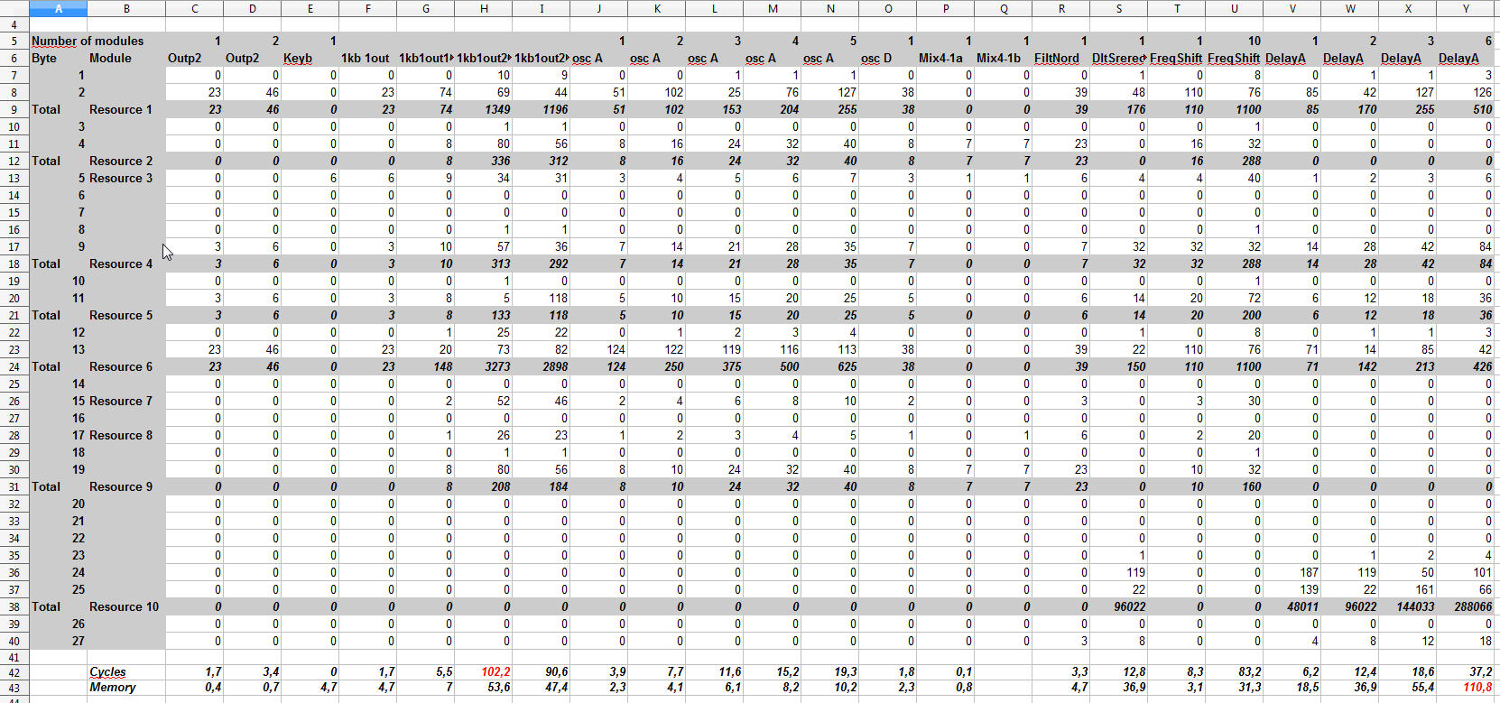

Ok, so here is tonight's little puzzle:
I've made a screenshot of the logfile after adding a single 2-Out module.
The first message you see is the message for adding a module. It has message ID $29, the fourth byte.
Then there is a reply from the G2, in my opion it's a sort of Ok message (adding module succeeded)
Then there follow 4 additional reply messages from the G2 with ID $72. These are the "resources used" messages for 4 slots. Each message is in two parts, the first is for the VA section and the second for the FX section.
So I added the 2-Out in slot B in the VA section. The resources used message for this section contains 27 bytes.
The second screenshot is an excel containing the results of a number of test configurations. The 27 bytes for each test is a column. At the bottom I added the "Cycles" and "Memory" as shown in the original editor.
So the first column is one 2-Out module, the second is two 2-Out modules, the third is 1 Keyb module, and so on.
Then I figured some bytes should be taken together as representing one resource. For example byte 1 and 2. These are the gray Total rows.
The question is how to calculate the Cycles and Memory values from the 27 bytes.
Here are some idea's I have:
- Resource10 represents delay memory
- The keyb module doesn't use processor cycles, so Resource 3 represents some kind of memory usage.
- The 2-Out module in column one, resource 1 and 4 seem to be mirrored in resource 5 and 6.
- Compared with Mix4-1a, which has mainly inputs in stead of outputs, resource 2 is mirrored in resource 9.
Who is able to shed some light on this ???

varice
Joined: Dec 29, 2004
Posts: 961
Audio files: 29
G2 patch files: 54
PostPosted: Thu Feb 07, 2013 3:34 pm    Post subject: Reply with quote  Mark this post and the followings unread
There are at least two different types of memory usage, one is Zero Page memory (e. g. for the storage of output values of each module in a patch), and RAM used for long digital signal delays and other FX.
Since you can run out of either memory resource before the other, the Editor apparently compares the usage of each type and displays the greatest usage value of either type.

PostPosted: Fri Feb 08, 2013 12:36 am    Post subject: Reply with quote  Mark this post and the followings unread
Ok, thanks.
So resource 3 could represent zero page memory, since the Keyb module has no cycles and no delay mem. It also has exactly 6 outputs as the number shows.
2-Out has no ouputs, so that fits also.
Mixer modules and delay show a 1, that fits also.
But the OscA's show a 3 for 1xOsc, a 4 for 2xOsc, a 5 for 3xOsc... Why would they use more zero page mem?
I suppose you don't need memory for inputs, it just reads the output memory of the connected modules.

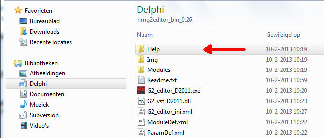

brunov
Joined: Aug 03, 2011
Posts: 227
Location: delft
PostPosted: Sat Feb 09, 2013 9:38 am    Post subject: Reply with quote  Mark this post and the followings unread
That is the text I've put in as a default, but as soon as the editor connects it should replace it with something like this:
Initializing connection.
Started as server.
g2udev handle = 0000
Starting server tcp-ip thread.
initializing usb.
USB Get endpoints
g2iin = 129, g2bin = 130, g2bout = 3
Opening USB Device
LibUSB-win32 driver version : 1.2.6.0
Set USB Configuration
Claim USB Interface
g2udev handle = A98E38
starting message threads.
Does it connect with the g2? How dit installing the libusb filter driver go?

PostPosted: Sun Feb 10, 2013 1:37 am    Post subject: Reply with quote  Mark this post and the followings unread
Sven,
I hope you followed the install instructions for the libusb carefully, because it is very important that you install the libusb driver as a Filter driver on top of the existing clavia driver, NOT as a device driver.
If you install it as a device driver the libusb replaces the clavia driver, so the original editor doesn't work anymore. You should uninstall the libsub device driver then, or, if that doesn't work do a windows restore.
If you did install it as a filter driver, then you must realize that the two editors cannot run simultaneously. Or that the communication goes out of sync after you used one or the other. In that case you only have to reset the g2.
The filter driver mode of libusb is really a testing/debugging tool, it sits on top of the clavia driver. It's necessary for the os editor because I haven't found a way to access the clavia driver directly.
Hope this helps, please read the help for installing libusb carefully.
Let me know how things go!

brunov wrote:
Sven,
I
what help file?
brunov
Posts: 227
Location: delft
PostPosted: Sun Feb 10, 2013 5:42 am    Post subject: Reply with quote  Mark this post and the followings unread
It's in the install dir, or else you can read it here:
http://www.bverhue.nl/G2EditorHelp/NMG2_Open_source_editor_help.html

PostPosted: Sun Feb 10, 2013 6:33 pm    Post subject: Reply with quote  Mark this post and the followings unread
ok.. i gave up on the original editor for the moment. i only get it working by ovrwriting the g2 driver :-/ the log window needed to get enabled in the application settings.
i collected some data to see which data bytes give the dsp usage values but while it is possible to see areas that corelate with the mem and cycles settings the numerical value decoding is quiete hard..
maybe somebody has an idea what counting method is used here? or likes to add data?
i broke down the data package of 64 words in a 16 word strings that gets send after a patch modification to 2 strings..
each containig 27 words ..
same usage values in VA and FX area result in identical strings and word 23-25 give the delay memory use.. no othe insights yet..
i post my 2 lists..as start point for others to continue the puzzle
