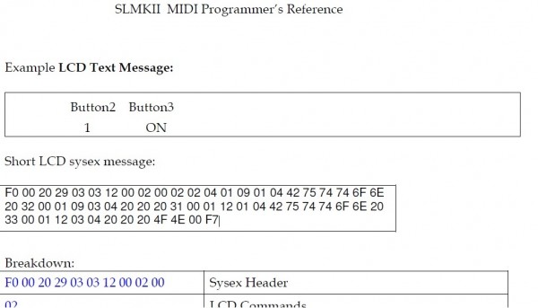

In case you are around > I have been using an engine for a few weeks and I must say that this editor brings the engine to life. Thanks again! But I have a question. Is that possible to edit the NMG2 editor tool to control editor ui elements with MIDI to select G2 synth when using more than 1 G2 hardware? I tried to edit the G2_editor_ini.xml file. I added a line to the CTRL_MIDI_ASSIGNMENT_LIST section. Something like:
| Code: | | <CTRL_MIDI_ASSGNMENT CC="24"... ControlPatch="frmG2main.SelectG2" ControlIndex="1"... |
But I realised that this .xml file is only used to update the Editor UI midi mapping box on the NMG2 editor. Then this file is rewrite with previous setting when the editor is closed. Is that possible to add this feature by editing something with the compiled code or do we need to make a change before compiling the code in "UnitMidiMapping.pas" or another file? I would love to add this feature when using multiple G2 engines.
Another topic: Names of the parameters assigned to G2 display for the parameter pages. I want to do something similar to what wav (and other users) mentioned before on this topic : mimic G2 display and pots, but in my case with a Novation SL mk2. So my goal is to collect controllers names (with OSC or whatever) from the parameter pages box and display them on the Novation SL mk2 LCD screen. I found a documentation with useful info to change text on screen and encoder values in real time with sysex for the Novation control surface (image attached).
For the moment I use a tablet and I display the 'parameter pages' box behind the encoders of the Novation, it is already good. But I would prefer to display the names of the parameters when I change the pages (A, B, C, D, E, 1,2,3,) in real time on the Novation screen. Here is a video with a Novation and a tablet :
https://youtu.be/nial2LmW-RM
I tried another approach at the start to display the parameter name on the Novation with automap mode using the G2 vst and HUI protocol in Cubase. The 120 parameters (8 * 5 * 3) which correspond to the 'parameter pages' encoders are all visible in Cubase but the names are generic. This is normal after all because the parameters assigned on the 'paramater pages' are not native, they are customizable, so it doesn't work with the HUI protocol.
