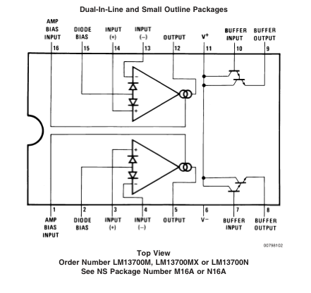

Excuse me but what exactly is the triangle on sheet 2 with pins 9 and 10???
Its right between the two R26's
PostPosted: Mon Mar 17, 2014 10:10 pm    Post subject: Reply with quote  Mark this post and the followings unread
The LM13700 has a darlington buffer in it.
Here's the view on the datasheet...

acidblue
Joined: Jun 26, 2009
Posts: 226
Location: The Darkside
PostPosted: Tue Mar 18, 2014 9:12 am    Post subject: Reply with quote  Mark this post and the followings unread
I did not know that, thank you
