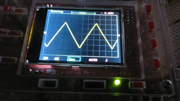

PostPosted: Thu Dec 18, 2014 5:27 pm    Post subject: Reply with quote  Mark this post and the followings unread
good evening everyone !
finally manage to get some sound after 4 days of testing, tweaking, and brain storming !
but there still some curious stuff ! i get kind of saw in the triangle out and kind of triangle in the saw out my square is way louder than every other waveforms and my oddest of all : i'm using my arturia microbrute pitch out to calibrate my 1V/oct response but i've got two problems my bandwidth goes from around 2k to 4/5kHz and then it goes down again to 2kHz, if i try to go up in frequency i got a bit of his then noting and if try to go below 2k i have hiss and pops before to get nothing
someone got an idea ? i tried to tweak de two trim pots HF and 1v/oct but the bandwidth stay the same may it be the timing cap ?
PostPosted: Thu Dec 18, 2014 6:26 pm    Post subject: Reply with quote  Mark this post and the followings unread
Did you start with the HF trim at its max setting (I think that's the correct end of the scale).
wackelpeter
Joined: May 05, 2013
Posts: 461
Location: germany
Audio files: 10
PostPosted: Fri Dec 19, 2014 3:56 pm    Post subject: Reply with quote  Mark this post and the followings unread
my VCO goes from very low (much less than 1Hz) an goes way above audible range... more than 20kHz...
You should start with the HF-Trimmer as suggested...
the Output of the square and saw is always louder as the sine and triangle with the same Output voltage... means 5vPP square is louder than 5vPP sine Signal...
you can adjust that mostly by changing the resistors between gnd and Output... for triangle R10 sine is R25 pulse is R8 for saw Change R33 in the Feedback path of IC4B...
if your sine Signal is to small you can follow the mods explained a few Posts/sites before...
for myself i adjusted the Levels of all Outputs to 5Vpp... which means sine and tri are a bit quieter but when i want to use more than 1 Signal i can adjust them via a mixing module (easy and effective Ken Stones DC Mixers)
when you wish to get the same volume on all signals with pulse being 5-6Vpp you have to raise tri and sine up to 10Vpp to have them at the same Level for yours ears and the "Feeling" they are equivalent... but as i do often use my signals with some of my "regular" analog stuff and it's capacities mostly can handle only 5Vpp signals i choosed to Keep them all at 5Vpp...
when your ramp isn't correct i would suggest to look after R19&R20 and surely the trimmer R37...

i would focus on the PWM/Ptch issue first.

the noise disappears when i physically touch ground. For instance,it clears up when i touch any grounded resistor leg
