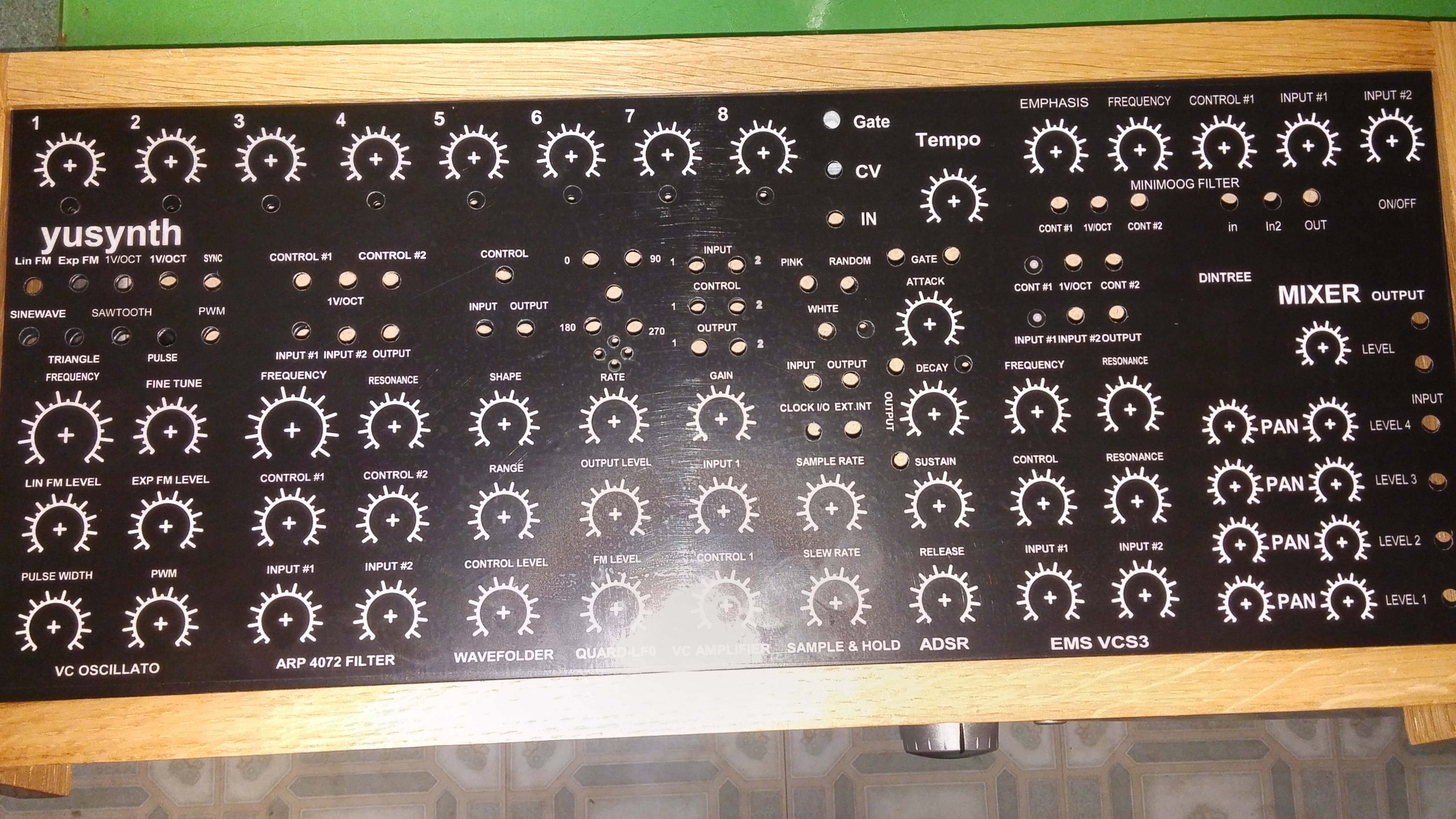

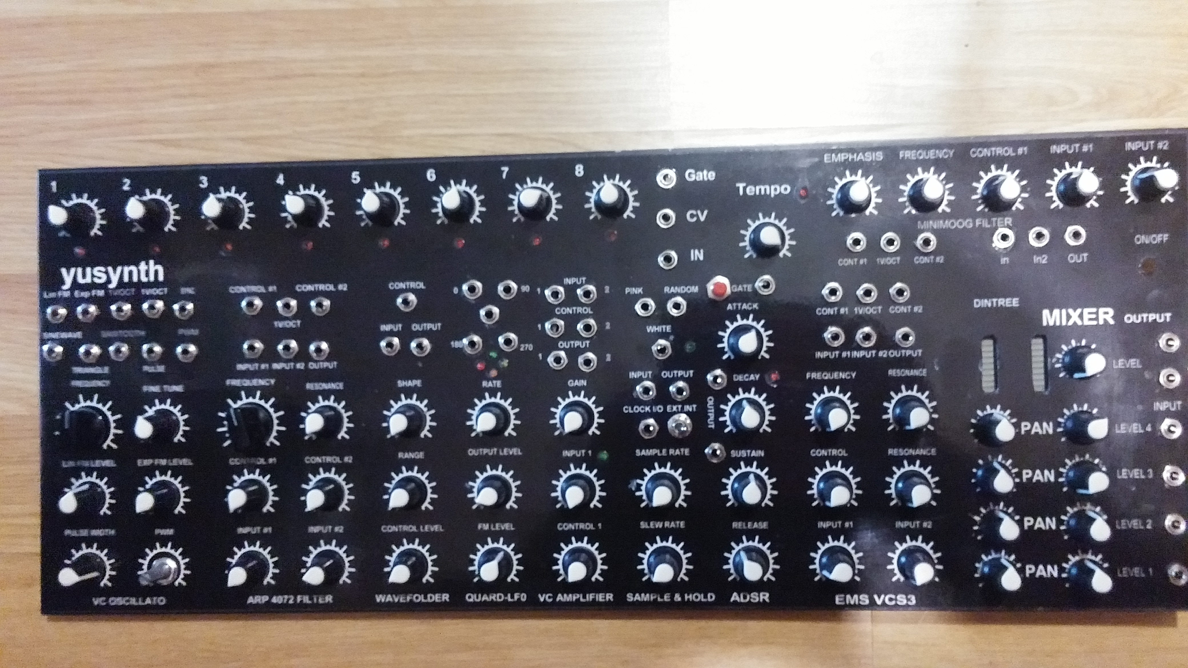

I decided to make my Yusynth smaller but decided to make a smaller as a desktop synth I also adding a mixer and a 8 step sequencer boards are almost made but lots to wire up should be a few months
