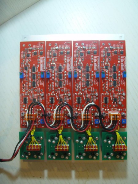

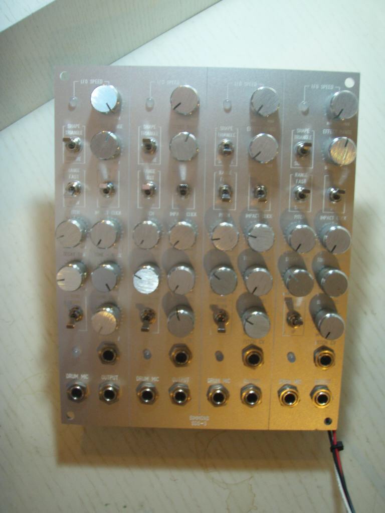

PostPosted: Tue Jul 15, 2014 8:37 am    Post subject: SDS-3 clone in 5U Reply with quote  Mark this post and the followings unread
SDS-3 clone PCBs from xpmtl
SOCK4 PCBs from Oakley
panel from FPE natural finish with white infill.
brushed aluminium knobs from altronics
White LEDs

That's a nice looking panel DickyKnee Shocked
are you going to make a whole synth like that ?
(would probably look great in a white case)

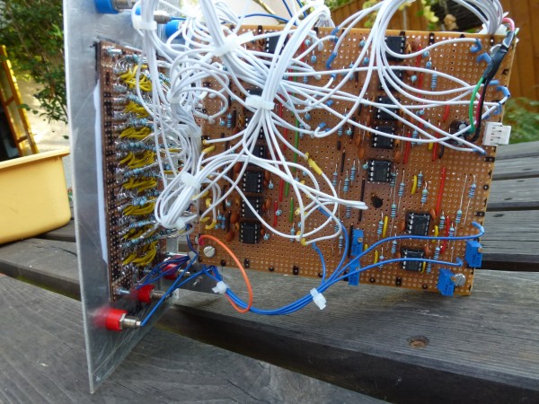

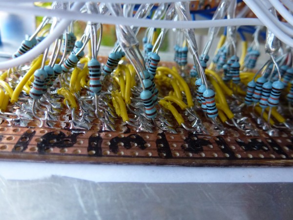

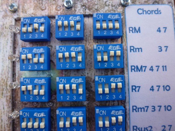

Latest addition: a module I've called Second String. Basically an 8 step sequencer with three separate outputs, each step of which is independently controllable to put out between 0 and 16 semi-tones of CV. Intended to allow chords to be built using 3 or 4 VCOs (one to supply the root note, either 2 or 3 for the notes of the chords). Alternatively, one output can control a separate VCO, eg as a bass, in the attached sample.
Rats nest of wiring as you can see. And as for the panel - that's 24 4-way DIP switches, and 96 resistors!

That's a pretty neat idea! Cool Cool
I'm frightened to ask how long wiring it up must have taken, though Shocked
A fair few hours Smile
Actually, debugging was the worst part. All those resistors and wires soldered to a small piece of stripboard = plenty of opportunity for shorts. Also, I had some msyterious errors in voltages which I finally tracked down to the residue from the no-clean solder, forming a resistance in parallel with my supposedly matched 100k's.

Three... my ghetto diy case has now run out of room
