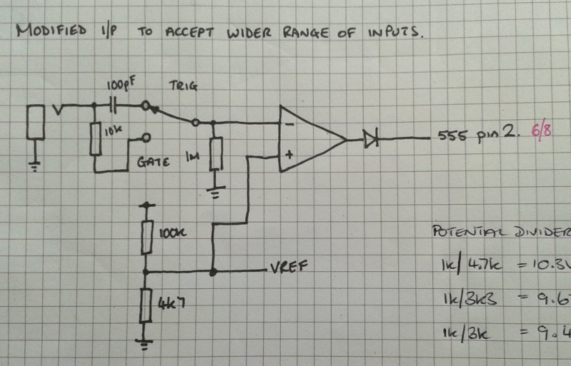

Tried this out this morning as I have a day off work and this envelope works beautifully.
Have replaced the input with a comparator which gives it the ability to work with a gate signal or extract a trigger signal from a gate.
Excuse my drawing!

The comparator add-on is unneeded; the original circuit will work directly with a gate input. The cap and transistor already differentiate whatever is applied, gate or trigger.

PostPosted: Fri Mar 07, 2014 10:07 am    Post subject: Reply with quote  Mark this post and the followings unread
Thomas_Henry wrote:
Thanks for the comments.
Quite right, I wasn't trying to find fault with your design, I'm not in your league knowledge wise.
The reason I added the comparator was for a couple of reasons. The main reason was so I could trigger it with samples of trigger pulses from my Akai MPC as well as from my modular. Hence the low threshold voltage on the comparator.
The other was so I could feed it a gate signal and either use it as an AR envelope where the envelope stays high (once the attack reaches maximum) for as long as the gate lasts. When selecting the input through the original capacitor it stays as a AD envelope regardless of gate length.
Could I have achieved this simply by putting a bypass switch on the 100pF capacitor? As I trigger from my MPC manually the velocity and hence the level of the trigger pulses vary and I wanted to account for this.

Hey Mcop,
Try this. Just wire a SPST switch across the input cap. When closed, the unit becomes an AR envelope generator, when open it is an AD type. I find I can fire it either way with a gate or trigger whose amplitude is at least 1.8V.
I'll add the switch in the next draft. Thanks for suggesting it.

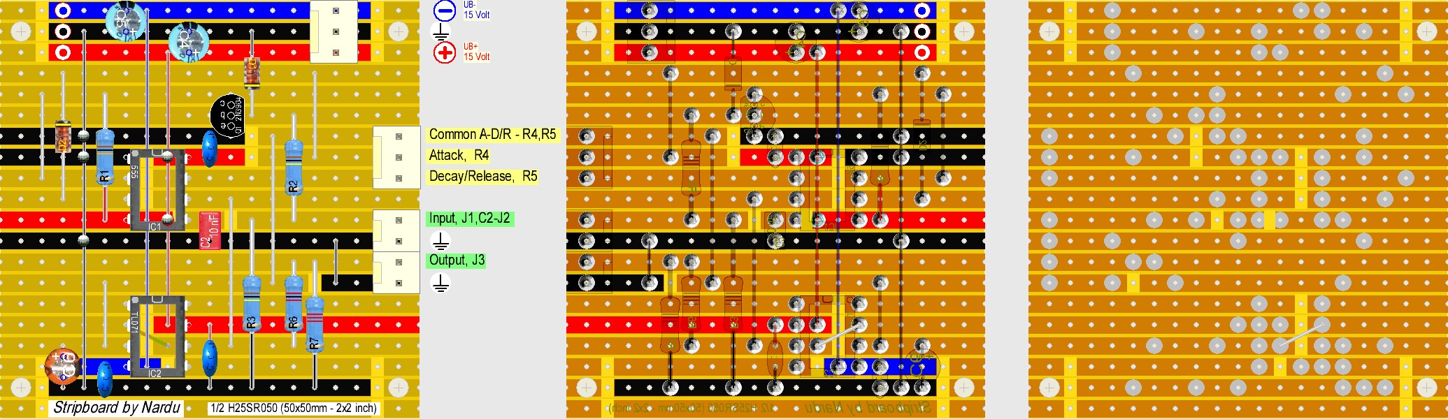

PostPosted: Wed Mar 12, 2014 2:23 pm    Post subject: Easy AD Envelope Generator - Stripboard layout in Lochmaster Reply with quote  Mark this post and the followings unread
With Thomas Henry's permission, a stripboard layout.

PostPosted: Wed Mar 12, 2014 7:22 pm    Post subject: Reply with quote  Mark this post and the followings unread
wackelpeter wrote:
Hi Thomas,
thanks for your reply... still had built this circuit on stripboard, but only got the same signal on output which i fed to the input... that was the reason why i wasn't sure... and now checking my stripboard again with an magnifiying glass i found a strip not drilled correctly which shorted the input after the condensator with the output... well that's stupidity at work so please don't laugh at me.. it's the usual thing that i oversee the simple mistakes i made... don't wanted to show that i'm an idiot what i now have to admit Smile
We all have done it; the only laughter will be the one of recognition and being glad you've found it Very Happy

If there are runs of boards happening people normally start threads to see what interest there is both here and at muffwigler.com. Fonik in particular has done some excellent boards for some of Thomas' other designs.
