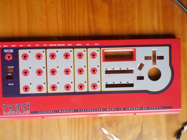

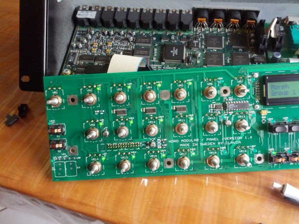

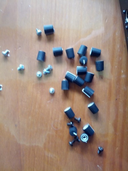

So in the end, I open the Nord modular G1 Rack.
Very easy to open, check the pictures below.
For you to remember my issue Smile

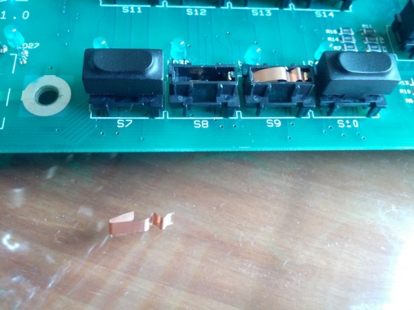

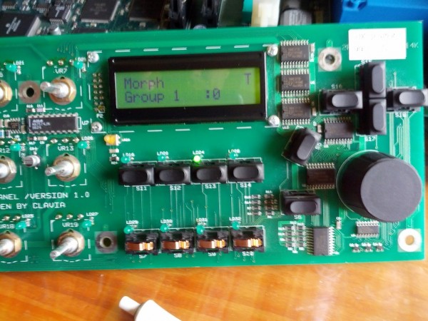

I had a problem with one of the NM1 button that didnot seem to work when I was pressing it : Sometimes the button (B) worked, someother times it did not!
So I open the NM1, I took off the caps of the 4 buttons (A,B,C,D) and change the metal inside it. To replace them I took the same metal from another button (find button) that I don't use much.
Since I did swap those two buttons, the NM1 is working fine !!!! no more issue on the second button B Smile and the 'find' button is .. OK ... not much Smile
It was also very easy to took back everything together, I took the time to remove the dash, etc Smile
Kind regards to all Smile

the faulty metal that I replace !!!
