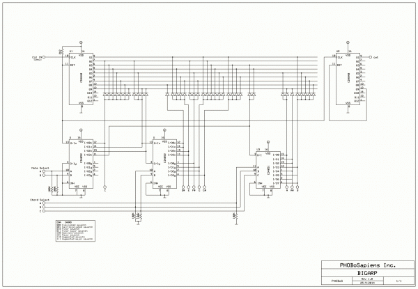

PostPosted: Sat Sep 27, 2014 12:58 pm    Post subject: BIGARP Reply with quote  Mark this post and the followings unread
Here's one I drew up that can step through 8 different chords using the 9 bit divisions.
 Filesize:  86.14 KB
 Viewed:  915 Time(s)

I haven't tested this but it should play the 5-note sequence from Close Encounters of the Third Kind.
Add a LM386 and a speaker and you could use it as a doorbell. Wink
"The Close Encounter" schematic (untested)
 Filesize:  57.43 KB
 Viewed:  710 Time(s)

PHOBoS, did you look at the possibility of using a 4059 divide-by-n counter to do the same? Use a mux to programme the jam inputs, or even use 12 (or 13) 4059s for polyphony. I am still getting my head around the datasheet for this chip, but should work.
Posts: 5609
Audio files: 705
PostPosted: Sat Oct 25, 2014 4:07 am    Post subject: Reply with quote  Mark this post and the followings unread
Thought about it but haven't really looked into it. Though it looks like it's not just a matter of making some pins high/low
to set the division, but there is some feedback involved aswell. So switching between the notes might not be very easy
and require a networks of logic gates. It should work pretty well for polyphonic use, although I'm not sure if it
would be much easier then using a bunch of 4040's. hmm it would be nice if there's a chip with several /2 counters. scratch

PostPosted: Sat Oct 25, 2014 4:37 am    Post subject: Reply with quote  Mark this post and the followings unread
Looked for this as well. The quad FF chips I know all have a common clock. But you could use a dual FF chip like the 4013 and connect NOTQ to D, which gives you two toggle-FF per chip.
Posts: 5609
Audio files: 705
PostPosted: Sat Oct 25, 2014 5:13 am    Post subject: Reply with quote  Mark this post and the followings unread
yep. common CLK seems to be the problem,. I was looking at the 74LS377 which has 8 flip flops but also has a common CLK.
(and besides that no inverted output which it would need to work as a divider)

What about using a 4007 to build several latching transistor pairs? They have 3 N/P pairs, so you should be able to make 3 divide by 2 circuits on one chip.
