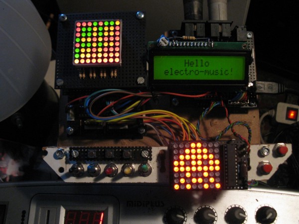

Here's the result of a very simple implementation that simply converts the number of live cells to a note. Not the most interesting thing
to do with it but it gave me some nice music combined with a lightshow. (I am thinking of adding a kaleidoscope mode). I also added
some extra repeating notes. All sounds come from the Proteus 2000 (thanks bob Very Happy)
That was a great result!

I added a cursor and a drawing mode with X/Y controlled by MIDI CC knobs (easier to test right now as those are built into the keyboard)
a)when no X or Y is connected the step input will move column first row next to scan over all the cells, the reverse input works too then to reverse the direction.
check. I also have a mode that does the same thing but skips dead cells. At the moment it has to check all the cells untill it finds a live one
so I limited the max amount to 64 in case it's all is dead. Because of this it does sometimes not find a cell even though there are live ones.
(I think I could fix this with another array but it's not really a problem)
b)when X or Y is connected step will grab the X and Y values to control the cursor (readout) position, reverse does nothing.
ah, I haven't added a synchronous mode. So step acts like a sample and hold for the X/Y values ?
c)when step is not connected the X and Y input control the cursor asynchroneously and reverse does nothing.
yeah, I can do that too now with the knobs, not very usefull yet since it isn't automated though. However when it is running I can force it
to step from another position which is fun to play with.

I have that working and also implemented a random setting for it. I noticed that it also works very nice when it is used to draw cells,
especially when set to random. Up untill recently the 'cursor' (used for drawing) was just the position of the sequencer, so I could
switch between drawing or sequencing. I did want to add a seperate cursor to be able to draw and sequence at the same time but that
makes it a bit difficult to see what is going on on the LED matrix display. I was already using PWM to make the sequencer position brighter
than the other LEDs but this didn't work too well, probably because the chip I use to drive the display has its own refresh rate and already
uses PWM to set the overall brightness.
So, time for a bit of an upgrade Cool
Instead of using a single color matrix display I now use a Red/Green one (which can also do yellow). It needs a bit more hardware
to work (currently using 3 shiftregisters + 8 transistors) and is bit harder to control than the driver chip I was using (MAX7219), but
with the help of a timer interrupt it was actually not that hard. I haven't added any PWM (yet) for variation in brightness but it might
look nice to vary brightness depening on cell age (=number of generations the cell has been alive). That would also needs a lot more
code though so I am probably not going to do that. (have fun with that jan Wink)
I also added more buttons but I need some more knobs aswell. Maybe I'll add a menu since I have an LCD now, so the knob function
depends on the menu setting. I can't turn them all at the same time anyway.
And I added a small change to the auto scale function. It wasn't really a bug but when the length of the scale was set larger than the
number of notes that had been played there would be empty spots in the scale. For example if the length was set to 4 and only keys for
C, D and E had been pressed the resulting scale would be C D E - C D E -. Now it first checks how many notes are available and adjusts
the length if there aren't enough. So with the previous example the scale is now: C D E C D E C D. So the scale length setting now only
adjusts the maximum number of notes used.

Posts: 24422
Audio files: 297
PostPosted: Sat May 25, 2019 8:32 am    Post subject: Reply with quote  Mark this post and the followings unread
Nah .. age discrimination Exclamation Laughing [*] also I'm done for now with Life .. erm the "Conway game of" variant of it ... I may go back to it, but for now its a module that can do some nice things in patch.
Working on tunings now .. got all possible equal divisions of arbitrary sized octaves done now .. but would like to implement tuning tables too (Scala like) .. this weekend maybe .. already have a lot of stuff for this in the form of a dedicated module, but not sure I understand it properly all.
[*] actually it does not fit in well with the current patch format which uses ASCII strings to represent a grid state with spaces an X-es .. and that code is all over the place.

Then the lots of LEDs thingie in the gif .. it's only a small image on my screen .. so I gues 64k of LEDs nowadays is not that much really :p
OLED ? that's cheating! Laughing I want 5mm RGB LED's! well I would allow a LED matrix.
ideas .. hmm .. four bits free to be used .. with linear predictive coding legacy audio could be possible .. or speech ... I had another idea .. but then I forgot .. my chocolate orange cocos icecream needed stirring Shocked
I could do something by turning it into a voltage and use a single connection between all the cells to mix those voltages together but nah,.
not going to make music with this. Although if each cell (or group of 4) had a small speaker it might be fun. At the moment I am testing with an arduino
(which is also used to program the EPROMS) and the color thing seems to work nice. Too bad I can't use my testboard right now which has an 8x8 R/G
LED matrix so I could see how it looks, Maybe something to try in the future.
