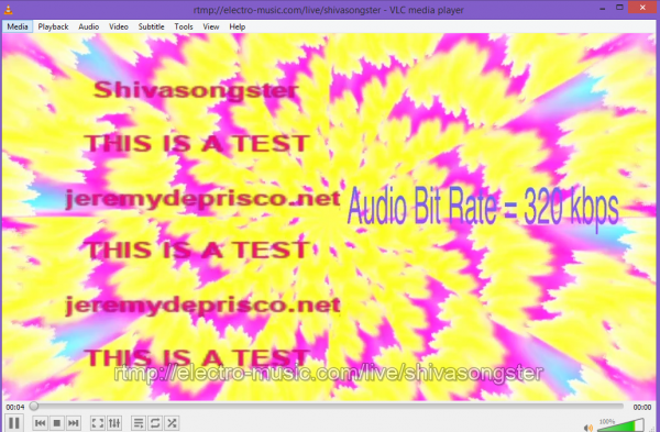

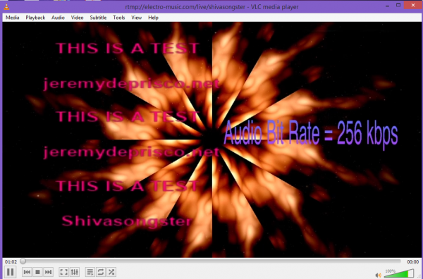

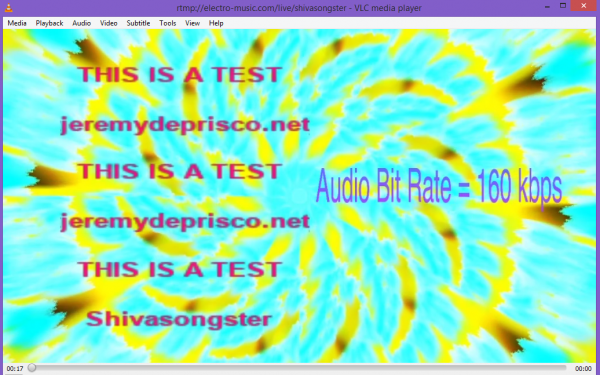

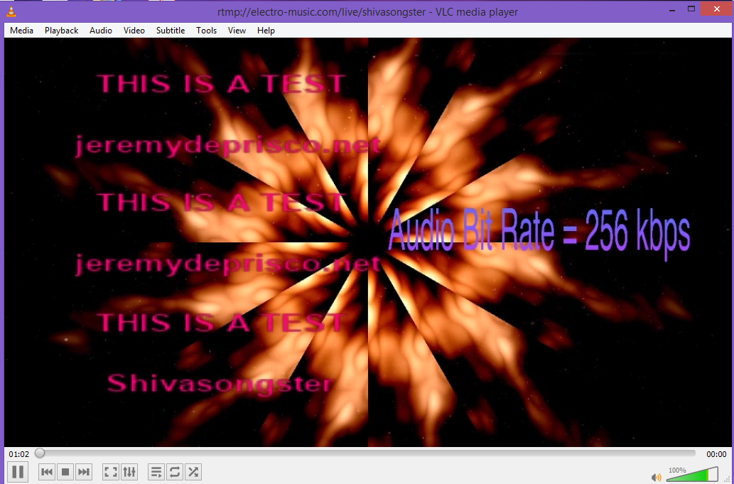

PostPosted: Wed May 20, 2020 7:09 am    Post subject: Audio Bit Rate Reply with quote  Mark this post and the followings unread
Ran successful tests with 160, 256 and 320 kbps.
Up to now I was running 160 for Twitch, FB and YT. I think there's room for experimenting here.

mosc wrote:
I'm concerned that using OBS, Ninjam and VLC while streaming may tax many systems to the breaking point, but we'll have to see what happens.
No one should even need to run VLC on their own machine while streaming. We were doing it for testing, but for real life I wouldn't recommended it - especially on the same machine.
Nothing I am testing involves Ninjam or JamKazam. I'm purely focused on:
- Solo broadcast
- Capturing a stream (whatever it is) to add graphics (to help Ken out for future events).
Those doing collabs with Ninjam/JamKazam will need to do their own extensive tests. I don't mind being a set of ears/eyes, but I'm already laser focused on getting things to work for the majority of broadcasters.
The other factor we had here was that my wife was on a Zoom webinar on one machine, and also on another machine logged into school. So my ability to broadcast may have been impacted by the bandwidth issues. Today was unusual though, and this testing kind of just happened organically (not planned).
But yes, I wanted to compare Adam's settings with mine and see if we can make suggestions from an EM perspective. It's always going to be a bit subjective though. Knowing the min requirements the server wants to see it is a starting point, and folks will still need to do their own testing to find their best settings, just as they would for any other platform. Using an EM video server is not going to get artists out of solo testing for any larger event we might try to pull off.
