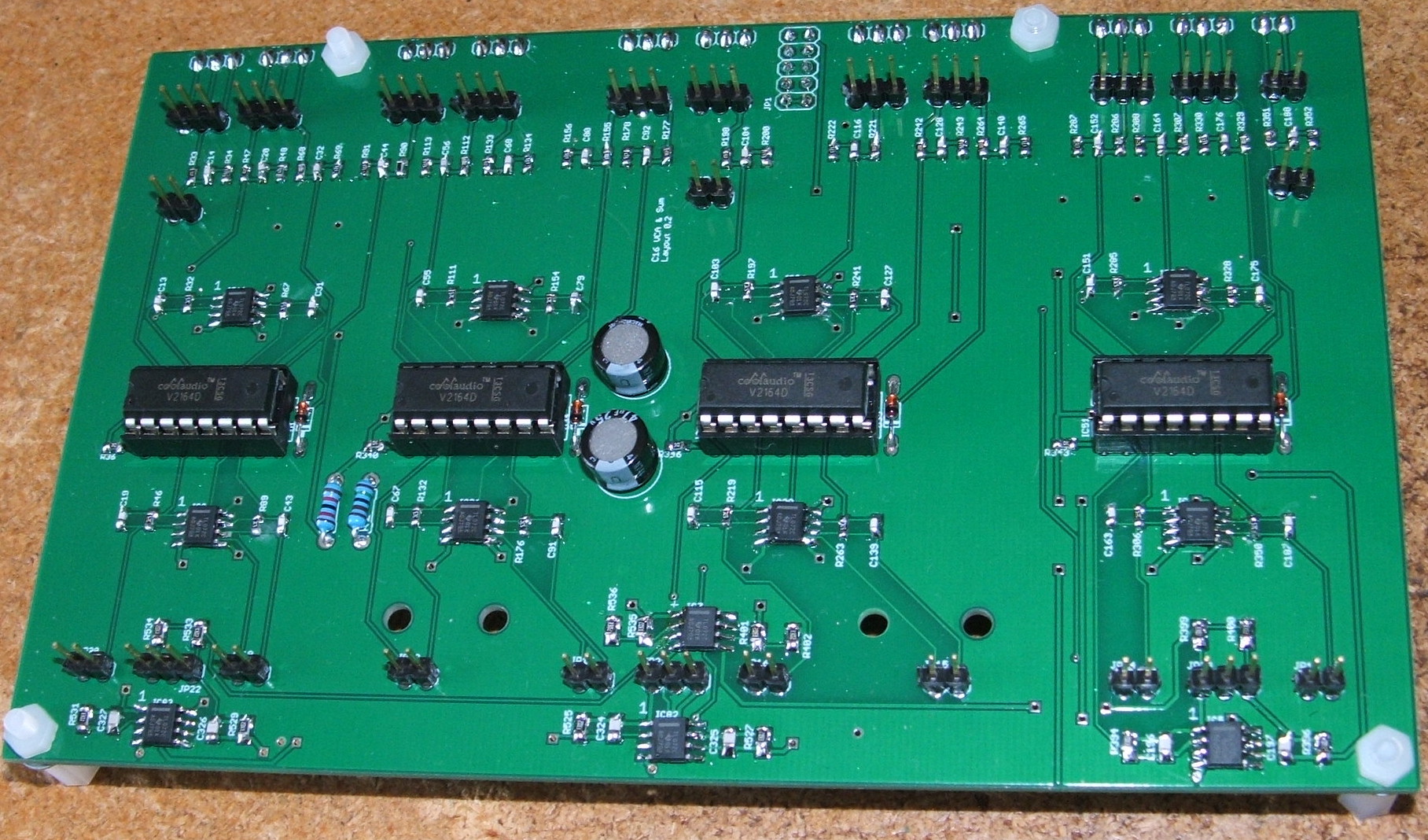

This is the VCA/Summing board, after patching. Two opamps (long wires) had their inputs reversed, needing traces cut and patched, and the 2164's are currently bypassing the individual output opamps and are summed directly by the final opamp. I only included two because one, I only had two when testing, and two, I don't need all sixteen bands to be VCA'ed to test how a handful work together. I've got a new revision that incorporates all this Smile
To the right of that is the jack/slider PCB. Two slider LEDs had no ground connection, hence the two 'U' patch wires. I only had 50kB linear taper sliders on hand, and all the resistors are to change them to a 10kA audio taper. I've got a new revision with the added grounds, and also optional SMD resistor placements to adjust the slider taper/resistance (see the link below for more on this.)

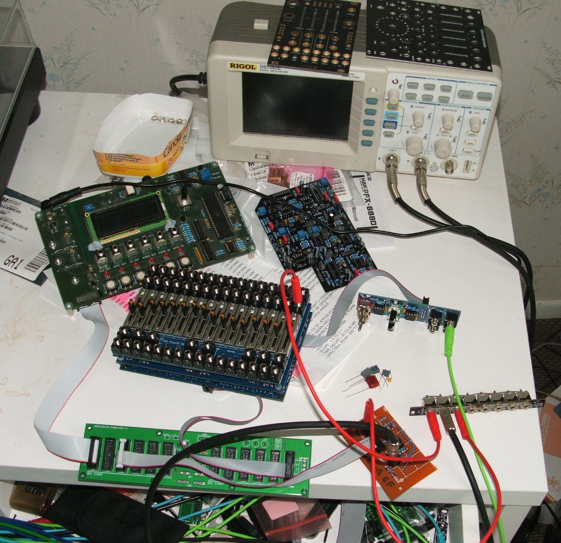

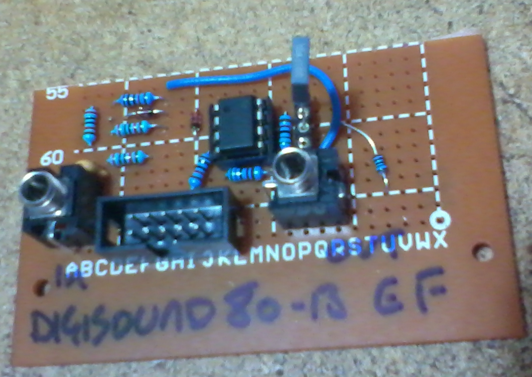

This is how I test circuits! Breadboard never seems to work right, for me, so I like to perf circuits that I don't want to dedicate a pro PCB to. Thonkiconn PCB mount jacks just make this even easier for me.
Prototype of the Digisound 80-13 Envelope Follower. I did plan the layout (roughly) in Eagle, both to find a good layout, and also to remind myself of the pinout for the TL072. (Measure twice, and all.)
The socketed capacitor is marked in the original schematic as being changed to match the frequency of the signal being followed. I tried 100nF and 470nF, and there is definitely matching needed to get the best results. If I was doing a proper module for this circuit, I think I'd put a switch on the panel to toggle between three different capacitor values. I'm going to patch up some enveloped noise going through my 0.1 revision C16 and use the Direct Out for each band to figure out the optimum capacitor value for each iteration of this envelope follower.

Right, new revision of PCBs and panel are being fabbed, so I needed to test which envelope follower capacitor value worked best in each EQ band.
You can see my little group of test caps I was swapping in and out of the sockets on the perfboard Smile

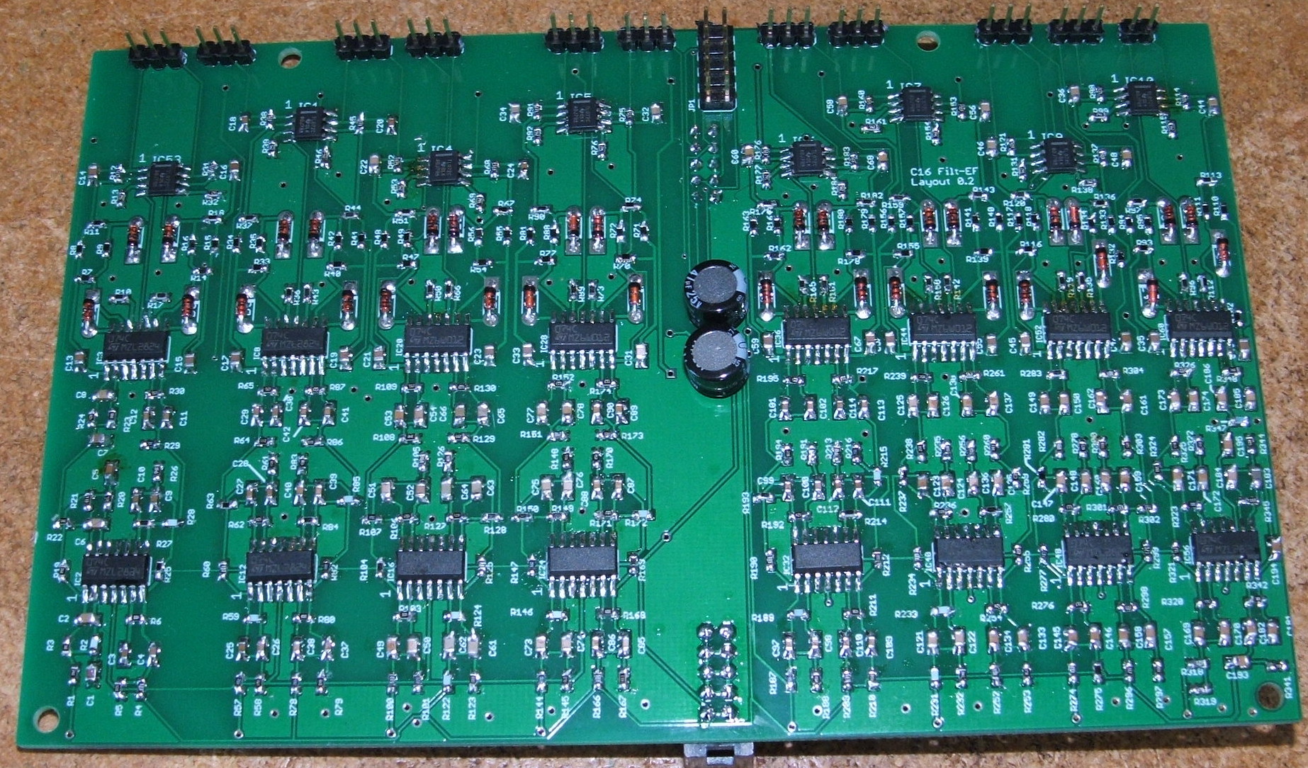

EngA is finished -- the sixteen VCAs, and the final mixers for the various outputs. I think it looks quite spiffy!
EngB, on the other hand, needs 99% of work still to be done on it.

I've soldered up EngB, the board with the filters themselves and the new envelope followers. If I ever do another take on this project, the filters are getting their own, dedicated PCB so I can just solder them up once and then do new revisions of the other submodules.
The good news is that the followers work nicely. I plugged in a VCO to the Input, and as I messed with the frequency of the VCO, I could see the lights on the panel travel up and down the spectrum (as opposed to the old followers, which lit up whenever the heck they felt like it.) One or two LEDs aren't lighting up, so I need to test whether it's the filter for that channel (everything follows on from the filters), or whether it's the follower. I'm going to do that when I have the energy... stupid overtime.
Once all of this board is verified good, I'm then going to go through the gain stages -- the gain on the input buffer (currently set to 3x gain... too high, I'm pretty sure it's blowing out the VCAs), and the gain on the various output mixers (faders, VCAs, comb) so that they all come out at roughly the same p-p levels. Should I set the fader out levels so that when the faders are at max, the gain is x1 (compared to the input), or so that they have a bit more gain if you dime all the faders?
I also need to test the spectral transfer switches, and see if the resistors are passing the right amount of signal (or if they're going to distort those VCAs... again...)
Making progress, slowly, but then I've wanted this module for years. I can wait a bit. It's probaby vanity, but I also think these circuit boards are looking dead spiffy!
