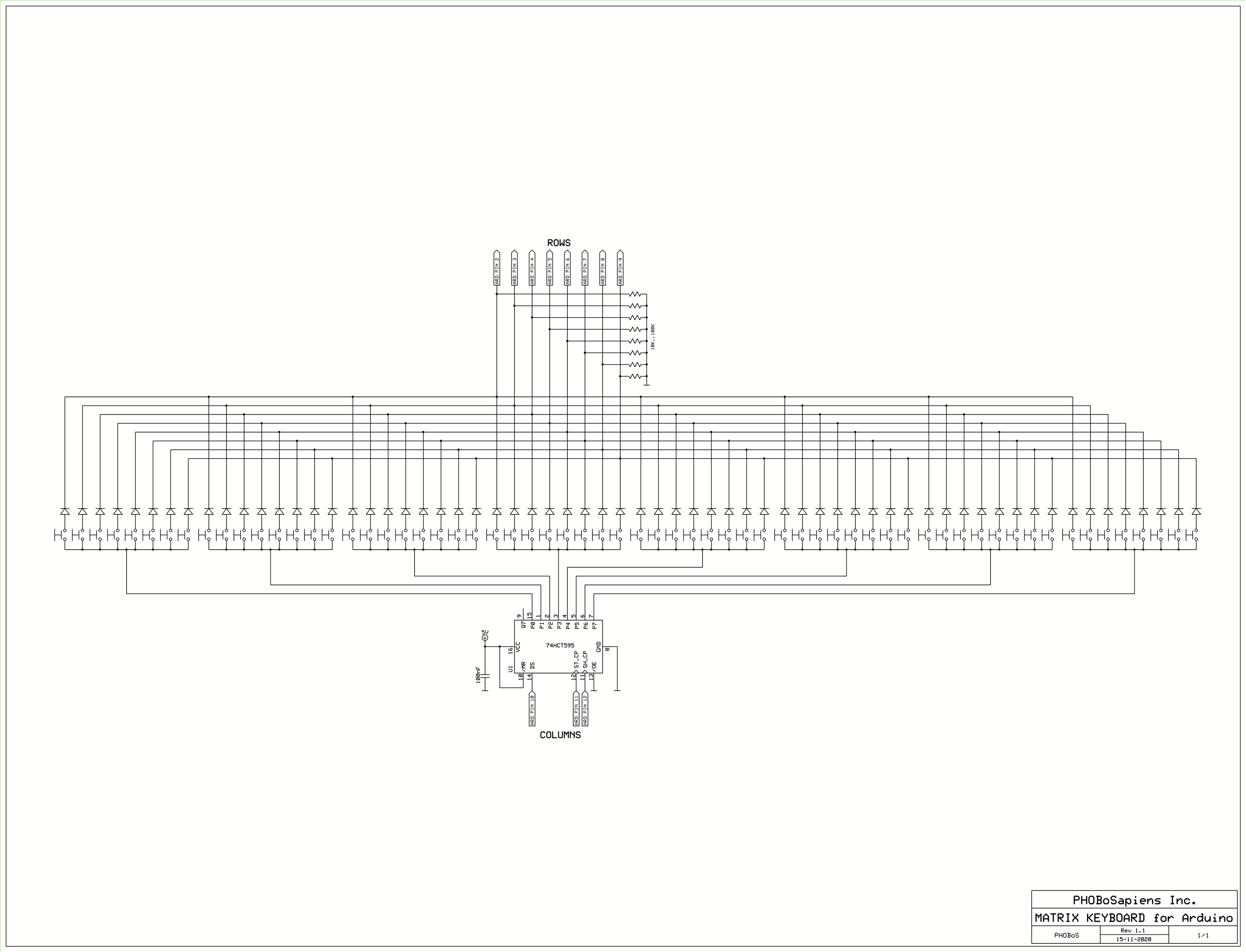

I've come across articles on this and I've tried to understand it but I'm struggling to understand how to implement it with the gear I have. I'm looking to use these keys with a synth i'm building through midi to cv I guess.
I understand I need a multiplexer and an arduino or microcontroller and that the keys are usually organised in columns and rows. The pics are the keyboard im working with, its 61 keys and seems to have two ribbon connections coming off it, both with 8 output pins coming off of them which seems easy enough? I wrote out a table in a way I think I understand it but how on earth do I go about implementing this?
Is there a Vcc and ground coming out of the ribbon cables? If so that changes the number of outputs? How do I know which is columns and rows?
Appreciate any help
Thx

For a keyboard matrix you will have to send a voltage in sequence to the rows and for every row scan all the columns.
send a voltage to row 1, read the voltages from column 1 to 8
send a voltage to row 2, read the voltages from column 1 to 8
send a voltage to row 3, read the voltages from column 1 to 8
etc,..
note that unless the keyboard itself already has diodes or other components you can swap rows/columns. So you could also
send a voltage to the columns and read the rows.
what you need to watch out for is that if you don't send a voltage to a row it has to be unconnected or high impedance.
So don't just send high an low signals as this can lead to shorts. A mux would be an easy way to do this though you could
also use transistors or even diodes. There is also things like ghosting and blocking that you have to keep in mind but you
should find that out along the way. Here's something to start with https://deskthority.net/wiki/Rollover,_blocking_and_ghosting _________________ "My perf, it's full of holes!"

ok i broke my eyes and followed the traces on the board:
found 7 groups of 8 keys and 1 group of 5 -> connected to the bottom ribbon cable and to the keys
and 5 groups of 8 and 3 groups of 7 -> connected to the top ribbon cable and to the diodes
so judging by the numbers the table i wrote must be correct?
in that diagram above, the diodes face the rows and in this keyboard, the diodes face the top ribbon cable so the top is the rows? does that mean they are pull up?
and what would be an implementation you would recommend, shift register? |
floating-water
Joined: Oct 06, 2020 Posts: 62 Location: UK
Posted: Sun Nov 15, 2020 3:27 am Post subject:
so id put the 8 rows into digital pins on atmega(arduino), the 8 columns go into shift register inputs
the clock, latch and data from the register goes into the arduino digi pins
besides modifying the amount of rows/columns in this code is there anything else I need modify?

some things I've noticed sofar
- the number of columns and rows should probably be set to 7, not 8 as it starts from 0
- the initial note value is set to 31 which is a G (octave 0) so its value depends on the layout of the keyboard and
what you want the lowest octave to be. You could add switches or something else later to make this adjustable.
- the function 'scanColumn(int colNum)' can be simplified since you only have 8 columns.
- there is some inversion going on, not sure yet what's up with that. Do you have a link to the instructable ? _________________ "My perf, it's full of holes!"

what about this bit:

https://www.instructables.com/Add-MIDI-port-to-Keyboard/
really good instructable, its still all new to me tho. theres a deleted video where he supposedly explained the areas o fthe code to adjust
is the scanColumn(int colNum) to do with daisy chaining the shift registers? |

thanks for the link, I'll check the instructable.
| Quote: | | is the scanColumn(int colNum) to do with daisy chaining the shift registers? |
yes, if you look at this section:
| Code: | void scanColumn(int colNum)
digitalWrite(latchPin, LOW);
if(0 <= colNum && colNum <= 7)
shiftOut(dataPin, clockPin, MSBFIRST, B11111111); //right sr
shiftOut(dataPin, clockPin, MSBFIRST, bits[colNum]); //left sr
else
shiftOut(dataPin, clockPin, MSBFIRST, bits[colNum-8]); //right sr
shiftOut(dataPin, clockPin, MSBFIRST, B11111111); //left sr
digitalWrite(latchPin, HIGH);
it checks if the column is between 0 and 7 in which case it uses the left shiftregister else it uses the right shift register.
But you only have 8 columns and 1 shiftregister so you only need:
now here's where it's a bit strange as the bits[colNum] value sets all the outputs to 1 except the one it wants to read
and then it inverts the reading. I don't think that can work in your case because of the diodes.
oh and this section:
| Code: |
//get row values at this column
int rowValue[NUM_ROWS];
rowValue[0] = !digitalRead(row1Pin);
rowValue[1] = !digitalRead(row2Pin);
rowValue[2] = !digitalRead(row3Pin);
rowValue[3] = !digitalRead(row4Pin);
rowValue[4] = !digitalRead(row5Pin);
rowValue[5] = !digitalRead(row6Pin);
will have to be extended for 8 rows (note that the ! is responsable for inverting the readings) _________________ "My perf, it's full of holes!"

right right ok fascinating. is it just the exclamations that initiate the inversion? so if a board didn't have diodes you could invert the readings through the code to prevent ghosting?

keep me informed if there's anything else that looks odd or anymore general information for me to learn otherwise ive ordered the parts, just need to trial & mirror it |

no, you can't prevent the ghosting in code that way but could use it if the diodes were reversed.
There is still something else that is inverted:
| Code: |

This is what sets 1 output low and the rest high which should be the other way around.
Checking the instructables I also found out why, you downloaded the code for the pullup resistors
from github but you need the version for the pulldown resistors, this doesn't have the inversions.  _________________ "My perf, it's full of holes!"

ah lol ok. one thing are u sure the number of columns need to be 7 each, on his he labels them 6x11? edit: i realise it probably just depends on what i number them later in the rowValue?

| floating-water wrote: | | ah lol ok. one thing are u sure the number of columns need to be 7 each, on his he labels them 6x11? |
You might be right, let me have another look.
| Code: | boolean keyPressed[NUM_ROWS][NUM_COLS];
uint8_t keyToMidiMap[NUM_ROWS][NUM_COLS]; |
This creates 2D arrays and the size of the arrays depends on the values of NUM_ROW and NUM_COLS. So in this case those should indeed
be 8 as it only indicates the number of positions. 8 positions can fit 0 to 7.
ah ok all the counters actually use < instead of <= for example this one
| Code: | | for (int colCtr = 0; colCtr < NUM_COLS; ++colCtr) |
which will count from 0 to 7 if NUM_COLS = 8.
conclusion: yeah, set them back to 8
for the rest I think that should work. _________________ "My perf, it's full of holes!"

keyPressed[rowCtr][colCtr] = false;
keyToMidiMap[rowCtr][colCtr] = note;
note++;
// setup pins output/input mode
pinMode(dataPin, OUTPUT);
pinMode(clockPin, OUTPUT);
pinMode(latchPin, OUTPUT);
pinMode(row1Pin, INPUT);
pinMode(row2Pin, INPUT);
pinMode(row3Pin, INPUT);
pinMode(row4Pin, INPUT);
pinMode(row5Pin, INPUT);
pinMode(row6Pin, INPUT);
pinMode(row7Pin, INPUT);
pinMode(row8Pin, INPUT);
Serial.begin(SERIAL_RATE);
void loop()
//scan next column
scanColumn(colCtr);
rowValue[0] = digitalRead(row1Pin);
rowValue[1] = digitalRead(row2Pin);
rowValue[2] = digitalRead(row3Pin);
rowValue[3] = digitalRead(row4Pin);
rowValue[4] = digitalRead(row5Pin);
rowValue[5] = digitalRead(row6Pin);
rowValue[6] = digitalRead(row7Pin);
rowValue[7] = digitalRead(row8Pin);
// process keys pressed
for(int rowCtr=0; rowCtr<NUM_ROWS; ++rowCtr)
if(rowValue[rowCtr] != 0 && !keyPressed[rowCtr][colCtr])
keyPressed[rowCtr][colCtr] = true;
noteOn(rowCtr,colCtr);
// process keys released
if(rowValue[rowCtr] == 0 && keyPressed[rowCtr][colCtr])
noteOff(rowCtr,colCtr);
void noteOn(int row, int col)
Serial.write(NOTE_ON_CMD);
Serial.write(keyToMidiMap[row][col]);
Serial.write(NOTE_VELOCITY);
void noteOff(int row, int col)
Serial.write(NOTE_OFF_CMD);

When I tried compiling the sketch it gave an error:
'scanColumn' was not declared in this scope
on this bit:
| Code: | void loop()
//scan next column
scanColumn(colCtr); |
What on earth does that mean? |
