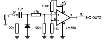

PostPosted: Mon Sep 25, 2006 3:23 am    Post subject: Reply with quote  Mark this post and the followings unread
refering to the original design i wonder if i could easy add an external clock control, which should work with both trigger and gate signals. i thought of something like the following.
i don't know how to handle the clock pulse width the 4017 requires (up to 250ns). would a cap do and what should be the value?
what do the experts say?

PostPosted: Mon Sep 25, 2006 4:03 am    Post subject: Reply with quote  Mark this post and the followings unread
just another idea: what about using a DPTP on-off-on switches for each step controlling both the gate and the reset function? (i.e. switch down: gate on; middle: gate off; up: gate off/reset)
i'm planning to do a small modul for my modular, not a real sequencer but a little automation, not very panel intensive...
PostPosted: Mon Sep 25, 2006 4:06 am    Post subject: Reply with quote  Mark this post and the followings unread
The 4017 will trigger on the positive going edge of any pulse down to a few nS in duration, so I wouldn't worry about it.
You know that circuit will send a negative pulse if you put in a positive one don't you? That may be what you want, but the 4017 will trigger at the end of the pulse that way.
PostPosted: Mon Sep 25, 2006 4:17 am    Post subject: Reply with quote  Mark this post and the followings unread
what i actually wanted was to be able to trigger with gate signals too. but this might be a little be more versatile (mr ken stones gate2trig conversion?).
i'd thought i would ground it just like the manual step switch. how could i accomplish that?
as you can see, uncle krunkus, i have to learn a lot, but i am willing to...
PostPosted: Mon Sep 25, 2006 6:14 am    Post subject: Reply with quote  Mark this post and the followings unread
I've still got heaps to learn as well!
I just had another look at that circuit, (trying to work out exactly why I said what I said!) and I'm not sure now! Laughing
Now lets see if I can talk this through.
I think for a positive going pulse, you need to move the 10K down to the emitter, going to ground. Take your clock directly off the emitter. The cap can probably go either on the collector or the emitter, but probably would be better on the collector, (I think?)
Anyway, when there's no incoming gate/trig the transistor is the larger resistor, so the clock out is held low. When a signal comes in the transistor conducts and it's emitter voltage goes up towards +V. I'm beginning to think the cap would be best on the base.
Of course, if anyone else knows for sure, feel free to let us both know. Embarassed
PostPosted: Mon Sep 25, 2006 6:57 am    Post subject: Reply with quote  Mark this post and the followings unread
i think, i have a general misunderstanding - i thought the 4017 would be triggered if clock in was set to ground (regarding the momentary switch for manual step fwd)? So i tried to hold the clock high, when no trigger signal present...
if any trigger pulse would go, maybe the gate2trigger circuit from mr ken stone would do. i think i will breadboard the whole thing this week and then see...
gate to trigger converter by ken stone:
 Filesize:  9.94 KB
 Viewed:  26453 Time(s)
