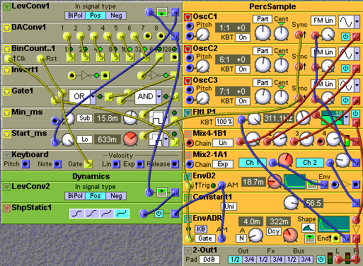

Here is a Nord G2 variation on the Bouncing Ball effect discussed elsewhere. It does not use samples because us poor old G2 people have to synthesise everything from scratch (luckily, that's what I prefer to do anyway).
Basically, an incoming trigger from the keyboard kicks off a series of triggers, which also clock a binary counter/DAC combination, which is used to shorten the time between triggers. When the time 'decays' to shorter that the Min_ms pulse time, the triggering stops.
OK it's a little silly but fun to play.

How do the BinCounter and DAConv modules work? The manual is not much use to the uninitiated. I can probably work out the rest if I understand how these modules funtion.

The binary counter is an emulation of a logic circuit. It counts in binary arithmetic. There is a bit for each binary "digit". Hook up an LFO to one and watch the lights (set the LFO at a slow frequency). You'll see an interesting side effect - each output is running at 1/2 the frequency of the previous one.
The DAC, digital to analog converter, takes in 8 inputs and puts out a singal that corresponds to the binary number of the inputs. If you put in the output of a binary counter, then the output of the DAC would be a ramp.
