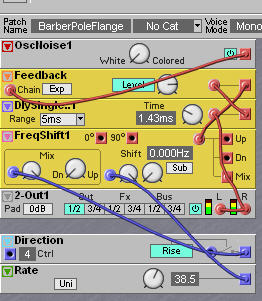

On the subject, while too trivial for it's own topic, here is a barberpole flanger. It uses nothing more than the FreqShifter with delayed feedback. I have to admit that I tend to overuse the FreqShifter, I just love the 60's analogue sound it gives to everything.

Oh, I like that. And useful, too. Never knew a frequency shifter could be used like that.
Boy, do I have a lot to learn :')

The Barberpole Flanger is great. I've never heard this one. It's quite like the Shepard Tone - it just keeps going up and up. It's such a simple patch. Here's a screen scrape and an mp3 file.
Screen shot of the barberpole fanger patch
Unfortunately, my G2 is in the studio two floors below this computer. Could you post the actual patch? That would make it a lot easier to transport to the G2.

The barber pole patch is posted, just look more carefully...

Thought I had better update the flange patch, as V1.2 no longer has mix out. The new version simply uses a 2-1 switch for manual direction control. If you require 'voltage controlled' direction then use a x-fade instead. I also put a more musically relevant example in variation 2 (for those not so much into noise).
