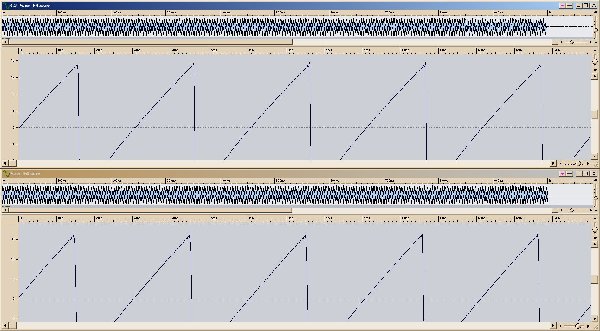

Well I'm more lost now than before...
Even while they look almost exactly the same, they sound different.
By the way, I use always headphones (AKG K271 studio), and the difference is notable with them.
comparing g2 and nl2 saws
 Filesize:  198.06 KB
 Viewed:  466 Time(s)

What is the difference?
I listen closely to both Saw waves...
Is one sharper, rounder, softer, more narrow or something like that?
I don't hear any differences, although I'm an old man Smile
I still think the differences between both synths are the DAC's and their parameter values, so together the sound is different.
I play the NordLead3 with Patches where almost all parameters are assigned to the Morphes, only not the Keyboard Morph. There are alot of extremes there...
Wout

It sounds to me like there is some dithering/brightness/noise differences between the 2. The difference is similar across each pair of waveform comparisons. Just my $0.02 CDN or USD (or $0.0206 CDN Smile )
/Dasz
