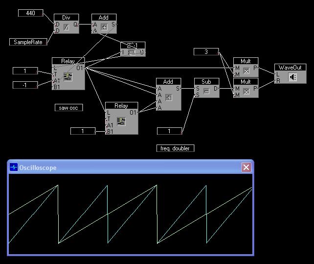

... and here is the SynC Modular rep. of the saw osc and frq. doubler ...

These patches with the low lever dsp stuff are facinating, but understanding them when you see them is not very intuitive. drunken cheese blackeye

... not very intuitive.
Idea
This is the sawosc.
Here is how it works: the 'add' module and the 'reset' modules are looped. The output of the 'reset' module continuously monitored by the 'compare' module, and while B less the 64, then 1 added to the output.
When B reaches 64 it resets the output to -64 and the cycle starts again.
something like ...
B:=-64;
if B<=64 then
B:=B+1 else B:=-64;
goto @
