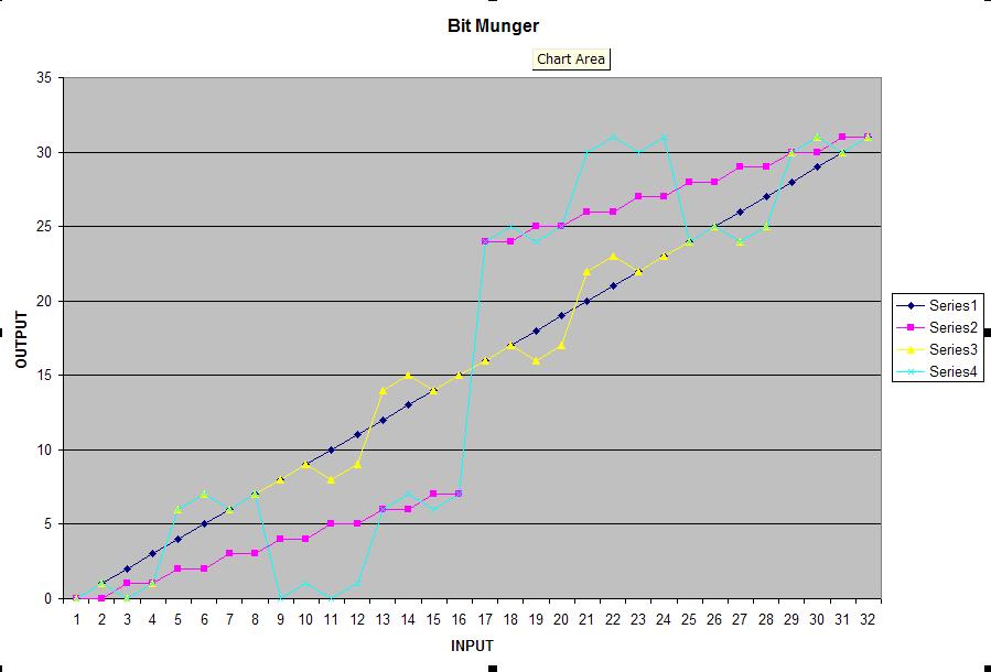

Wan,
By doing the bit-selection the way you do inbetween the ADC and DAC, you're doubling certain bits, while throwing away others.
I made a simple graph using a spreadsheet, that is setup like most software compressors are- input on X-axis, output on Y-axis. To simplify, I only used 5 bits of adc/dac, but it easily makes the point here.
series 1 - linear (adc -> dac direct 1:1 connection)
series 2 - highest bit is used in place of highest & second highest bit.
series 3 - middle bit (bit 3 here) is used in place of bit 2 also.
series 4 - bit 5 (highest bit) replaces bit 5 and 4, bit 3 replaces bit 3 and 2 (somewhat combined series 2 & 3 ).
I use this method to create various look-up tables (that are larger than the 16 length (4 bit) sequencer/table that is available as a module. But I like the oddity you've come up with.
As for squeltching, it would depend on the divider/bit selection, and the frequency content of the input signal. In essence, (refer to the picture), a repeating wave (ie-frequency) would be jumbled up, in a repeating way. So in essence, you are moving the energy in certain frequencies to other frequencies. It'd probably be a good exercise to look at the "RAW" waveform and "DIST" waveforms through a FFT analyzer on your PC.
example graph of "squeltch without filter".
Thanks for this explanation, it is still a bit over my head, but the transfer of energy from frequencies to other frequencies is something that makes it a bit easier to grasp. I shall try to take a look at FFT analyses.
