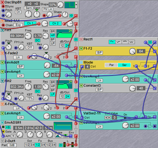

Hi there,
I have been trying to improve a patch that I made a while ago, by adding a switch to give me the option of routing the two filters either in serial or parallel formation. I have managed to do this by inserting a mixer for the two filter outputs and a switch to determine whether filter 2 gets the output signal from the oscilators or from filter 1. (see attached picture)
So far, so good. It seems to work fine. The problem that I'm having is finding a way to get ONE switch to control both the filter routing switch AND whether filter 1's output goes to the amp or not. Does anyone know of any way to do this, or am I just dreaming?

Trying to get 'FltCombin' and 'FiltRouting' to operate from one switch or find alternative way of accomplishing the same end result.

Thanks guys. I'll look at those switches in a minute Jan. I've got an even bigger ambition now... I've been trying to set up a filter balance control between the two filters. This can be done easily enough with a cross fader if the filters are in the parallel configuration, but the problem arises when they are set to serial.
Can you think of any way of having a cross fader that has the two filter signals (as if set in parallel) at the extremes, but with the combined (serial) signal at the centre? (As featured on Access Viruses)
I've thought long and hard about it and I think I might be asking a little too much. The closest I have got so far is to have a fader that goes from Filter 1 through to Filter 2 in parallel set up (good so far) and the same fader that goes from Filter 1 to Filter 1 through Filter 2 in serial set up, which isn't bad, but I can't find a way of getting a Filter 2 only sound using this setup.
Any ideas anyone?

Thanks Ian. Very helpful..., but I'm after something a bit more complex:
In your example, when the routing is set to serial, the fader has the same signal on both sides and so is redundant. I've been trying to find a system where there are seperate faders to fade between '2 serial filters to filter 1' and '2 serial filters to filter 2' using window switches to switch them in and out via a morph knob.
I don't think that sounded clear. Basically I want one morph group fader to control the filter balance in 2 different ways depending on the filter routing:
Parallel - cross fader from only filter 1 to only filter 2
Serial - cross fader from only filter 1 to only filter 2 BUT WITH filter 1 through filter 2 at the centre (value 32)
I have tried to think of it in two parts, more like:
Serial - cross fader from only filter 1 to filter 1 through filter 2 (values 0 - 32)
Serial - cross fader from filter 1 through filter 2 to only filter 2 (values 32 - 64) - For this part, I have used a mixer that raises the level of the 'parallel' signal in the 'serial' signal path.
The main problem that I now have is that I need the faders/mixers to only respond to the morph knob either from value 32 - 64, or 0 - 32, ie. I need the parallel level in the serial path to be 0 when the morph knob is at 32. Any ideas?
The overall aim is to be able to hear either filter on its own, regardless of the filter routing. I haven't quite got there yet and could still do with a hand if anyone is able to help.
Many thanks.

OK I think I've got it at last! I've made a few alterations. When in serial mode, with the F1-F2 knob in the center, the signal I was hoping to get was the F1 THROUGH F2 signal, not the output of F1 mixed with the output of F2. So I inserted a few 'x2' Amp modules and a Lev Add module, changing the positions of the x-fade knobs. Now what (I think) I have is a filter balance knob that does the following:
Serial mode:
-64 to -1 : Filter 1 out to Filter 1 through Filter 2
0 : Filter 1 through Filter 2
1 to 64 : Filter 1 through Filter 2 to Filter 2 out
So far so good... that's as I wanted it. Then I realised that that messed up the parallel settings, so I had to insert a Value switch that removed the 'x2' LevAmp from the path, controled by the Mode switch. So now I have:
Parallel mode:
-64 to -1 : Filter 1 out to Filter 1 and Filter 2
0 : Filter 1 and Filter 2
1 to 64 : Filter 1 andFilter 2 to Filter 2 out
Just as I wanted! (I think) I've attached a sreen grab, so if anyone could verify it, that would be great.

Thanks again Kassen, but I only need to add a few switches and split the mixers using this patch as an example. (see attached pic) Now I just have to try and fit it all into my patch!!
It sounds like it works properly, but can you please tell me if you think it looks right.

Now it´s all getting quite complicated! I didn´t find anything wrong with it just now but some of that cabeling is a little confusing. I think I get your overall strategy and I agree with that one.
There´s realy no need to look at my pch for you since the solution for the serial thing is the same, I think. The NM editor is free though and you may like to install it just to be able to look at patches; I have a G2 one here too for the same reason. Frankly now I can´t imagine why I didn´t make my example in the G2´s editor in the first place.

PostPosted: Mon Jun 27, 2005 2:06 pm    Post subject: Reply with quote  Mark this post and the followings unread
Hey Ian, thanks for pointing that out... but what does that mean? It all seems to work as it is supposed to now.
Dave, if you read the description of what I have been trying to achieve, you'll see that I want different signals through the second fader, depending on which mode the filter is in. As it is, I have just about achieved that and now I'm trying to incorporate it into a patch of mine with an extra 'split mode'. I did have a simpler system before, not too different from yours, but I'm quite new to this and basically am experimenting. Thanks for the interest though.

PostPosted: Mon Jun 27, 2005 2:16 pm    Post subject: Reply with quote  Mark this post and the followings unread
It does? That´s not how I read the problem, I thought we were going from F1 to both to F2 through pure serial which basically requirers your solution but with some extra CV manipualtions and independant controll of the crossfaders. The CV manipulations in mine could have been done more efficiently, I admit.
Once we are actually going to listen to this, instead of just theorising about the controll some atention will need to be paid to phase issues, particularly where two pole filters are concerned; the signal coming from F1 and going around F2 should probably be inverted in that case depending wether they share cutoff frequencies.
Kassen

PostPosted: Mon Jun 27, 2005 3:27 pm    Post subject: Reply with quote  Mark this post and the followings unread
To be clear: In SERIAL mode, I want the 'filter balance' knob to go from (osc mix through filter 1 only) to (osc mix through filter 1 THEN filter 2) in the central position, then on to (osc mix through filter 2 only). Not (osc mix through filter 1 AND osc mix through filter 2) in the central postion - this behaviour is only for PARALLEL and SPLIT modes.
As it is, I have now managed to incorporate this into my earlier patch (see attched pic). It all seems to work ok, although I'm still not really sure about what Ian was saying about the mod levels. It's an extremely busy patch, built to give me as much control as possible using my controller device instead of the mouse - the filter section is in yellow. It's a bit hard to follow the cables... sorry.
Kassen, I have tried inserting an invert module (highlighted in attached pic), but am not sure if it is an improvement or not. Is that where you were talking of putting it?
When I'm sure this patch is all working ok, I'll be posting it on another topic that I have at the moment. I'll let you know when if anyone is interested... I suppose I could post it here too. Very Happy
Filter section is Yellow, on right. Sorry, but I had to put the modules as they are, so that I could see all of the important (controller editable) parameters in the first 4 columns, ie. so I could just ignore the 5th column when sound creating.
 Filesize:  678.56 KB
 Viewed:  22838 Time(s)
