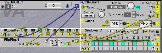

Hello everybody,
I've got a question about the gate that I can't solve for quite a while now.
I thought that when I hit the switch I'd send a positive signal to the gate directly and make the sequencer send one, too. 1+1=0 would make the XOR do nothing. But it does not only blink, it sends a signal, too Shocked
Where am I wrong?

What I think .. in general the length of the pulse from the switch output will be different from the length of the first pulse out of the sequencer.
like this for a slow running sequencer.
Code:
switch
          _____--------________
seq
          xxxxx-----------_____
xor
          xxxxx________---_____
For a fast runing sequencer the seqencer out pulse would be shorter than the switch out pulse and the same sort of situation would arise.
Only when the sequencer runs at one particular speed this could possibly work, but even then you'll probably run into trouble due to timing differences for signals runing different paths through the circuit.
So the question is .. what would you like to accomplish with this circuit - or are you in in learn mode maybe ?

PostPosted: Fri Aug 19, 2005 4:14 am    Post subject: Reply with quote  Mark this post and the followings unread
Well, I inserted pulse modules on both sides, so the impulse on the gate had the same length. Doesn't change anything. Maybe there's a little latency due to calculation in the sequencer but since there's not really much not calculate I doubt that.
What I wanted to accomplish is a patch where I can trigger a sequence to run twice and then stop - until the next trigger. Actually I am in learn mode because I want to G2ize this patch by Rob.
It can be done exactly like it's shown there, but since we have a gate and a flip-flop, why not use it?
Doing it with the flip-flop is actually Rob's assignment here Smile
BTW, can't find the workshop on Clavia's pages anymore.
I think that workshop should be online. I've got a spare one here.

PostPosted: Fri Aug 19, 2005 5:40 am    Post subject: Reply with quote  Mark this post and the followings unread
How about taking a flipflop set tot he "set/reset" mode (not the "toggle) one).
Your flipflop 2nd (inverted) output is normally outputting one; you take the the clock and a binary counter to make the fliplflop go zero after 32 clock ticks. "And" that one with the clock to become the sequencer's clock.
Now the sequencer only receives the clock for 32 pulses and after that the flipflop goes low, breaking the chain. To start it again you send a reset to both the flipflop and that sequencer after which it'll take another 32 steps.
You could also do the same with just two counts of the "link" output of the sequencer but I'm not entirely certain that won't overshoot to still set the seq. back to the "1" so be carefull there.

PostPosted: Fri Aug 19, 2005 9:52 am    Post subject: Reply with quote  Mark this post and the followings unread
I think Howard was saying his own post was about to be off topic, and that he likes the look of the NM1 editor over the G2 editor.
Here's a patch to run twice after a trigger. It uses the LINK output (ie- end of sequencer) to run a counter. That counter clears a set/reset flop that allows the clock to reach the sequencer. Using this method, it is easy to change the length of the sequence, or change the number of times you allow the seq to run after trigger.
A building block to allow a sequencer to run twice after trigger
 Filesize:  28.29 KB
 Viewed:  12687 Time(s)

PostPosted: Fri Aug 19, 2005 10:54 am    Post subject: Reply with quote  Mark this post and the followings unread
Aargh, I just found out that I solved the do-it-two-times thingy already Embarassed
I got confused when BlueHell asked me what I needed it for. The gate question came up, when I tried to solve the 2times problem, it is not the problem itself anymore. I'm sorry I got confused about that!
So, attached patch will do it, but now I'm just where I started. Remember, the Gate question, why does that thing go blink?
WSL9.pch2
 Filename:  WSL9.pch2
 Filesize:  1.52 KB
 Downloaded:  1446 Time(s)
Posts: 24581
Audio files: 308
PostPosted: Fri Aug 19, 2005 11:44 am    Post subject: Reply with quote  Mark this post and the followings unread
I'm sorry to have confused you.
The answer is still the same though IMO ... timing differences in the pulses, even with the pulse modules added it would not be sample accurate and one sample time timing difference will bring you a pulse still on the Xor output.
Maybe making all involved signals red and orange will help (as the patch compiler does more work on those signals to try to solve timing problems) but that is pretty expensive CPU wise.
Synchronizing the signals (for instance by using S&H modules or FlipFlops) or finding a different solution to solve the problem is a better way to go. (this was the reason why I asked for what you wanted to do with the circuit, to try to come to a different solution).
