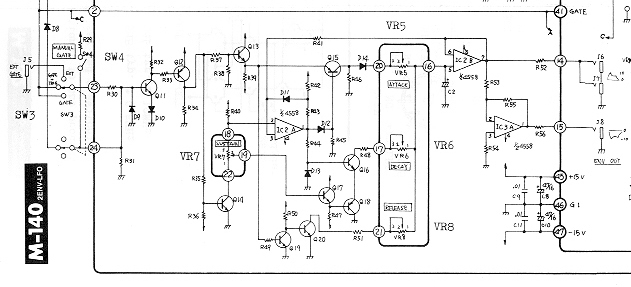

I’ve found the schematic of the snappiest adsr eg of the world !!!
It's the Roland System 100m A-140 module. (dual eg + lfo)

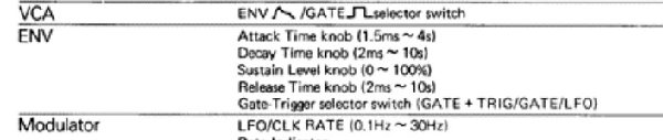

• ENV GEN
• Attack: 1 .5ms-7.5s
• Decay; 4ms-15s
• Sustain: O-±1OV
• Release: 4ms-15s
• Out: 1kOhm
• Gate/Trig Input: 50kU, 3V Min.
(are these specs significant anyway ?)

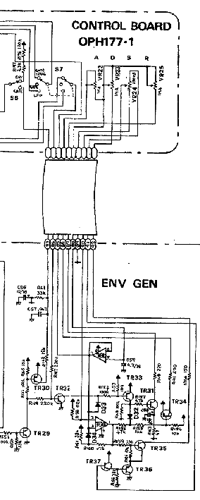

Look how simple it is. One 4558 and 10 trannies !

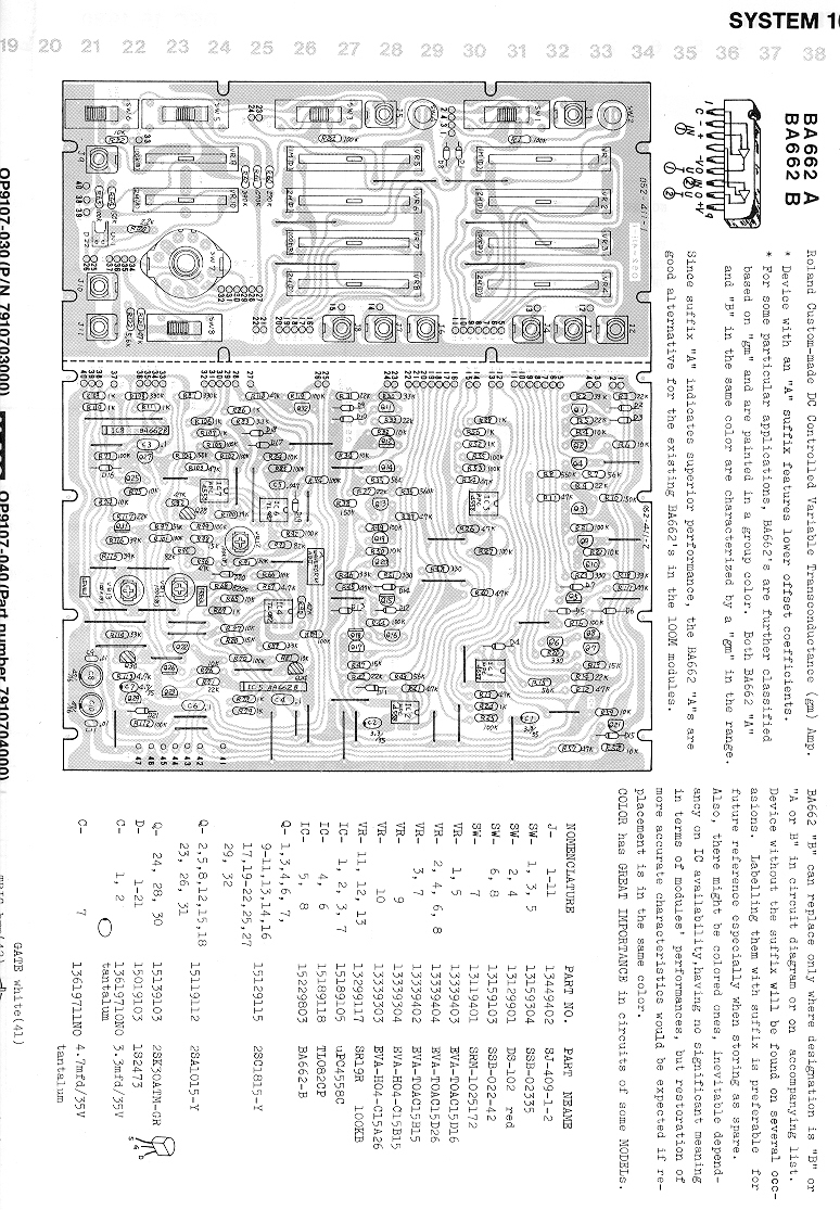

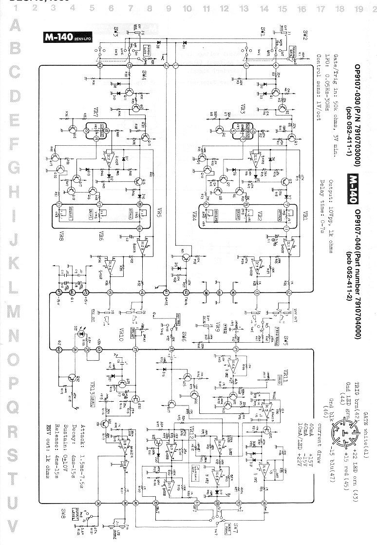

Resistor values are shown on the components layout, barely readable.
A friend of mine owns a system 100m ; we’ve done a test with these envelope generators and Oakley eg (I guess the AD/AR eg model).
Waouh ! tests have been shorten and oakley stayed unplugged for the night !(oakley eg are what I call my best adsr… )
My (poor) friend won't sell his 2000$ system 100m mainly because of its adsr eg.
You will have to trust me for a week or two, till I post some audio…
Coud there be any technical reason for my excitation ? Very Happy

diodes 1S2473 seems to be Germanium.
But they seem to be used in an usual "switching way".
So do you think standard silicon 1N4148 would do the job, or maybe the 0,4V/0,7V gap could interfere and lead to misfunctioning ?
the snap is in germanium !? Very Happy Very Happy Very Happy

well, lucky me then, I have around 20 of those adsr´s..... Smile
you will find better scans of the m-140 schemo at the roland 100m forum :
http://sys100m.org/

Here's the SH-101 specs (in big milliseconds) :
 Filesize:  24.17 KB
 Viewed:  594 Time(s)
