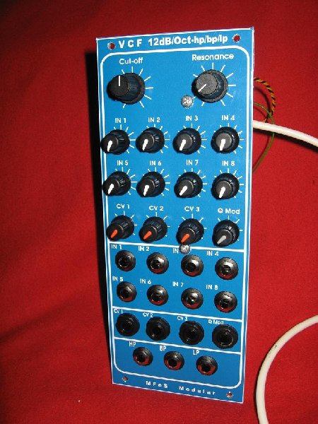

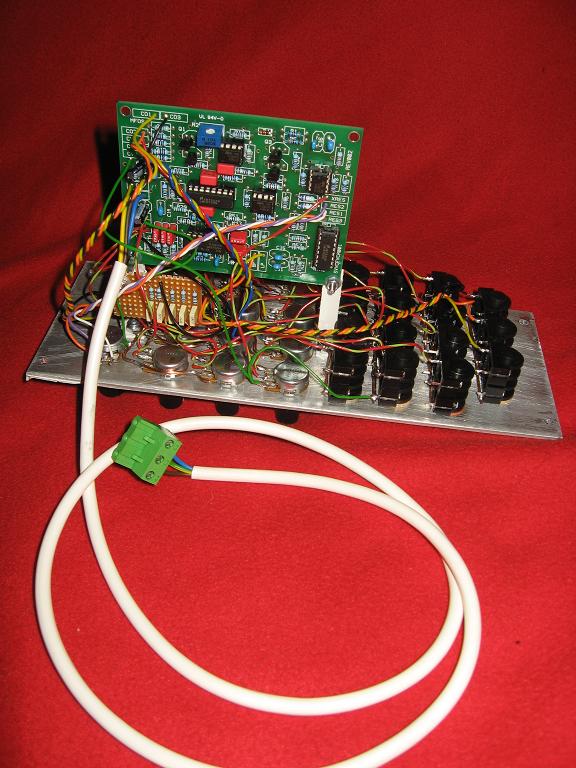

While in the chat room , i learned that wmonk was building a mfos 12dB/oct. vcf, at the same time as me , yay Smile .
I've finished my one over the weekend , a couple of silly wiring mistakes fixed now and it's working well , i'll post some mp3's in a few days .
this is the 3rd mfos state variable vcf i've built for the blue wardrobe , this time i used red box polyester 'Wima' caps mostly throughout and i really like the sound , slightly more aggressive sounding than an older one i built with polystyrene caps for C2 & C3.
I modded the audio input section of the board to make an 8 channel mixer (5 extra 1M resistors & 100Nf caps) .
a very handy filter.
Dave.

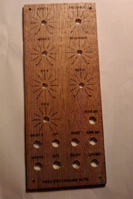

I would have expected that you would be way faster then me, hehehe. Still awaiting my order for most of the capacitors. In the meantime, a picture of the panel.

Looking great Thomas , good choice having the sockets at the bottom of the panel , easy access to the dials Smile .
How do you fix your pcbs to the panel , do the pots / sockets hold an L bracket or do you bolt through the front panel like i do ???
What caps did you choose for C2 , C3 ? .
id love to hear your filter after completion Very Happy

Months ago in the year of the Lord 2010 I started this project. I guess now the year off the Lady started, it goes faster. Smile
My module was finished on January 8th 2011, and it sounds great Smile
I used FKP capacitors for C2 and C3 (metallized polypropylene film)
The pcb is attached to the panel with an L-bracket. Sounds have to be recorded, will do that next week. Cool
