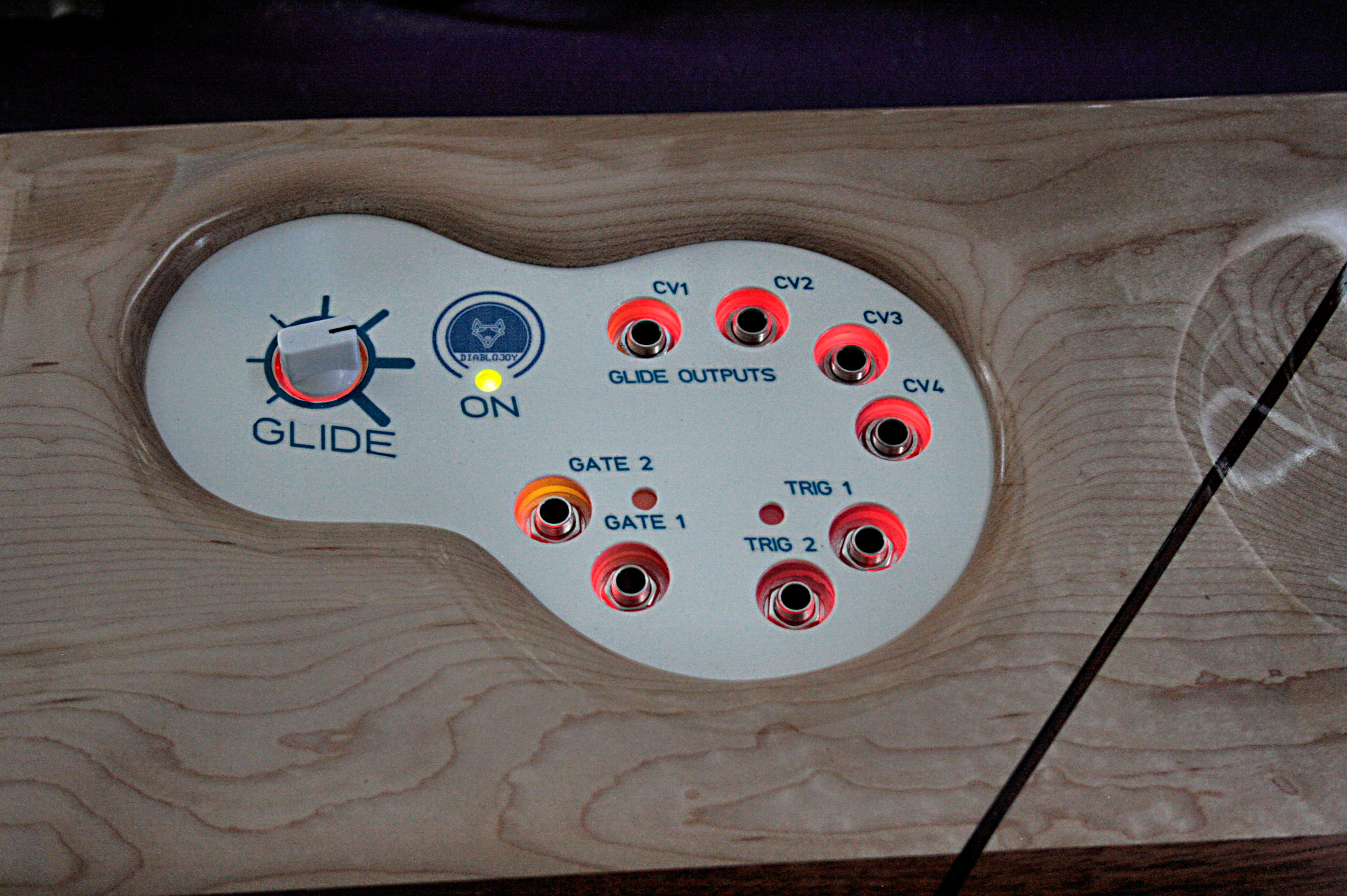

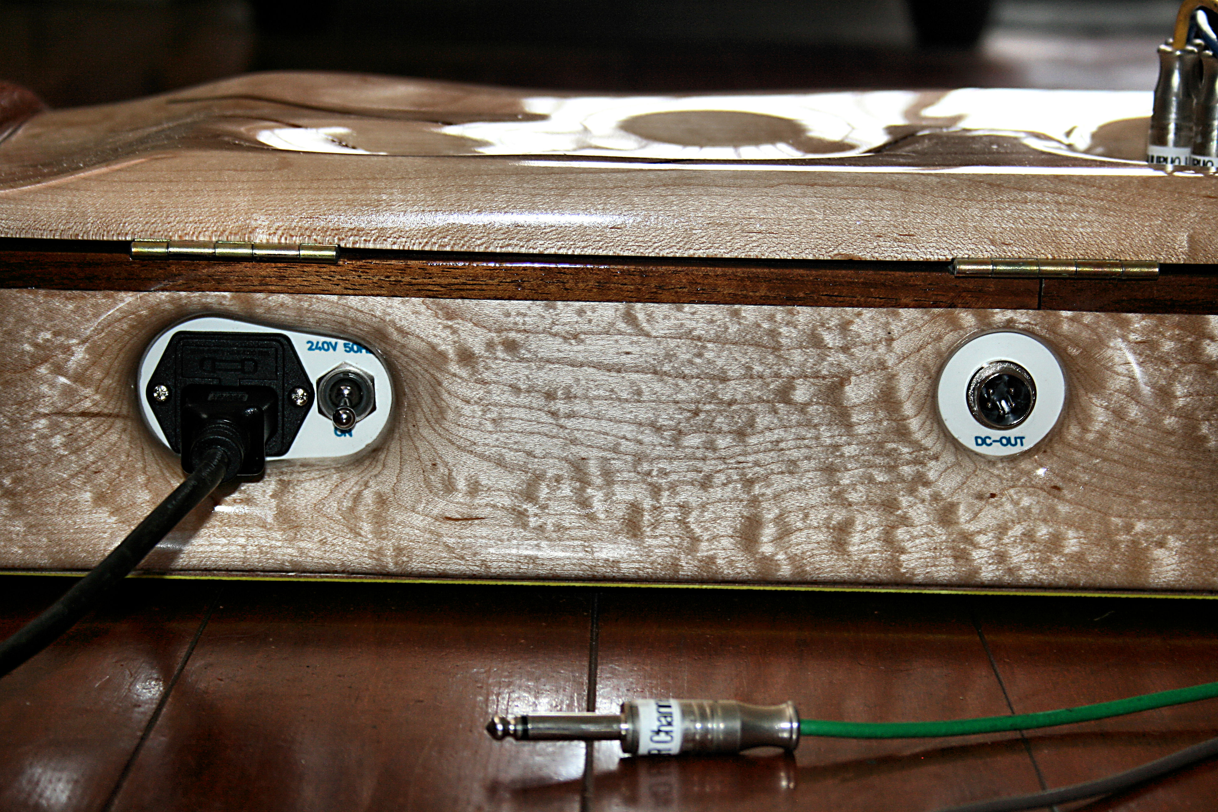

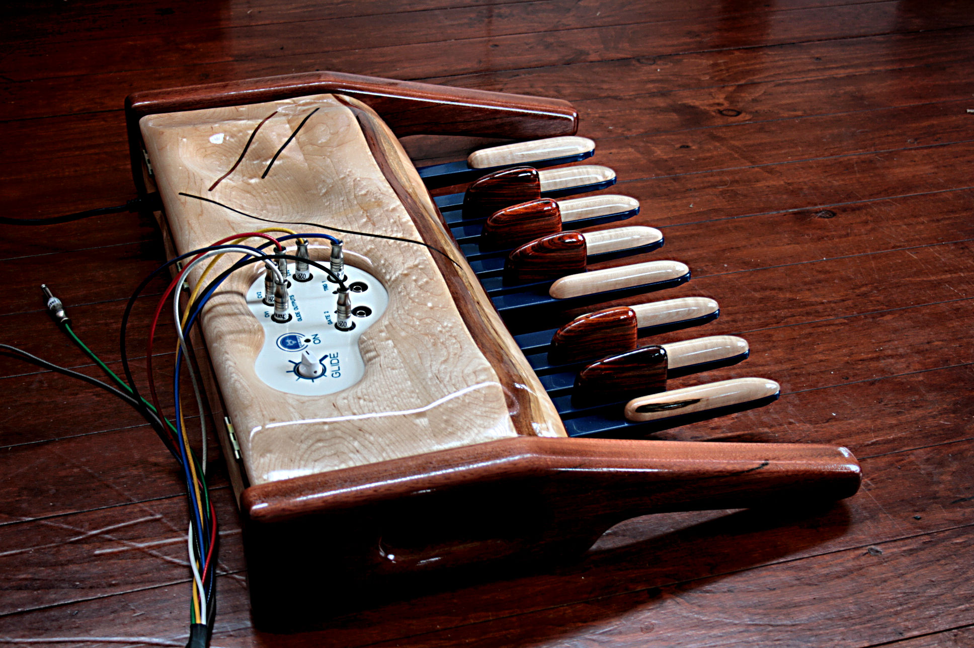

PostPosted: Sun Jan 09, 2011 12:14 am    Post subject: Reply with quote  Mark this post and the followings unread

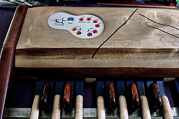

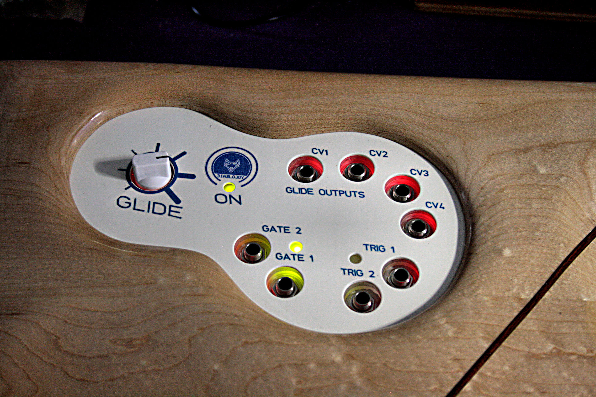

1 octave pedal board
salvaged from a home organ i got for free and then rehoused in some nice timber with a mfos single buss keyboard controller cct
timbers are figured maple , blackwood , jarrah and some cocobolo
finally completely finished something Laughing took a while

PostPosted: Sun Jan 09, 2011 11:17 am    Post subject: Reply with quote  Mark this post and the followings unread
wow! beautiful work there.

PostPosted: Sun Jan 09, 2011 11:37 am    Post subject: Reply with quote  Mark this post and the followings unread
thats a work of art dude, awesome work!

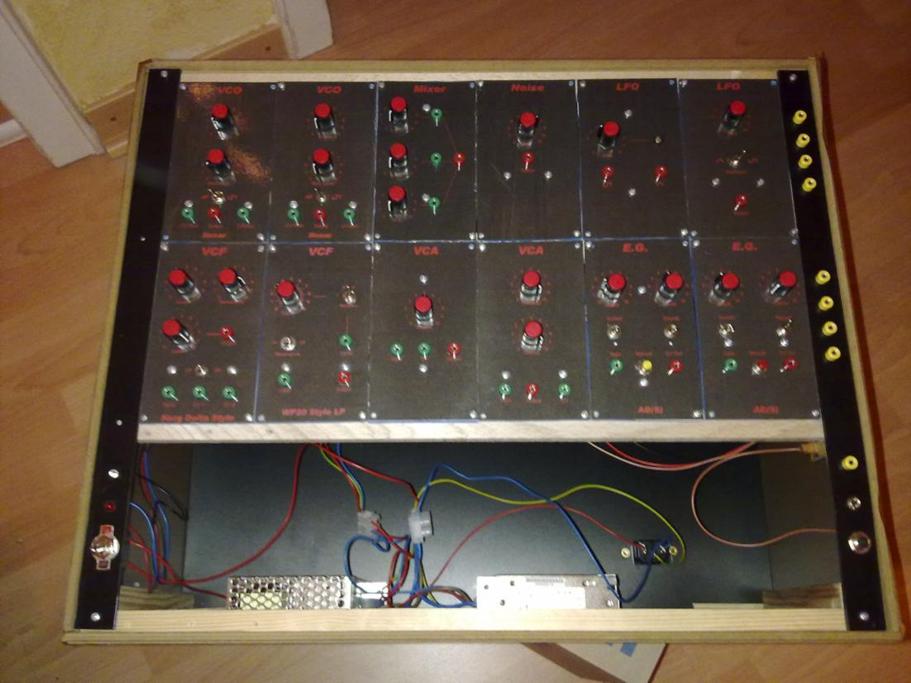

Here's what I've finished during the last year before I had to break my DIY for we're havin' a baby next month...
Most circuits are taken from Ray Wilsons WP20 Synth. Smile The VCO and the WP-20 VCF are build on stripboard. The second VCF is an EFM Korg Delta Style VCF. All modules are working fine. The case isn't pretty, but it will get a better case later on.

PostPosted: Wed Jan 12, 2011 12:34 pm    Post subject: Reply with quote  Mark this post and the followings unread
this is awesome!

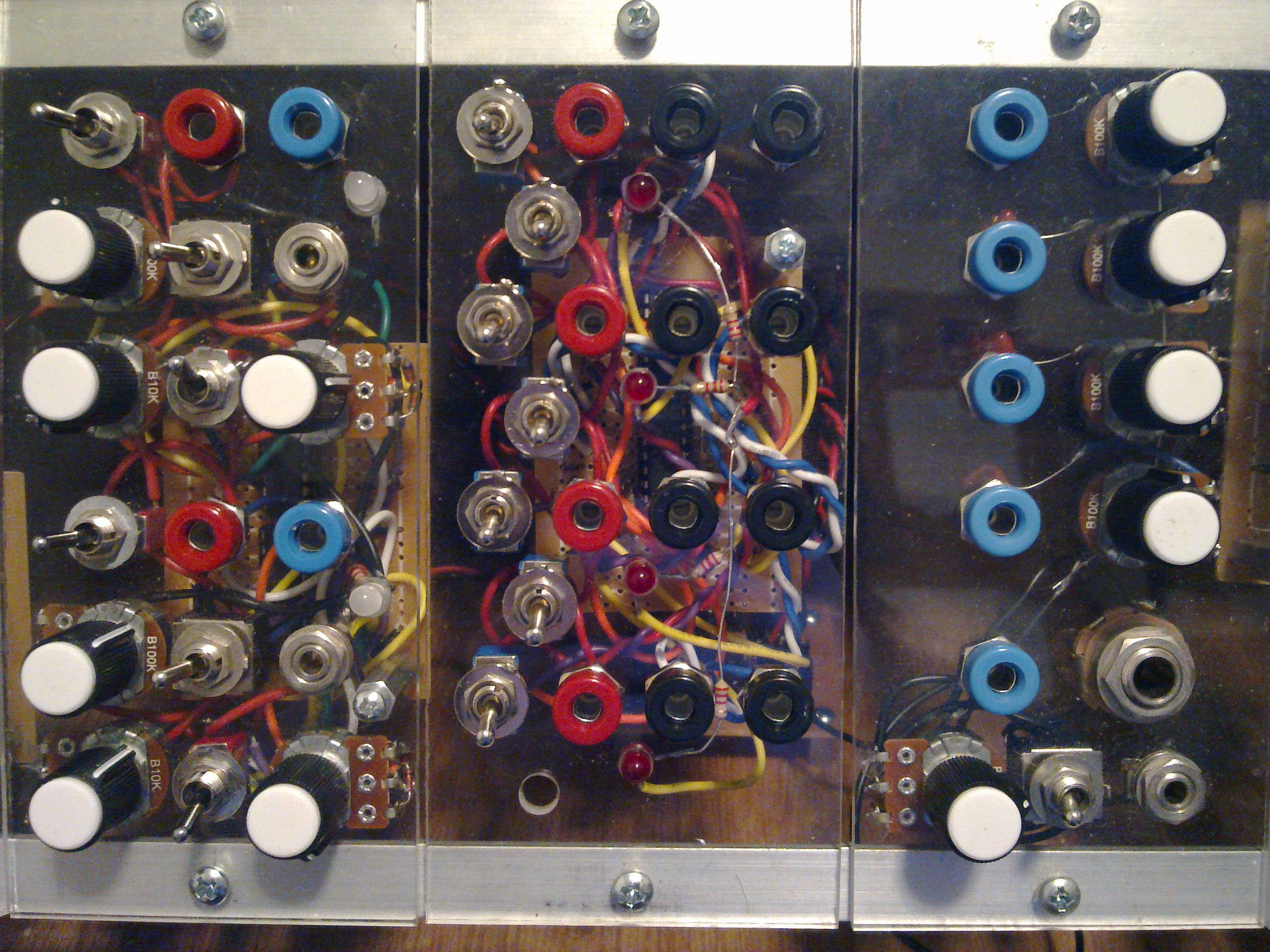

PostPosted: Wed Jan 12, 2011 8:21 pm    Post subject: Reply with quote  Mark this post and the followings unread
First three panels of the new cabinet are done.
1.A pair of splitters and the power switch/fuse/pilot lamp
2.Steiner VCF
3.Two Rene Schmitz VCAs.
I'm gonna get so good at engraving by the time I fill this cabinet.

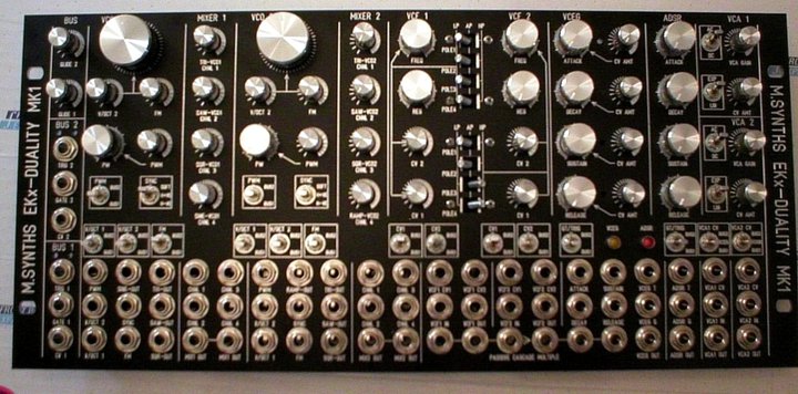

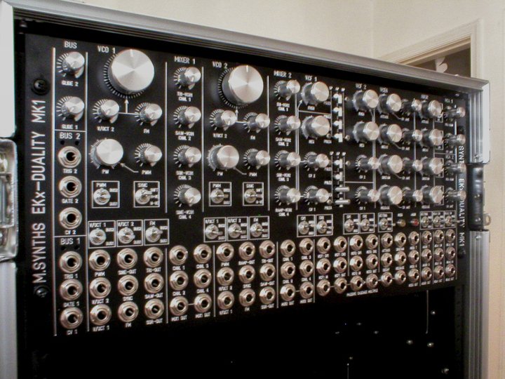

PostPosted: Fri Jan 14, 2011 9:28 am    Post subject: Reply with quote  Mark this post and the followings unread

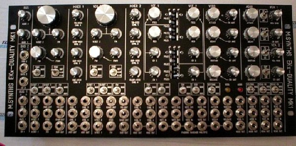

Well...OK, it's not actually built yet...but it looks like it!
Finally got my first real synth panel in yesterday and stayed up til like 1:00AM installing the hardware (some of it temporary, as I didn't pay attention to pot values, just wanted to see what it would really look like, make sure all the drill holes were correct and that I didn't accidentally place some components too close to the mounting rails...it all tested out fine).
Now all I have to do is make the PCB mounting brackets, finish the last niggling circuit corrections, calibration, testing, bug fixing...oh...and of course ALL the wiring Crying or Very sad
...my camera is a piece of sh!t...

PostPosted: Fri Jan 14, 2011 11:57 am    Post subject: Reply with quote  Mark this post and the followings unread
F
It looks awesome,congratulations
superb graphic layout

PostPosted: Fri Jan 14, 2011 1:54 pm    Post subject: Reply with quote  Mark this post and the followings unread
very good looking indeed.
but diablojoy, that's a beauty!

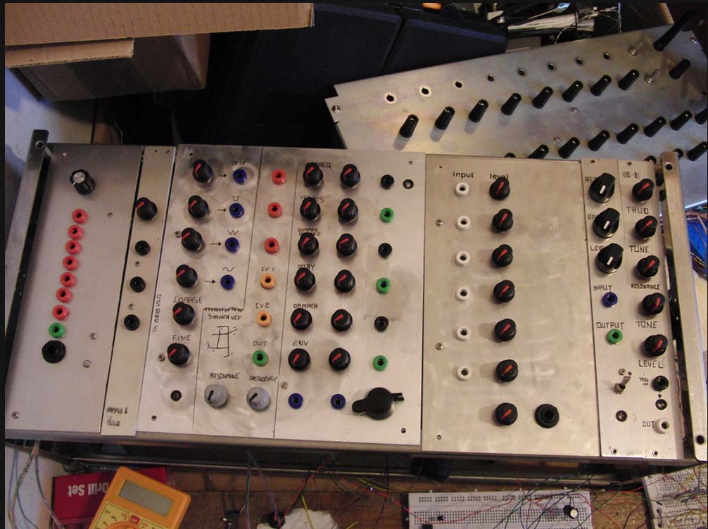

PostPosted: Sun Jan 16, 2011 1:44 am    Post subject: Reply with quote  Mark this post and the followings unread

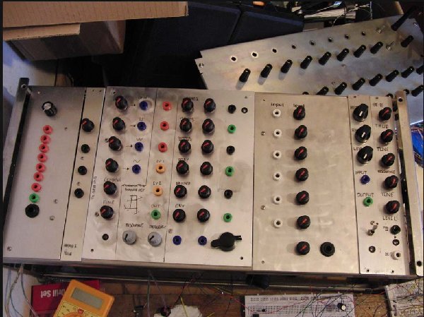

Mostly finished, modules are (left to right)
Mfos multi noise /random gate generator
mfos single chip sample and hold
thomas henry icl8038 vco
steiner synthacon filter (from the japanese guys pcb layout)
ken stones cynare cgs 47
mfos ultra simple mono mixer
belcat delay pedal (mounted onto a panel)
hip bass drum (from this forum.... sounds EXCELLENT)
still have psu to build and a little tweaking on some modules but overall its a nice rack to play with (if you'll excuse the innuendo)

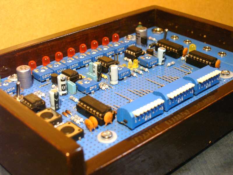

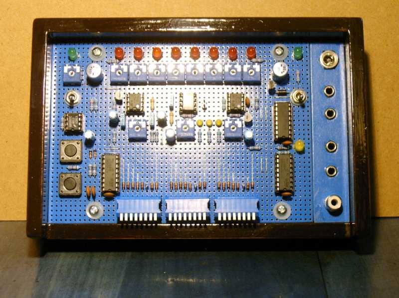

PostPosted: Mon Jan 17, 2011 5:45 am    Post subject: Smurf Sequencer
Subject description: First finished build of 2011

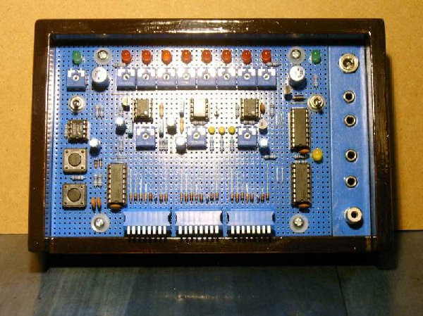

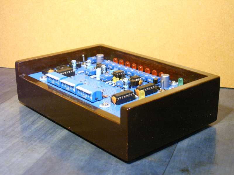

I wanted to make a simple analog sequencer for testing purposes, but as
usual I couldn't stop myself from adding a couple more things.
It has a (binary) pattern generator, a sort of glide control, a VCO
and a filter. The buttons on the left are for step control and reset, the
connectors on the right are from top to bottom:
12V DC in, ext. CLK in, int. CLK out, CV out (sequencer), CV in (VCO),
Audio Out (VCO)
Build on blue perf as a tribute to Dave's amazing blue modular bigsmurf
(that 1 octave pedal board by diablojoy looks amazing, I really like the
molten plastic/organic look)

PostPosted: Mon Jan 17, 2011 7:18 am    Post subject: Reply with quote  Mark this post and the followings unread
very cool sequencer! what are the DIP switches for? and could you explain the binary pattern generator a little bit? thanks!

PostPosted: Mon Jan 17, 2011 8:52 am    Post subject: Smurf Sequencer
Subject description: pattern generator
The DIP switches are there to set the patterns which works as follows:
The CLK signal goes to a binary puls divider (4040). 8 outputs of this divider
are connected to the DIP switches via diodes so switch 1 on DIP A,B,C has
CLk /2 connected, switch 2 of DIP A,B,C has CLk /4 connected and so on.
The other sides of the switches are shorted together (per DIP) and connected
to inputs A,B,C of an analog multiplexer (4051). The binary code on these
inputs selects which analog input is connected to the output. These inputs are
connected to the pots to set the voltage, output is connected to an opamp
that is configured as a voltage follower. hope that clears it up a bit Smile

PostPosted: Mon Jan 17, 2011 10:13 am    Post subject: Re: Smurf Sequencer
...and as a tribute to the "boys in blue" too no doubt Wink . Nice looking object!

PostPosted: Mon Jan 17, 2011 10:19 am    Post subject: Reply with quote  Mark this post and the followings unread
Thank you Phobos , that's a cool sequencer / osc / filter combo , and i love the blue colour Smile.
Dave.
(builder of blue modular).

That's a good choice / selection of modules there Bubzy , You'll be sound creating for hours with your rig Smile

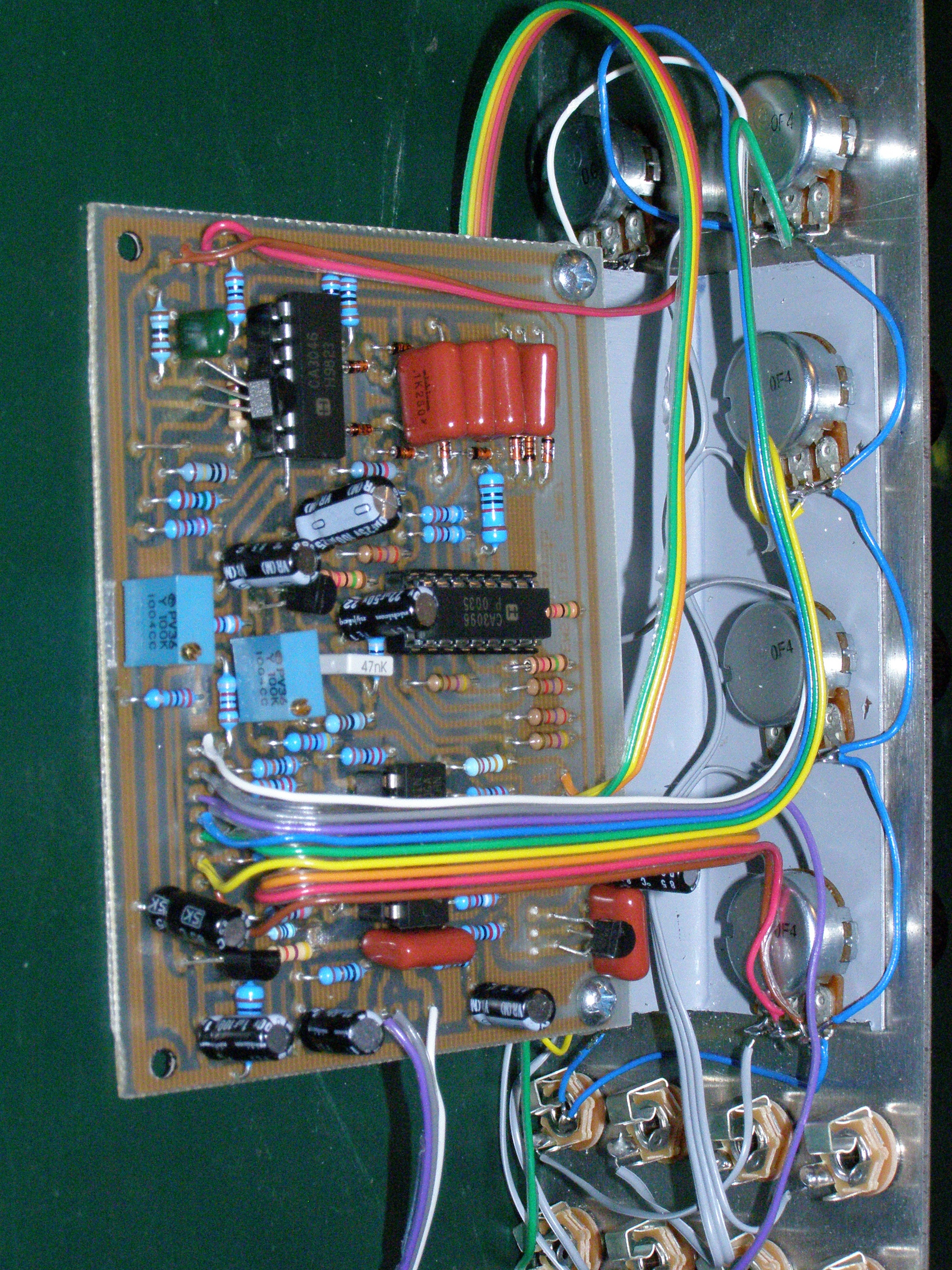

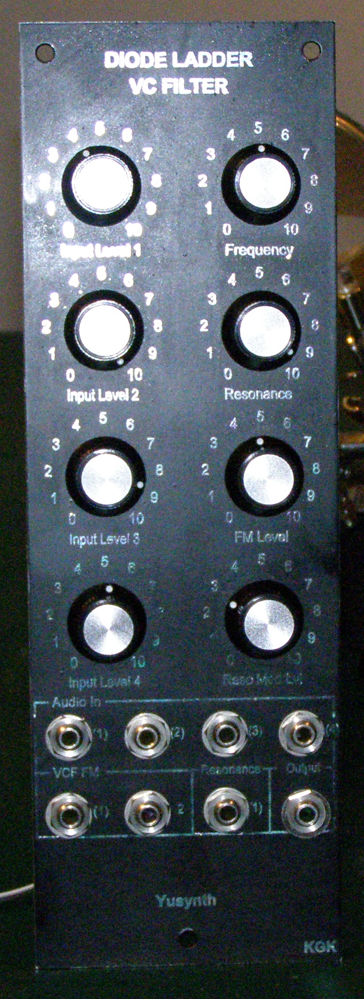

PostPosted: Mon Jan 17, 2011 4:08 pm    Post subject: A new Yusynth Diode Ladder Filter Reply with quote  Mark this post and the followings unread

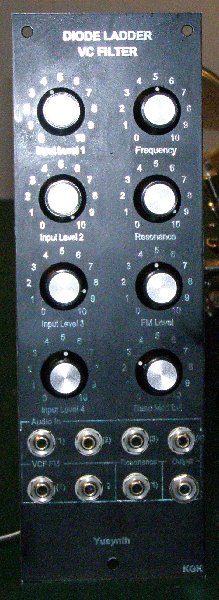

This filter is a clone of the VCS3 filter. The resonant response sounds gritty or bubbly depending on the setting of the resonance level and the input signal level.
This filter was fun to build and adds another 'flavor' to the synthesizer.
The front panel of my Yusynth Diode Ladder (VCS3 filter clone) filter with two additional audio inputs.

View of the PCB. I've switched to color-coded ribbon cable. You can see the four capacitors of the ladder on the right-top section of the PCB. The diodes surround the caps however they are so tiny that they don't show up that well in the photo.
Thank you,.. pig

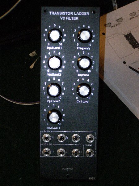

PostPosted: Tue Jan 18, 2011 9:43 pm    Post subject: Just finished a Yusynth Transistor Ladder filter
Subject description: a Minimoog filter clone
This module came to life and required no troubleshooting (**hurray!!**). I just calibrated it and that was that.
As all the other Yusynth filters that I've built, the Transistor Ladder filter is clean and musical.
Yves designed the filter to be a minimoog filter clone and its rolloff -- 24db/8ve -- is noticeably more pronounced than my Aries Multimode filters (which are 12db/8ve).
The front panel. The Yusynth design call for two inputs and I went ahead and added two additional inputs.
