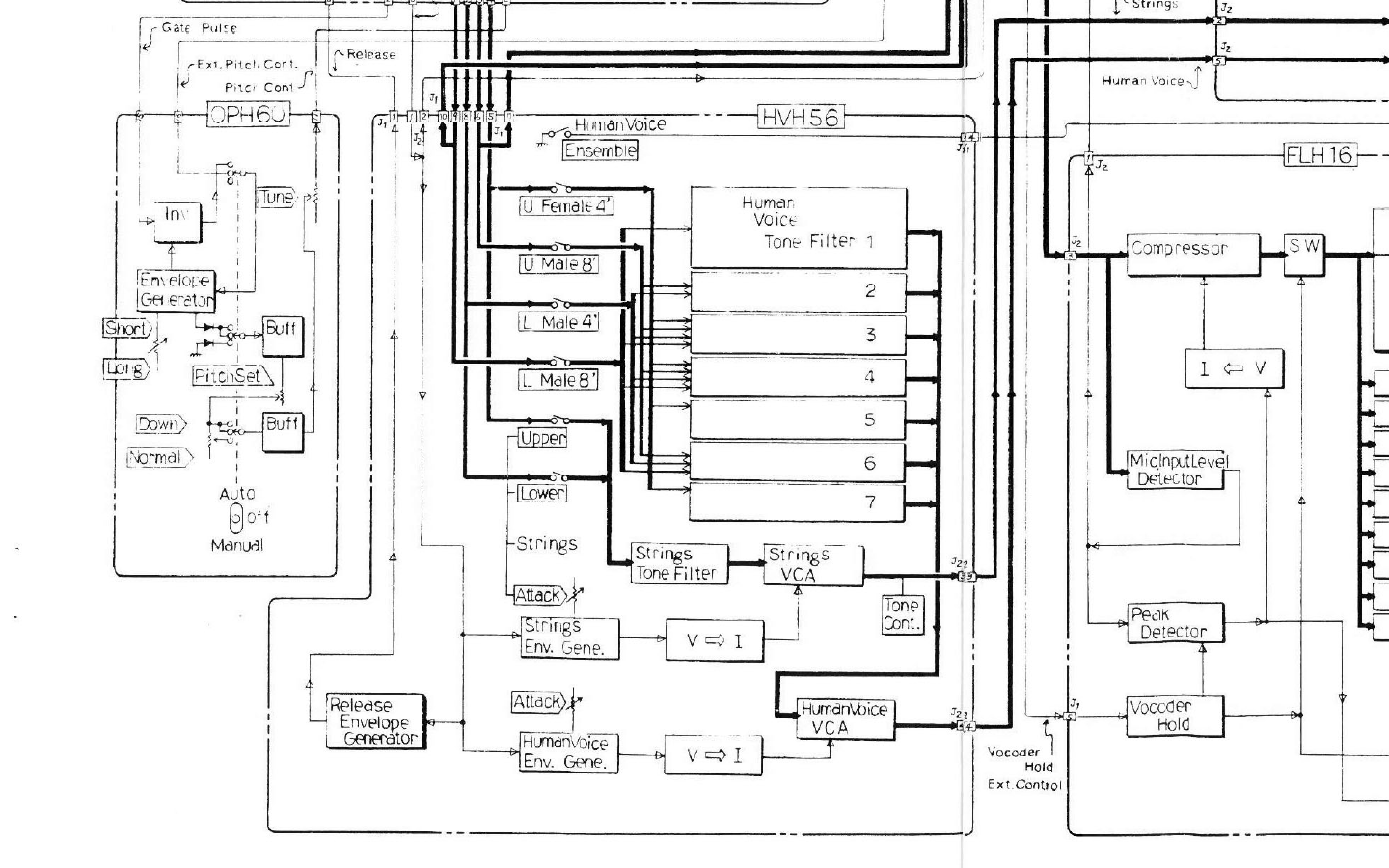

Hello all
I realized long ago the bank of vocal filters of the VP 330 as it is, but once connected on my modular, the sound was certainly saturated for reasons of impedance and level.
Is it someone would have the plans of the clone of regretted Jurgen?
Thank you (RIP Jurgen)

Hello Chok,
I looked into the 330 filter not too long ago, so I will respond with a number of images to help you on your way:
chok wrote:
Merci Yves, mais c'est l'adaptation des filtres du VP 330 que je recherche Wink
Human Voice Block diagram from Roland VP330 Service Manual

PostPosted: Sat Jun 16, 2012 11:08 pm    Post subject: Reply with quote  Mark this post and the followings unread
Hello vtl5c3
Thank you for your answer... Wink
I had already realized these filters on a veroboard deck but, during the tests, the levels were inappropriate and cells saturated.
Furthermore, I think that it would be necessary to realize circuits of input and output to be able to accept levels of high, compatible signal instrument and modular.
I also believe that these filters work in a way optimum with the signals generated by the strings section of the VP330, no?
The module of Jurgen, visible on video YouTube, connected directly on a synthesizer with a sound of strings I believe, the result is fantastic and with a chorus....

PostPosted: Sun Jun 17, 2012 2:54 am    Post subject: Reply with quote  Mark this post and the followings unread
I had redrawn the bank of filters of the VP 330. My problem is thus the adaptation of the inputs of 4 groups of filters to make only the only one. These 4 inputs result from output Upper and Lower for male and female voice, I had thought of using the principle of filters of band to be able to decompose the entering signal....

PostPosted: Sun Jun 17, 2012 8:46 am    Post subject: Reply with quote  Mark this post and the followings unread
OK, you're a lot further along than I realized. Cool
Some input and output buffers are definitely necessary if working with typical modular synth signal levels. If you look at page 13 of the VP330 service manual, the upper left corner (labeled AGH17) shows the waveforms and their amplitudes that are being fed into the Human Voice filter. The amplitudes range from 1.5 to 2.9 V p-p, so definitely lower than what most modular VCOs output. I'm guessing that you also have to add an output buffer that boosts the signal a bit.

PostPosted: Wed Jun 27, 2012 12:30 pm    Post subject: Reply with quote  Mark this post and the followings unread
I realized my autonomous version of the vocal filters of the VP 330 today.
I thus have, on the good advice given here, realized a circuit of input limiting the input signal with a resistance of 47k in serial with a potentiometer of 50k what allows to divide in minima the signal by two approximately.
I have to add a simple AOP in mixer reverser on output of filters.
Test was realized with my JX 3P, with sound of strings + chorus and that works well. I would redo a try with a chorus connected after the filters as on the VP...
