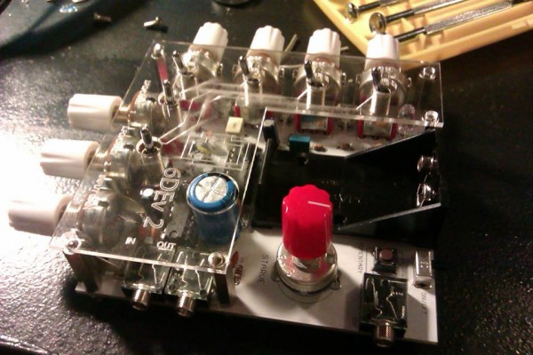

By the way.... We made a new version of our circuit. Still based in cacophonator but with slight changes: Frequency modulation and Mute for each oscillator. And looks GORGEROUS Rolling Eyes

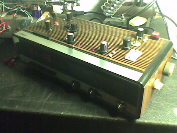

I thought I'd share my take on the Cacophonator… It's a somewhat upgraded version with switches to allow chain sync between oscs, contact points (or whatever you call them), an LDR for kicks and also the possibility to somehow sync osc#1 to an external signal or… the sound of the radio.
Because, yes it's build in an (otherwise fully functional) alarm clock. Of course you can also use the internal speaker for a nomadic use… but wait! err it works on the mains! Oh well.
Bonuses: once you plug and start to play, the display will show you how long you've been messing with the thang. Alternatively you can program the 'sleep' function if you want to play, say 34 minutes and forget about time. It'll shut off from itself. How cool is that? How useless also?
It also looks miserable. Let's say it's a whole concept, eheh. Should I mention that it's exclusively made out of salvaged parts? (well the 40106 was new)
Anyway, here's a pic - ©crappy cellphone - and a couple sound clips…

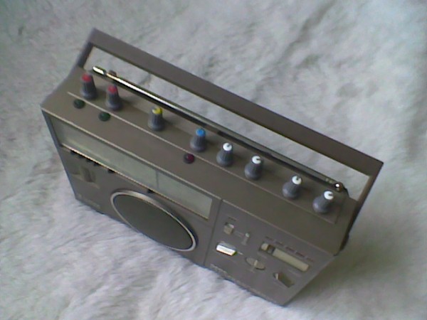

One more cacophonator variation in a radio, this time providing heavy interaction with the radio signal…
