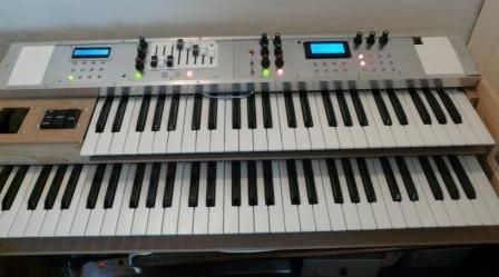

I have just finished this double keyboard using four DB50XG cards. Two are used to provide an 8 drawbar organ sine or sawtooth (QS300 voices) controlled by one 18F452 (left panel) with the board internal effects for a C3 type chorus and 7 presets. The other two boards are for piano and synth sounds controlled by a second 18F452. The kb's are old Fatar boards from ebay.

PostPosted: Fri Feb 25, 2011 1:11 pm    Post subject: Reply with quote  Mark this post and the followings unread
Welcome to the E-M Forum, Quintus! welcome
Nice job on the double keyboard!
Would you be willing to share some details on your 18F452's (features, source code, etc.)?

Quintus
Joined: Feb 20, 2011
Posts: 13
PostPosted: Fri Feb 25, 2011 3:59 pm    Post subject: Reply with quote  Mark this post and the followings unread
Dan
Thank you
I will try and print out a circuit over the weekend. I have just started to "tidy up" the .asm file for the code. At first it will be for a simple version.

1. Could you explain why two db50XG voice boards are used?
2. One quick thing you might want to add is a percussion selection switch and have a marimba voice on an unused channel switched in. I've done that on my MU90 in performance mode. Maybe that's a little too cheesy for you?
Synth DIY since 1977!
Quintus
Posts: 13
PostPosted: Sun Feb 27, 2011 1:18 pm    Post subject: Reply with quote  Mark this post and the followings unread
Each footage of the organ is one voice ie one element therefore each DB50 has eight note polyphony (32/4). I tried it with one module to start with and there was a lot of note stealing. If I remember correctly the MU90 is 64 note poly. Yes! I am working on the 2 2/3 percussion but it triggers every note not first as in the Hammond.

here is my editor for DB50
thank you 'and my friend Peter BROWN
All parameters MIDI Edit
QS300 sounds are stored in memories
+ 8 to 8 channels on potentntiometres
http://img189.imageshack.us/i/editeurdb50.jpg/
wow Raoulblues! That's great! well done A couple people have asked about such an interface. Is it possible to share your work with the group? (schematic, code, overview, etc.)?
raoulblues
Joined: Oct 31, 2007
Posts: 16
Location: paris france
PostPosted: Wed Mar 02, 2011 1:43 am    Post subject: Reply with quote  Mark this post and the followings unread
Je vais repondre en français c'est plus facile pour moi
Ce systeme fonctionne grâce a mon ami Pierre Brun qui a écrit tout le code sur la base "midibox"
Le materiel
Voir" midibox "
1 core
1 din
1 dout
Afficheur 4x40
8 24lc512"bankstik "
1 pavé numerique
16 encodeurs avec poussoir
8 potentiometres
Ci joint le mode d'emploi
Les bancksticks sont programmées avec les sons de "qs300" trouvés sur internet
je reste a disposition pour d'autres information
MANUEL MIDIBOX DB50 28 7 2008 word normal.doc
 Filename:  MANUEL MIDIBOX DB50 28 7 2008 word normal.doc
 Filesize:  3.2 MB
 Downloaded:  1129 Time(s)
