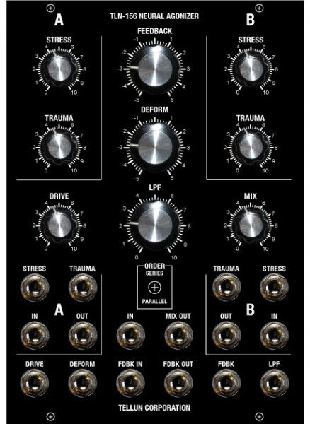

PostPosted: Thu Nov 15, 2012 10:12 am    Post subject: TLN-156 Neural Agonizer Panel Layout MU Reply with quote  Mark this post and the followings unread
Hey,
Here's my 5u Moog panel layout - thought I'd share it, and maybe get some feedback. Feel free to use as you need it. I've put the Hi-Res PDF, the original Illustrator CS3 file, and a JPEG.

PostPosted: Thu Nov 15, 2012 11:07 am    Post subject: Reply with quote  Mark this post and the followings unread
Very nice! After using mine for a few years I'd suggest grouping the feedback and LPF knobs together, and put the deform knob up on top - switching the deform and feedback knobs. The feedback and LPF knobs kind of work together. No ideas on your electrical issues - does the thing work otherwise?

PostPosted: Fri Nov 16, 2012 8:43 am    Post subject: Reply with quote  Mark this post and the followings unread
Thanks sduck - that's some good advice; I haven't finished building it yet so had to guess which knobs would be the most important for twiddling!
Think I haven't finished building it yet so gonna put it together this weekend and see how it sounds - can't wait to hear the springy drones!
