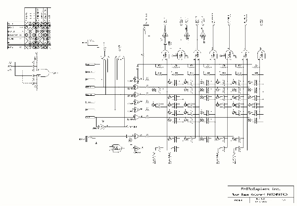

yesterday I wired up the patchmatrix, which actually went quicker then I expected, and mounting the PCB turned out too be pretty easy too Very Happy
I only had time for a short test, and allthough it seemed to be working (without any smoke) I noticed 3 problems.
The first problem was that AD/AR generator 1 sometimes doesn't work. I had noticed this before I installed the patchmatrix and tested all the
modules. But I thought I solved it after removing a bit of solder, so I guess that wasn't it. The fact that it's an intermittent problem makes
it hard to find, but maybe it's just a bad chip (it worked before though). So I'll try replacing it and see if that helps.
The second problem was that I got some weird behaviour from the patchmatrix. For instance when I patched the PWLFO to OSC I, not only did OSC
get triggered but AD/AR 1, AD/AR 2 and the random generator aswell. And this happened with several combination but not in a way that some things
could be shorted, And everything seems to be wired up in the correct order.
The third problem was that it produces absolutly no sound,. no buzzing either so that's a plus. But the fact that it's silent makes me think
it might be something very simple like a connection on the PCB I forgot, or maybe just a bad cable going to the output jack. I did try
listening to all the outputs using the patchmatrix, and that works as expected.
I just had some time to do more testing to see if I could figure out what's wrong with the patchmatrix. Since the inputs of all the
modules are directly connected to the outputs of CMOS gates then whatever is causing it is having an effect on those gates, either on the
inputs or through the power (or internal). When the inputs aren't patched up they should get pulled to a low state, which is why a used a 47K
pulldown and 100K pullup resistor. So I decided to do some measurements:
On the inputs that are directly connected to the 47K pulldown resistor I measured 3.58V and on the other inputs, connected to the 100K
pullup and through the diodes to the 47K pulldown resistor, I measured 4.38V.
So I had a look at the datasheet and for the chip I used (ST Microelectronics HCF4081) it states that the maximum low level voltage is
3V @ 10V Vdd and 4V @ 15V Vdd, so with a voltage of 12V it should be somewhere in between. The 3.58V might just do but the 4.38 is too high and
could cause problems. So I made some new calculations setting the max voltage at 3V and for that I had to replace the 100K pullup resistors with
200K ones. I just did another test, and now the patchmatrix works perfect Laughing no more false triggering and the AND function when patching more
outputs to one input works too. Also the connectors might not be so bad afterall, as I mentioned they don't really fit, but do just make contact
when just slightly pushed on, which also makes them easy to remove.
I'm going to try another chip in the ADAR generator now to see if that helps, and I hope to solve the audio problem in the next 2 days, or else in
the weekend. (I want to have it fully working before the end of the year Cool)
the Moon Base Xplorer: updated patchmatrix schematic

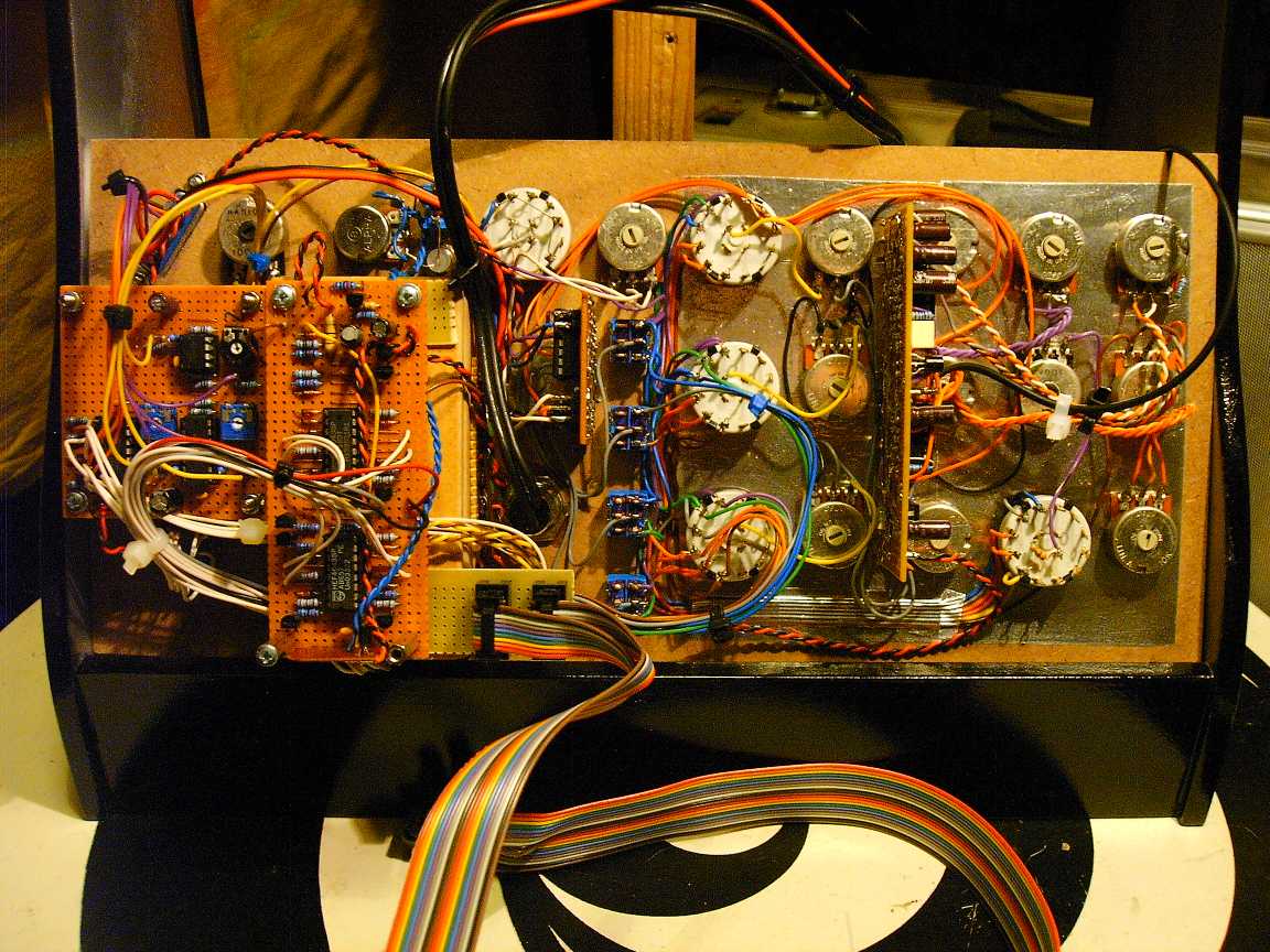

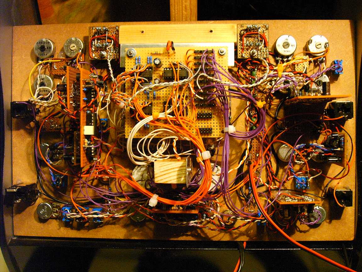

Posts: 5873
PostPosted: Wed Dec 25, 2013 6:03 pm    Post subject: the Moon Base Xplorer
Subject description: wiring pics
some photo's of the wiring on the backside of the panels. I'm out of small cable ties so the big panel is a bit of a mess,. allthough it will probably not
make a whole lot of a difference.

Dude...is this some kind of d.i.y. marathon? Laughing
I'm out of small cable ties so the big panel is a bit of a mess...
I use insulated solid wire as twist-ties.
