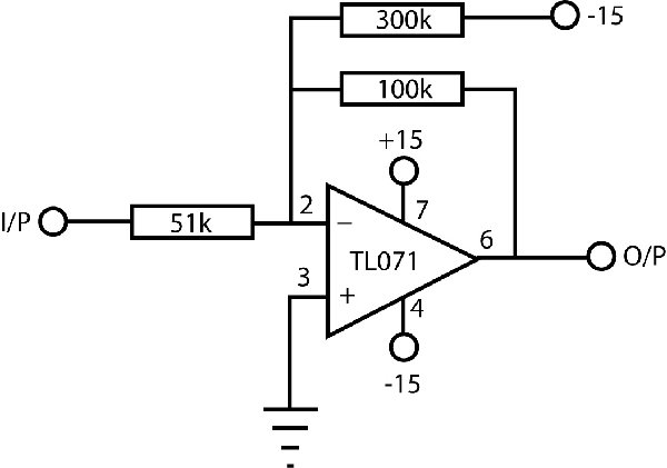

Yay!!! I tested my Dual Oddy VCO just now and it sounds fantastic and tracks great (I used a 2k tempco from MFOS).
I remember reading hear that the outputs of this circuit are 5v p to p, right?
When I put it through my Buchla 291, the signal was very low. I'm guessing the 291 wants 10v p to p.
How do we increase the signal of the Oddy VCO? Is there a resistor that can be replaced or something?
PS--Andy, thanks so much for this project. This is by far my favorite VCO!!!

Congratulations! Have you got any photos of the front panel? I'd be interested to see how you've laid it out.
I've been trying to figure out how to do this, as well as centering the output around 0, but unfortunately I'm a bit out of my depth when it comes to these things! I've been reading up about DC offsets and amplification but I'm a bit lost when it comes to implementing. If anyone has any ideas then I'd be really grateful too!
Oh yes, don't forget that the square is 0-5v with the saw being 0-6v.
Hi Eric,
I think this is what you want. I've lifted this from Thomas Henry's Build a Better Music Synthesizer - it's from his CEM VCO design. He used it on the Triangle output (which is also 0-5v PP) to convert it to 10v PP centered around zero.
I haven't tested it, but in theory it should be fine.
BTW, I've just taken a look at the 4023 VCF PCB foil I posted... definitely the same version as I've used to build my own VCF's. I wish I could be more help - could you PM some high rez images of your board to me, I'll see what I can do.
Andy.

Andy, thanks so much for that! Being a bit of a beginner, I've had a hard time figuring out how to do that!
If I wanted to use that on the saw output (which is 0-6v), would it just be a case of changing the value of the 100K feedback resistor?
Yes, I'd change the 100k resistor for a 51k and then follow it with a 50k trimmer to allow the voltage to be adjusted back down to 10v PP.
You may find that it's not *exactly* centered around zero, though it'll probably be fine for general use - otherwise I *think* you would need to change the value of the 300k resistor slightly.

PostPosted: Thu Jan 08, 2009 12:01 pm    Post subject: Reply with quote  Mark this post and the followings unread
Andy, you're the best!! I'll give this a shot tonight-- I'll post my findings.
