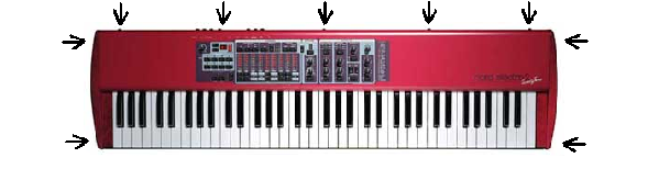

4 Using a Phillips screwdriver remove:
* the two large screws at the bottom of the synth, right underneath the ModWheel and halfway the synth (the rest keeps the boards and keyboard attached to the bottom,
* the four (sometimes three or five) screws on the back of the (red) hood,
* the two screws at the front of the sides and only loosen the two with the washer (see picture) and leave these in place: they keep the hood fixed to the bottom of the synth, so you don't have to disconnect any inside cables!
5 Open the hood...
(Using two hands at the front corners of the red hood while slowly lifting it)
Screw at the back of the side panel.

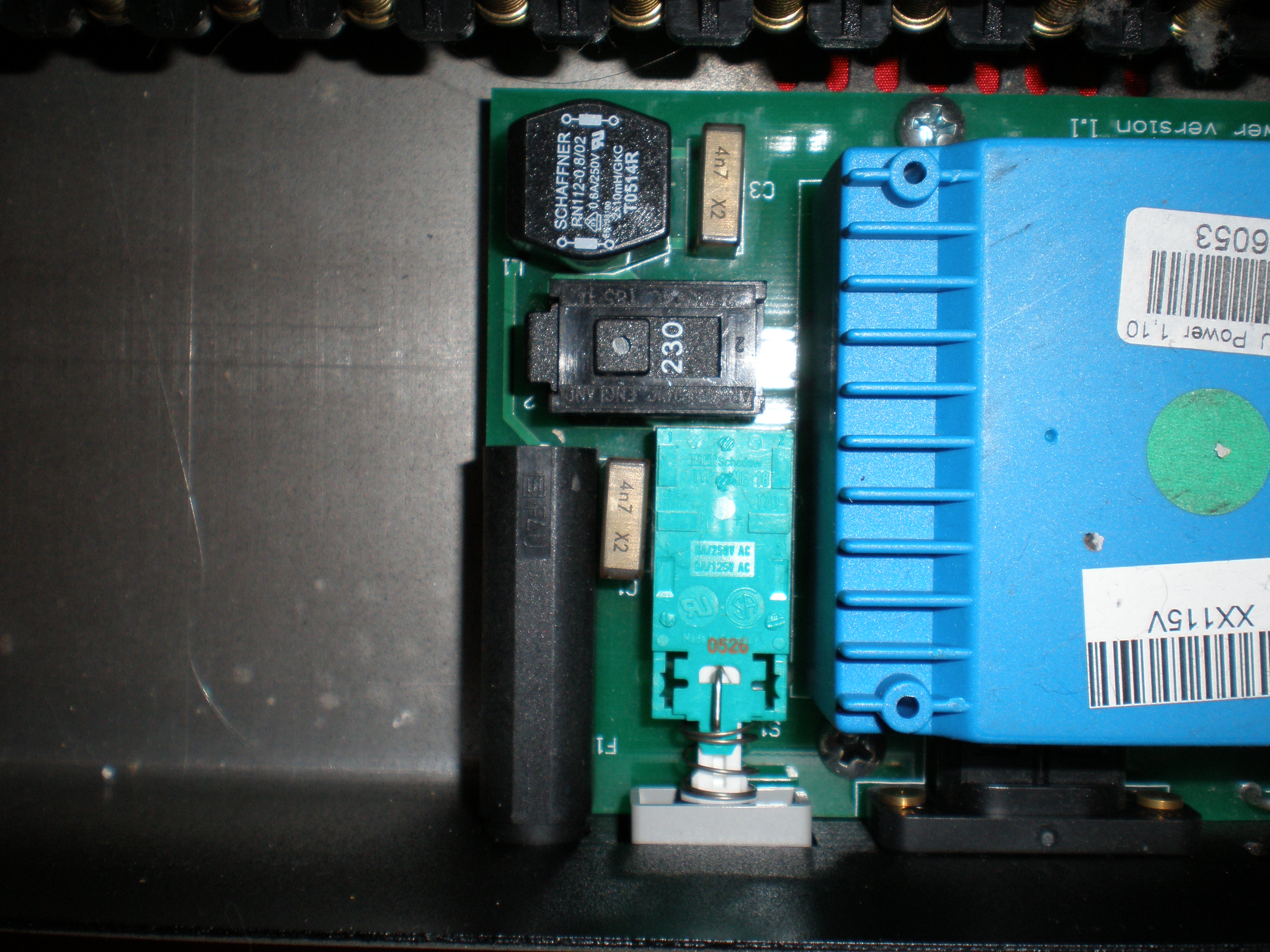

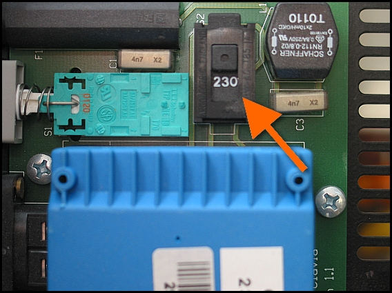

PostPosted: Thu Oct 23, 2008 7:20 am    Post subject: 110-115V to 220-230V or visa versa
Subject description: Synths after 2000
If you have a NordRack2X, NordLead2X, NordRack3, NordLead3, Nord Modular G2, Nord Modular G2X, Nord Modular Engine or a Nord Wave:
You probably see the switch marked 230 or 115! Just switch this to the right value (or not if is already in the right position) and read the next posts!!!
Synths since 2000
 Filesize:  211.04 KB
 Viewed:  107394 Time(s)

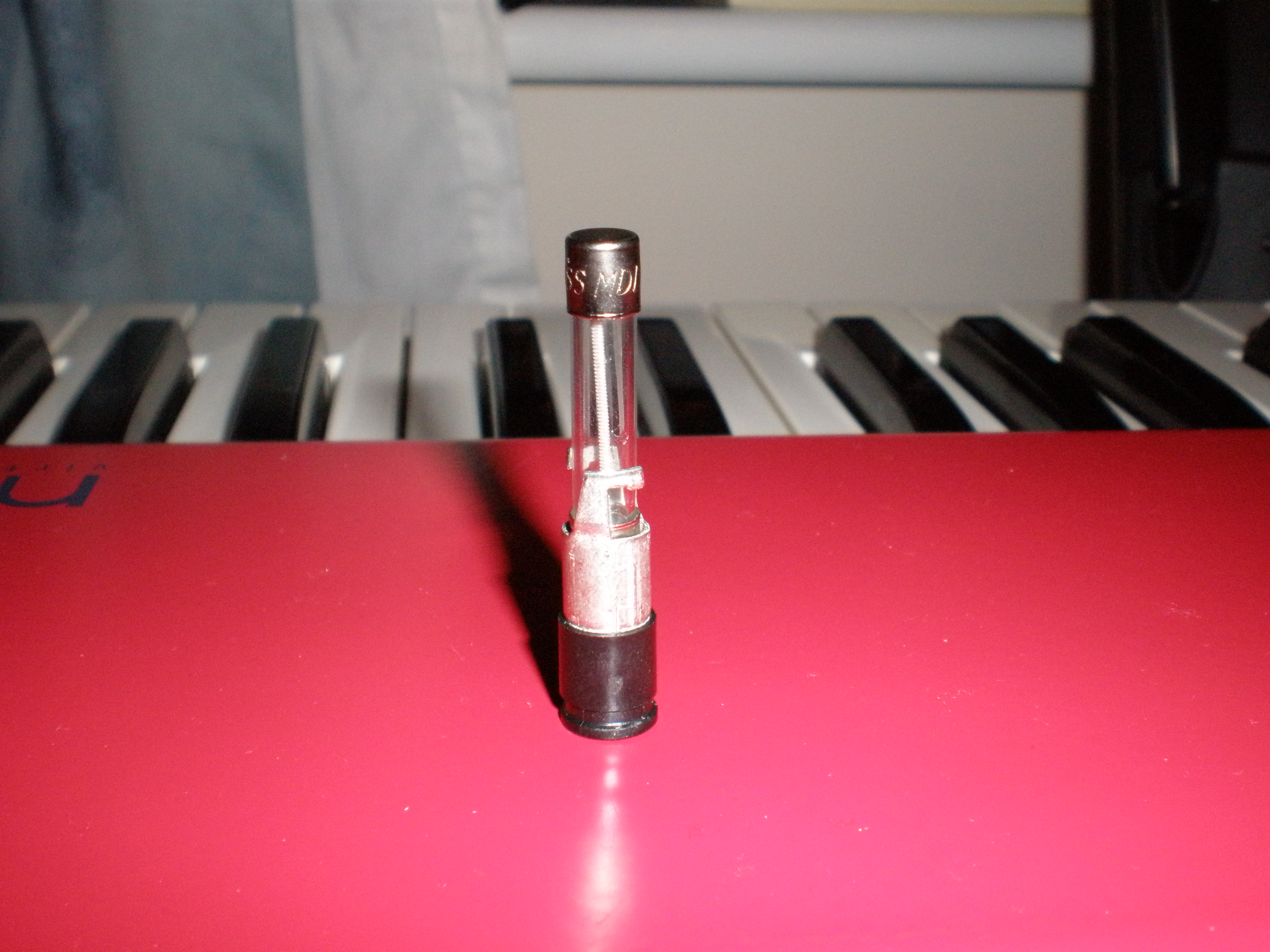

The fuse has to be changed too.
At the left of the On/Off switch is a screw, which closes the fuse holder. (See picture) Unscrew this gently (anti-clockwise), because there's a spring inside which can launch what's inside the tube. Replace the fuse itself, using the next values:
    Until the year 2000
    115/125V 200mA (300mA?)
    or
    230/250V 100mA
    Since the year 2000
    115/125V 250mA
    or
    230/250V 125mA
Close the holder.

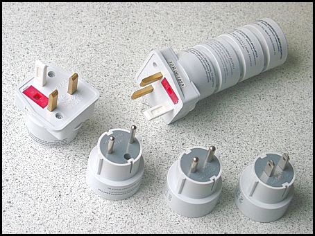

Connect all cables again...
When your power cord doesn't fit the wall connector, maybe conversions plugs can help. These are mostly available in any 'radio-shack' and the good camping equipment stores. Beware, these plugs are mostly not grounded! (See picture) These ones allow to plug in the European (Clavia) connector into another standard, so you don't have to change the cord. I use these when gigging abroad.
If you are handy, just cut away the plug and attach a new one which will fit Smile
Success!

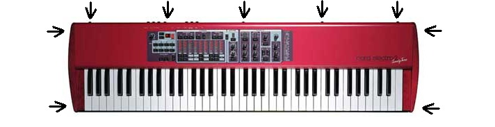

To open the case:
Remove the 9 screws along the edges (pictured).
Remove the 2 remaining screws underneath (not pictured). These are the only two screws not in line with others.
Take care not to damage the screw heads.
Carefully raise the top of the keyboard, holding at the sides. Pivot as if hinged at the back of the board.
Special care should be taken not to damage the ribbon cable connecting the cover to the circuits inside.
11 screws total - all Phillips head.

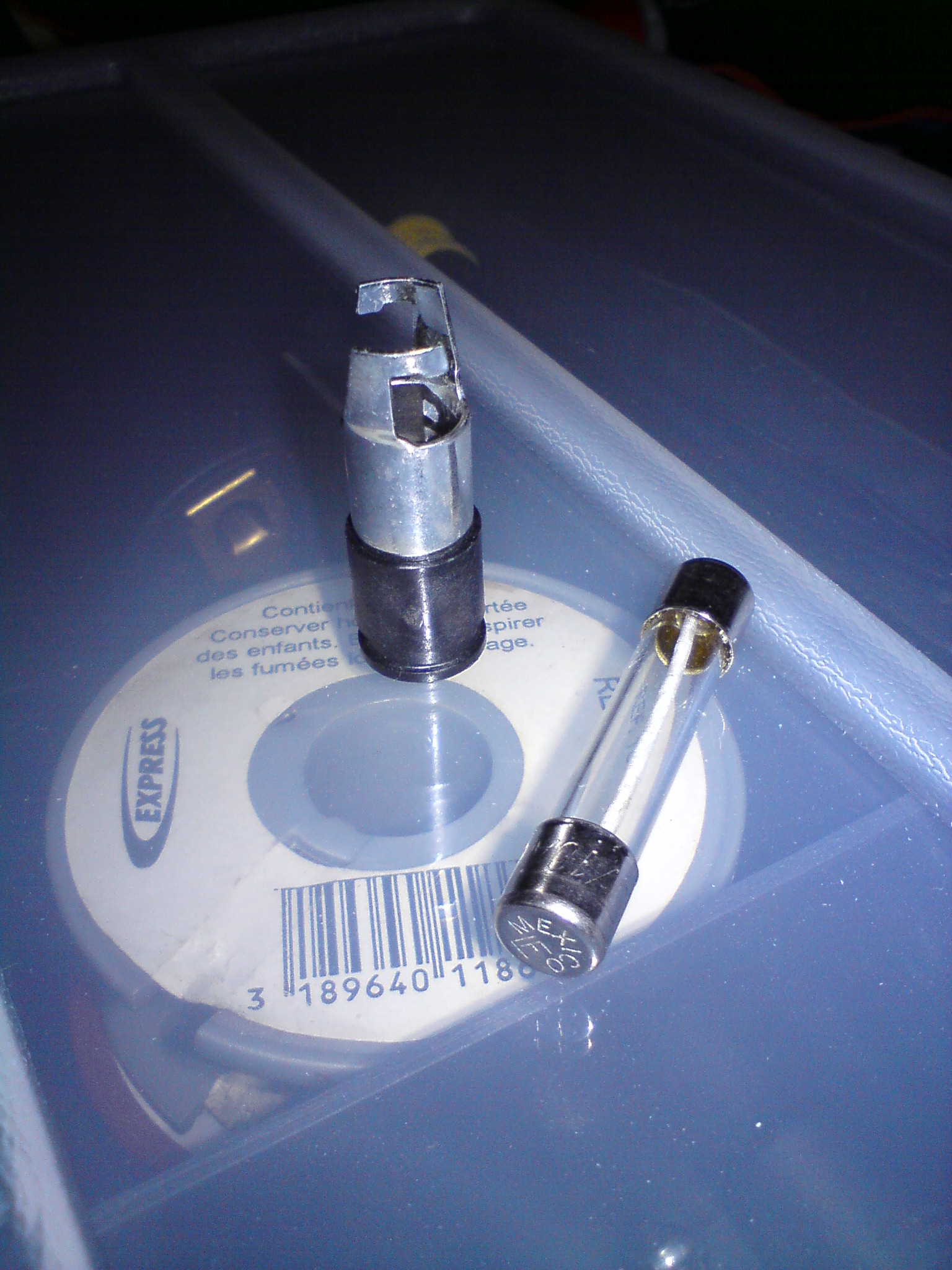

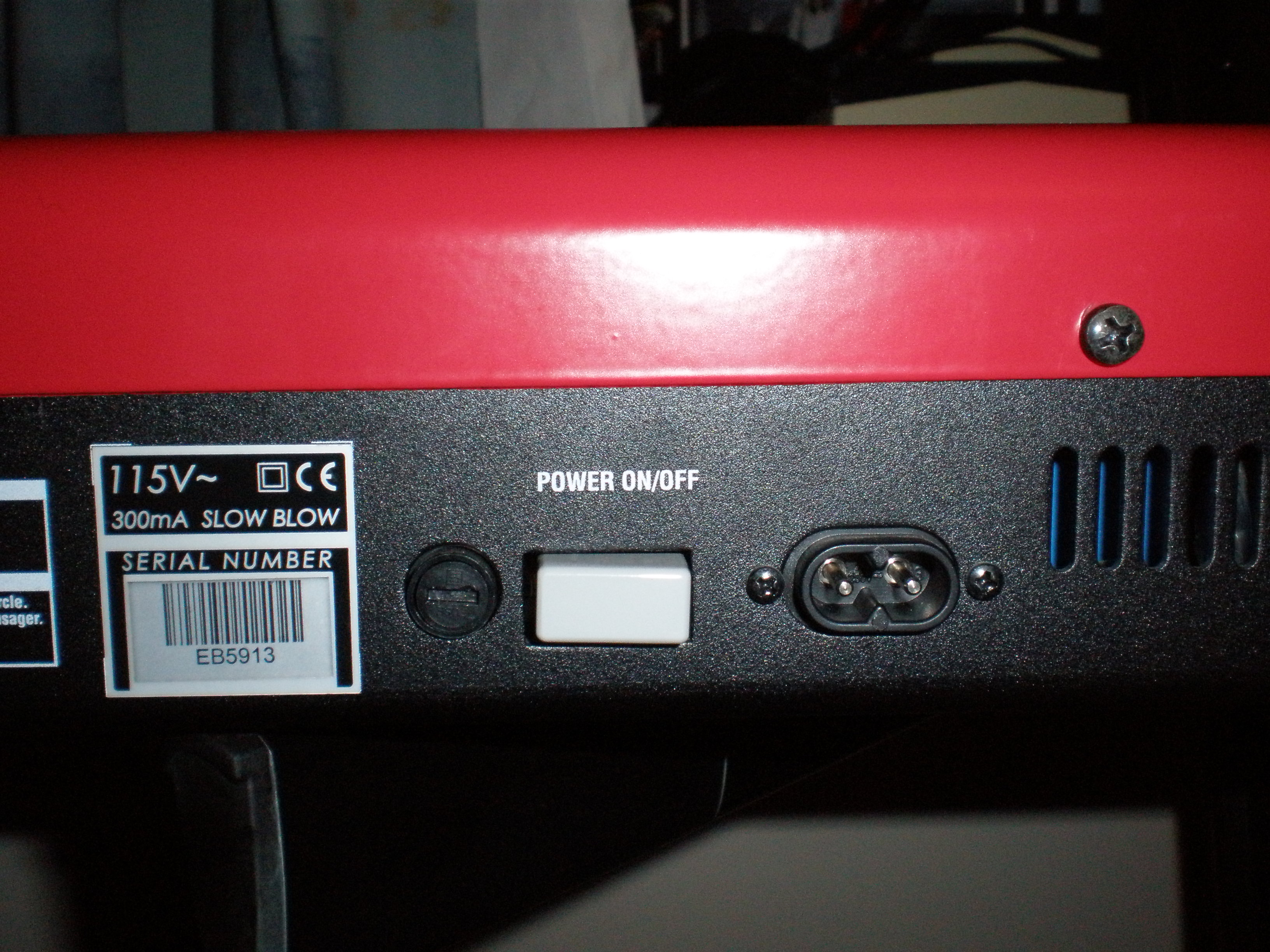

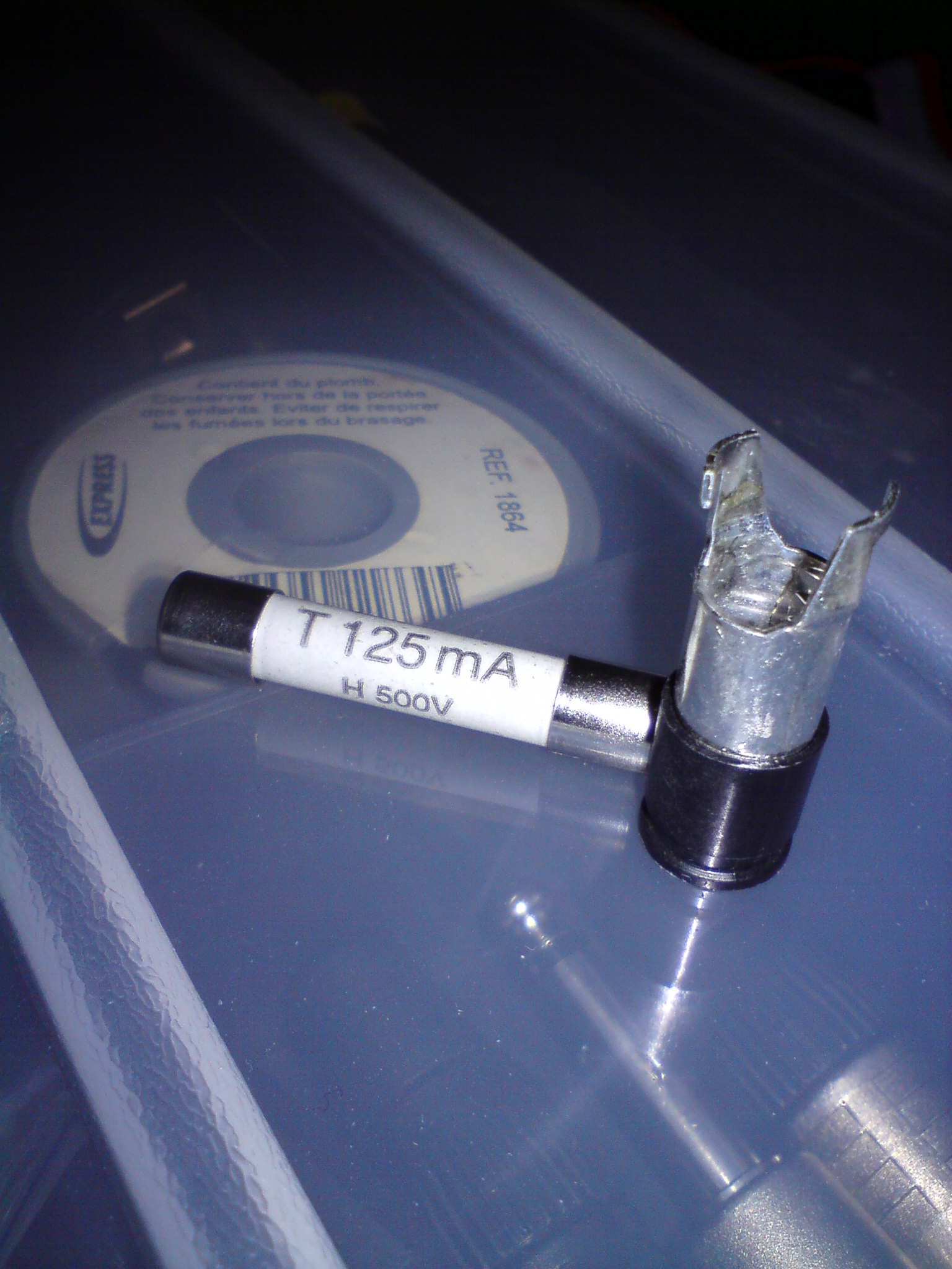

Replacing the fuse:
Locate the fuse holder on the back of the keyboard, just left of the power switch - see picture.
Using a flat head screwdriver, gently open the fuse holder: a fraction of a turn should release the holder, which can then be removed.
For this conversion (115V to 230V) the old fuse (250mA) must be replaced with one rated for half the current (125mA).
The Electro 2 takes 1¼" (31mm) fuses, see picture below.
I had trouble locating the fuses, so I had to order online, leaving me with 9 more than I needed Rolling Eyes .
If you have the same trouble, pm me and I'll post you one. Smile
And it may seem stupid, but glass fuses will break if you're careless.
I found that out the hard way when I dropped one on a tiled floor mad, short circuit
Anyway, replace your fuse and you're ready to switch voltages inside the board.

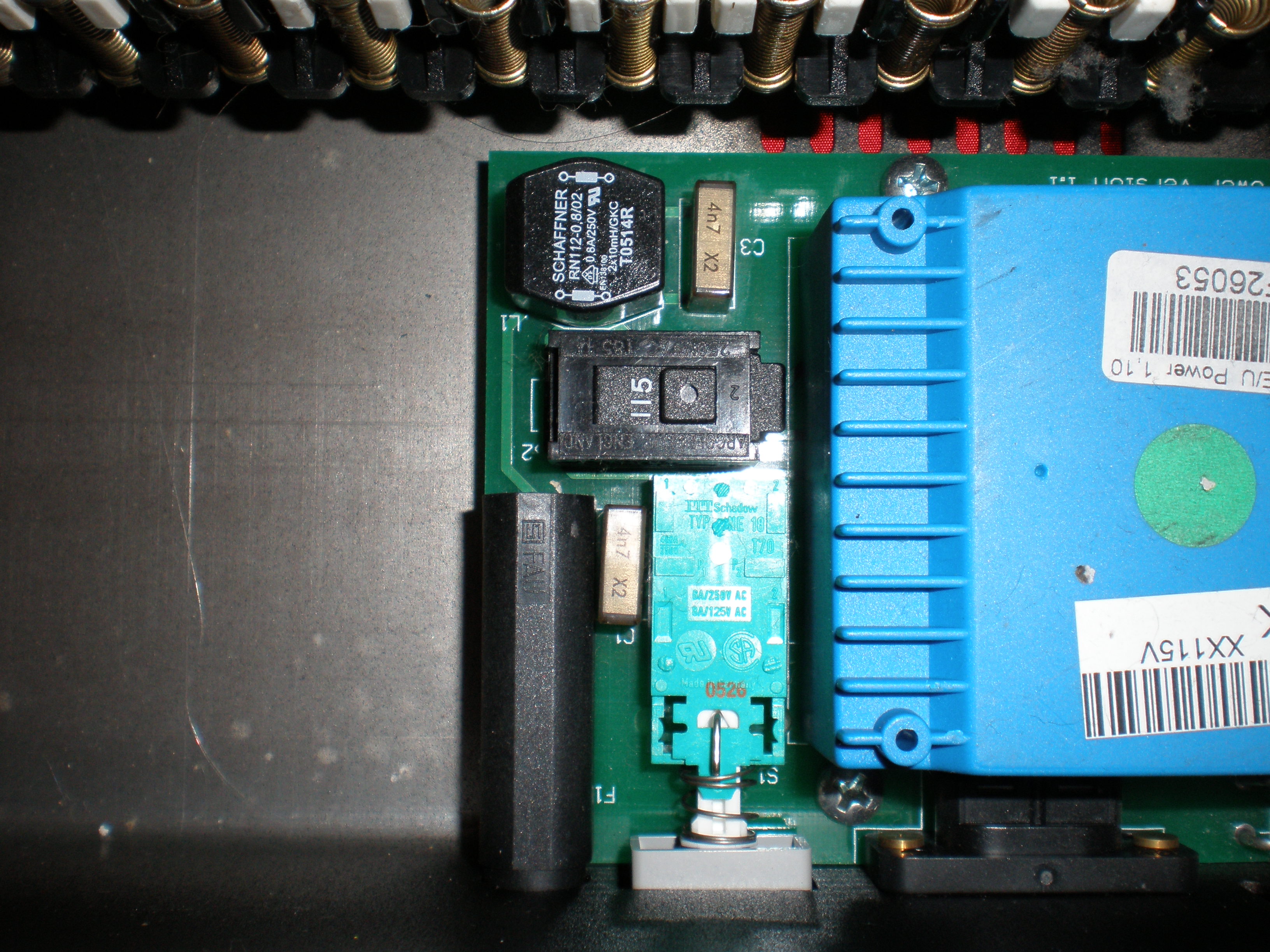

PostPosted: Mon Feb 09, 2009 4:34 am    Post subject: 110-115V to 220-230V Reply with quote  Mark this post and the followings unread

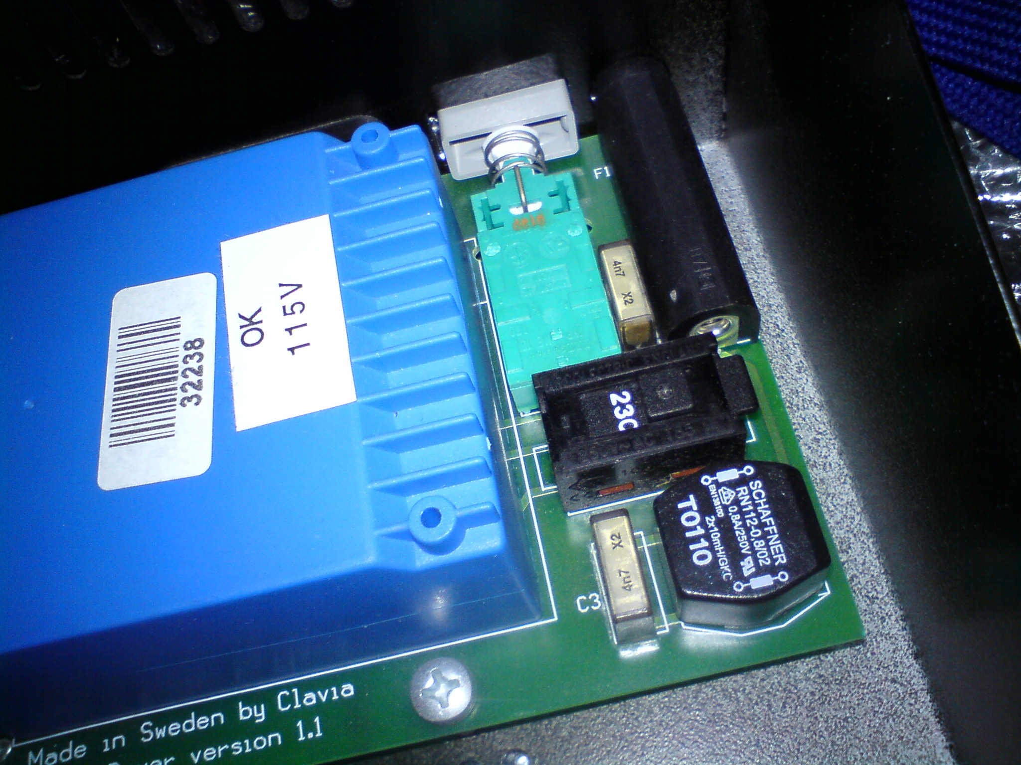

Switching voltages.
Locate the onboard switch beside the black plastic fuse-housing - see picture.
Flick the switch from 115V to 230V!
Couldn't be easier, and much respect to Clavia for including the voltage switch.
This done, it's time to close up the case.
I found it easiest to replace the 5 at the back first, followed by the 4 end screws, then tackle the underside.
Now you have a complete Nord once again.
Time to sort out your power cable.
Before!
 Filesize:  1.57 MB
 Viewed:  1493 Time(s)
After!
 Filesize:  1.56 MB
 Viewed:  1418 Time(s)
Praise the Nord
Joined: Jan 29, 2009
Posts: 4
Location: (in loco parentheses)
PostPosted: Mon Feb 09, 2009 4:42 am    Post subject: 110-115V to 220-230V Reply with quote  Mark this post and the followings unread
If you prefer using a U.S.-to-U.K. converter, simply plug in your cable and off you go!
If, however, you don't mind cutting the cord and you've elected to go the permanent route, bear in mind the following:
U.K. standard wiring - Brown = Live! Blue = Neutral. Green/Yellow = Earth.
U.S. standard non-earthed wiring = Black = Live! White = Neutral.
That's all there is to it!

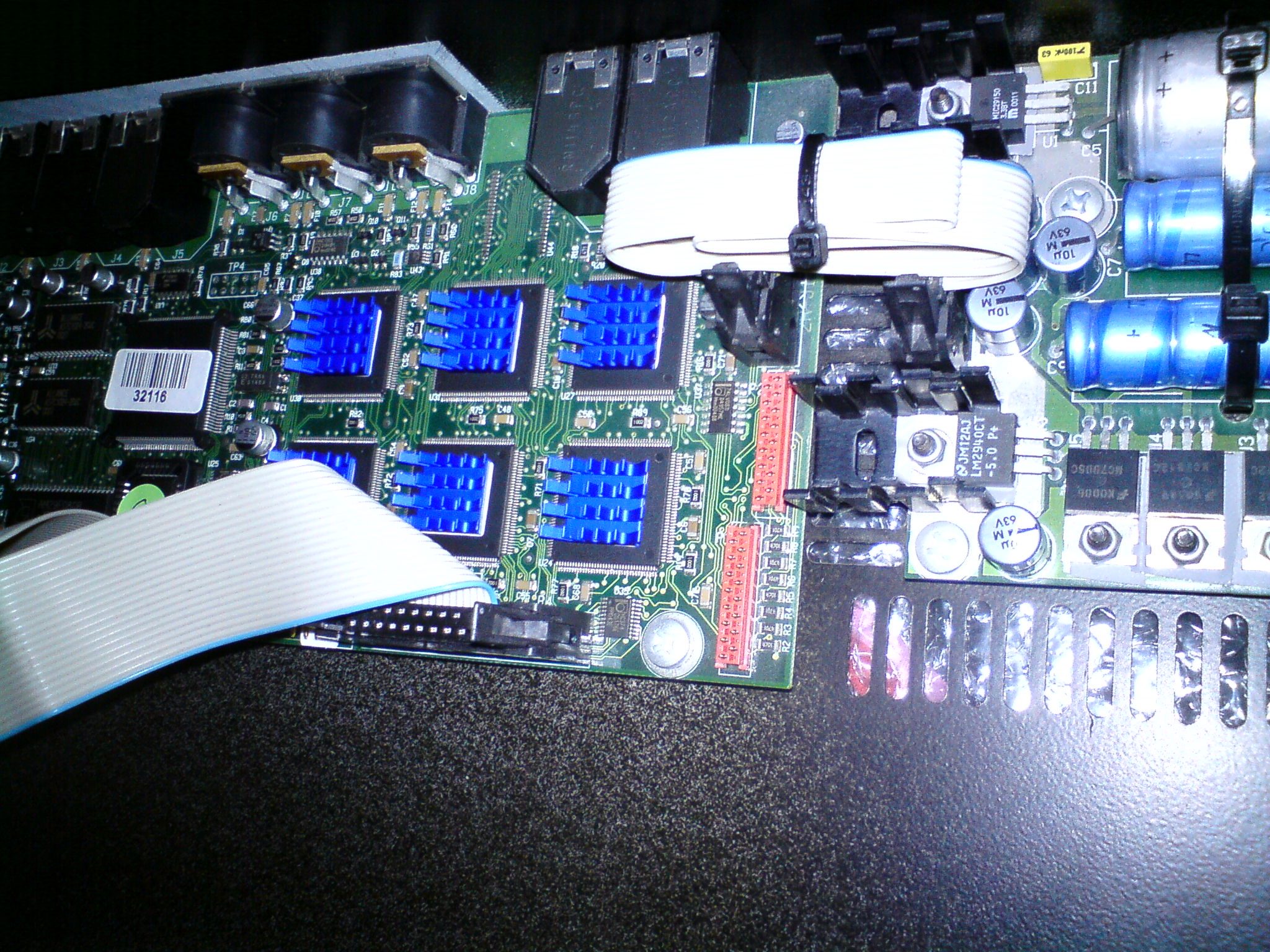

1. Disconnect the power cord.
2. Purchase and install a new fuse appropriate for 230 volts. Its hard to find the correct fuses in Paris. The only store I found was Selectronic, a specialty electronic parts store on Place de la Nation. It cost 1 euro.
3. Cut a section from a stiff wire clothes hanger.
4. With a lamp held close to the top panel vents above the power supply, its reasonably easy to touch the sliding voltage selector and slide it to either setting. Be careful not to slip off the switch and hit another component!
5. Buy a new 2 pin power cable. I simply cut my USA pins off and installed a euro 2 pin end that fastens with screws. It cost me 0.87 centimes at Bricorama or BHV.
There you go. I'm very glad not to carry a transformer around anymore!

I have some pics on flickr that illustrate the screws to remove for this process for a NORD LEAD 3 (the bottom two may lead you astray). I don't have an image editor, so I used flickr's 'notes' functionality - view at http://www.flickr.com/photos/hardcoder/4589878352/in/photostream/
Please note, I interpreted "Remove everything on top of the synthesizer" as a requirement to remove knob caps - this is NOT necessary... who's the knob then? :]
Posted Image, might have been reduced in size. Click Image to view fullscreen. (click for others)

Hi guys,
I need to buy 230V/125mA fuses for my future Nord Rack 3 (US model) and would like to know what are their size before placing an order? Are they "Ø5 x 20mm" ??
TIA!
    Until the year 2000
    or
    230/250V 100mA
    Since the year 2000
    115/125V 250mA
    or
    230/250V 125mA
Close the holder.

Thanks Wout Smile
Yep, I ordered a few today:
- 2x "Ø5 x 20 mm 125mA Time Lag Fuse (Slo-Blo®)"
- 2x "Ø6 x 32 mm 125mA Time Lag Fuse (Slo-Blo®)"
At least I'm sure one the two models will work!
I've also ordered a Ø5 x 20 mm fuse holder + a Ø6 x 32 mm one so I'll have potential spare parts in case something funky happens.
Will post the result as soon as I receive them...

OK, here's my experience:
My mint US Nord Rack 3 came with a Ø6 x 32 mm 300mA (3/10A) slow blow fuse.
So I replaced the 300mA with a 125mA model for 230V operation [Ø6 x 32 mm 125mA Time Lag Fuse (Slo-Blo®)]. Then switched the PSU to 230V... Did some cleaning and organization under the rack... And decided to add Zalman heat sinks to the 6 120MHz DSP chips... I'm thinking about adding 1 more (bigger) heat sink to the blue power transformer to help it cool down (adhesive thermal pad needed + heat sink needed).
Finally, replaced the original power cord with a brand new one (IEC C7 connector/2 pin EURO) and powered up the Nord... Works!
Great synth!!!
Nord Rack 3 US - Ø6 x 32 mm 300mA slow blow fuse

Nord Rack 3 - PSU switch to 230V
 Filesize:  792.22 KB
 Viewed:  1155 Time(s)
Nord Rack 3 DSP board - Zalman heat sinks installed on the 6 Motorola DSP chips
 Filesize:  759.1 KB
 Viewed:  1227 Time(s)
