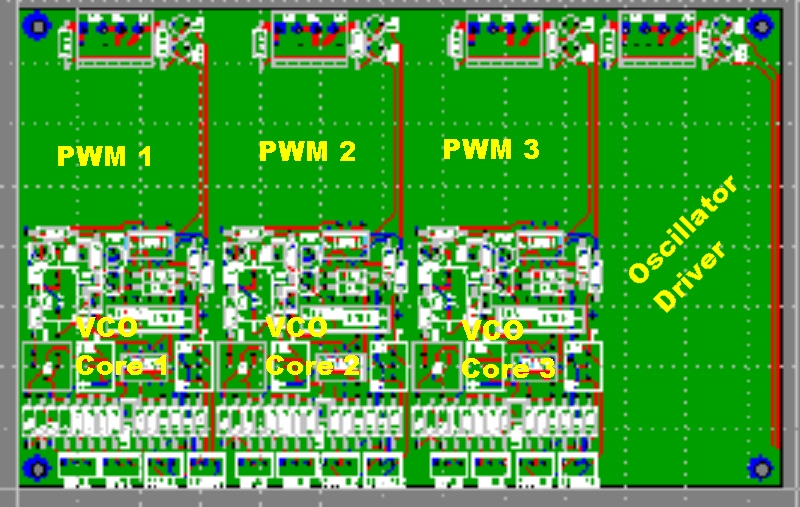

There is only so much I can put on a single PCB, and I decided to put 3 VCO cores there, plus a discrete PWM circuit per VCO, just like the JH-5 has.
JH.

PostPosted: Sat Feb 28, 2009 3:49 am    Post subject: Reply with quote  Mark this post and the followings unread
Here's a little preview of what I'm working on.
Looks like I can indeed put 3 VCOs plus an Oscillator Driver on a single board! This may get very close to the whole oscillator section of my JH-5, just on a single 160mm * 100mm PCB.
JH.

Just finished PWM section of one channel.
PWM will be all discrete - no opamps in here!
Also, PWM works like in the CS-80: You can heavily overmodulate it without loosing the signal!
JH.

PostPosted: Sun Mar 01, 2009 1:29 am    Post subject: Reply with quote  Mark this post and the followings unread
Well, you don't waste time do you Smile Congratulations on the progress.
I will purchase two PCB sets at least regardless, but was wondering what tracking accuracy you were shooting for?
For outputs, there will be a PWM amd sawtooth as in the JH-5, right?
Thanks for your efforts and for sharing your skill and talent.
David
Tracking: decent. Good enough for a mono synth. No efforts to get ultimate precision.
PWM and saw, yes.
JH.
