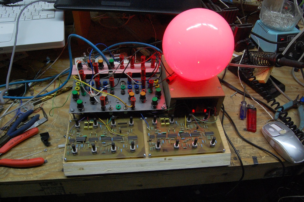

still working on my dual benjolin.
The red ball in the picture is a high power LED controlled using the benjolin's PWM output.
I've added few of little mods and will probably add some more.
-4 channel mixer
-patchbay with 4 attenuators
-fine tune for all 4 osc
-2 shift register clock input jacks and selection switch (int/ext)
-2 patchable LEDs (Not the high intensity ones... these are just mounted on the faceplate and used for looking at the different signals available in the patchbay).
-on board power supply.
-2 banana to 1/4" bridges for connecting to external gear like the clock in on my echo unit.. or my modular synth.
The mixer has 2 banana to 1/4" bridges as well if I feel like plugging other stuff into the mix.
This thing is a BEAST. Tons of fun to play with. I leave it on all day while i'm in the shop. The patchbay has really made all the difference. If you are still working on your benjolin, add a patchbay! and throw in a few attenuators! Mine are all configured as voltage dividers (right lug IN, Left lug GROUND, center lug OUT) and they work great. Being able to vary modulation is essential ( to me at least :p)
I've been playing with using different outputs to control high intensity LEDs. The PWM output is especially useful and can provide some nice fading effects.
I still need to set up a triple driver to power a tri color LED. Should be cool
Nice work and I agree, having visual FX is a nice addition to have .... it's gets you "in the zone" when performing and gives something for the audience to look at to. Wink
Since I already had an external mixer, I to use multiple outputs from the Benjolin. Good idea to just build a DIY mixer Pete.
One thing that would be a nice ad on is to add chaotic amplitude shifts using a VCA and the rungler circuit. One can then add as much depth as required. Then you have all the elements. The ability to sweep frequency, filter cutoff, and the added amplitude modulation.
As Rob said, there are many ways to pimp this thing out !!!

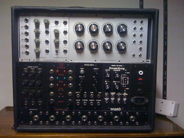

My eurorack Benjolin.

PostPosted: Fri Mar 05, 2010 4:25 am    Post subject: Reply with quote  Mark this post and the followings unread
Oh Awesome !! A first I believe .. Nice work mono Wink
Like the big Knobs Very Happy

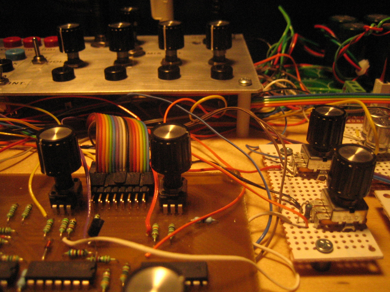

PostPosted: Sun Mar 13, 2011 3:59 pm    Post subject: mine thus far Reply with quote  Mark this post and the followings unread
many mods.. the video description has them all.
Inspired by Pete Edwards build
