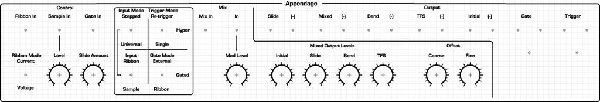

Hello , working around the idea attached, 1U rack.
How do you see it? Any opinion will be welcome.
About the INPUT MODE switch, I would like to know if it affects to both, the ribbon input and sample input, or only to the sample input?

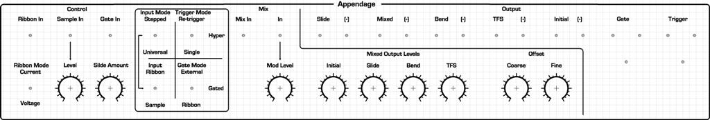

The "INPUT MODE" only applies to an INPUT "SAMPLE". The "UNIVERSAL" processes external inputs that change smoothly. The "STEPPED" input processing is good for, well, stepped inputs like those from external CV keyboards like my IKC or ones from Doepfer, MOOG, etc ...
This is reason why I designed the graphics on my panel to indicate the "INPUT MODE" function is exclusive to the "SAMPLE" inputs by drawing a line between them.
Hope this helps Sound Very Happy
The panel looks nice and compact, nice job so far man !

Thanks Bill this helps a lot, Ill modify a little the design accordingly.

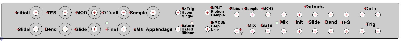

Here's what I ended up doing. Pretty happy with the results, nothing was too cramped. I did end up grouping knobs / switches / I/O separately, which has its pros and cons.
-gerald
I used FPD for layout - and hand drilled the panel myself, so the text and etchings are not in perfect locations.

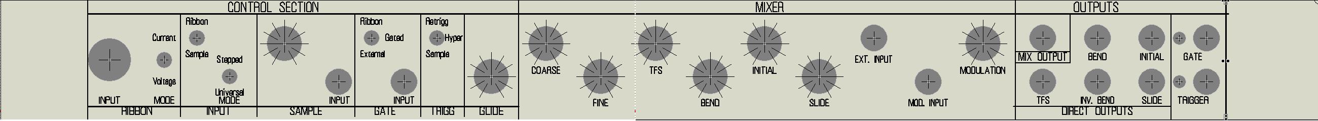

Appendage preliminary design, 17" panel to go in custom controller
Think I've got everything there, as you can see I did attempt to split it into the 3 sections. Made in Front Designer 3.0.
George

Nice so far George Very Happy The layout is very logical. I would like to make a suggestion. Since you had added multis to the TRIG and GATE signals, you might want to add some for all the CV outputs. You will definitely find that you will want to control more then one thing off a single output.
Nice work !
Thanks for the input Bill, I'm a bit contricted in the design as I want to have all jacks at the top so as not to interfere with the ribbon below the panel, (cords sticking out) but I will think about it...........multis are good!
Sure George, your welcome. Another approach is to just make a few "Y" cables and use those as your multis thus no panel space required.
Have fun with it ... it's looking great. I am loving the keyboard/ribbon controller rig your building.
