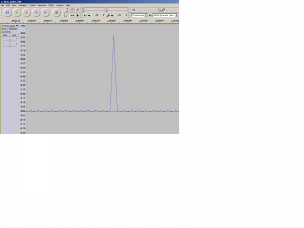

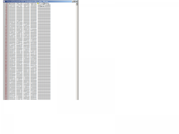

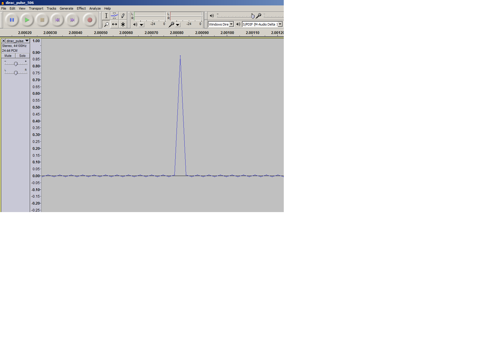

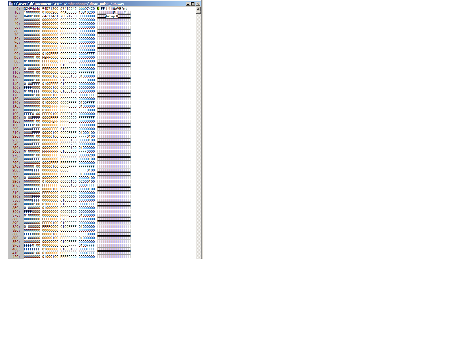

Nonetheless, dirac-pulse.wav appears to have been normalized, filtered, and dithered making it rather useless for test purposes.
The test file dirac-pulse.wav contains "a momentary (one sample) non-zero event" - the definition of a Dirac pulse - that reveals any filter's impulse response. In the case of a crosstalk cancellation filter such as the AmbioDSP plug-in, the cancellation impulses seen are in general channel-alternating and phase-alternating at a periodicity corresponding to the user-adjusted inter-aural delay determined by the loudspeaker layout geometry. For typical layout delays, see the AmbioDSP user guide at http://www.filmaker.com/products.htm (along with illustration of stereo v Ambio geometry and how it affects Listener Envelopment, LEV.). Note that that AmbioDSP plug-in has other user-adjusted filter characteristics to correct for the perceptual errors inherent in ordinary crosstalk cancellation implementations.
Robin Miller
j_b
Joined: Jul 14, 2011
Posts: 3
Location: TX
PostPosted: Fri Jul 15, 2011 7:02 am    Post subject: Reply with quote  Mark this post and the followings unread
Attached is a hex dump of the beginning of the file and an Audacity screen shot of the pulse in one channel. The amplitude of the pulse is less than maximum suggesting the file was normalized. The pre- and post-ringing is indicative of a filter. The low level noise seen in the hex dump is indicative of dither and persists throughout the file.
 Filesize:  93.8 KB
 Viewed:  1026 Time(s)
 Filesize:  75.23 KB
 Viewed:  1001 Time(s)
rmiller
Joined: Feb 03, 2003
Posts: 42
Location: Bethlehem PA 18018 USA
PostPosted: Fri Jul 15, 2011 7:54 am    Post subject: Reply with quote  Mark this post and the followings unread
The test file signal was made on purpose conservatively below FS (full scale) so users would be less likely to experience clipping the DUT (device under test) - the result can simply be scaled up if you need a precise IR amplitude. Ditto bandwidth limiting for 44.1kHz use in order to avoid troubling out-of-band artifacts due to aliasing - properly showing up as pre-post "ringing." Dithering (triangular, as the file was made at 32 bit resolution and converted to 16 bit for use) is acceptable engineering practice as it affects only the least significant bit. Of couse anyone may create their own version, but please note that it is a theoretically perfect Dirac that would be useless for the intended purpose of general testing in the real world.
Robin Miller
j_b
Posts: 3
Location: TX
PostPosted: Fri Jul 15, 2011 9:32 am    Post subject: Reply with quote  Mark this post and the followings unread
Then you should have identified the file as a normalized, filtered, and dithered, Dirac-like pulse. It isn’t "a momentary (one sample) non-zero event” as you claim.
A theoretically perfect Dirac pulse is exactly what’s needed for real world testing. If the system I’m testing clips, I’d like to know about it. An impulse response is not something you’d want to listen to. For that reason, limiting the bandwidth and adding dither to the pulse is not only unnecessary, but renders the impulse response useless for its intended purpose.
BTW, your terminology is little mixed up. Aliasing is when a frequency higher than the Nyquist frequency is converted to an ‘alias’ that is lower than the Nyquist frequency. It only happens during the analog-to-digital conversion, hence the need for an anti-alias filter before the D/A.
Finally, a casual look at the hex dump shows occasional sample values of 2 and -2. That means the added dither occupies two LSB, which is twice what you claim.
