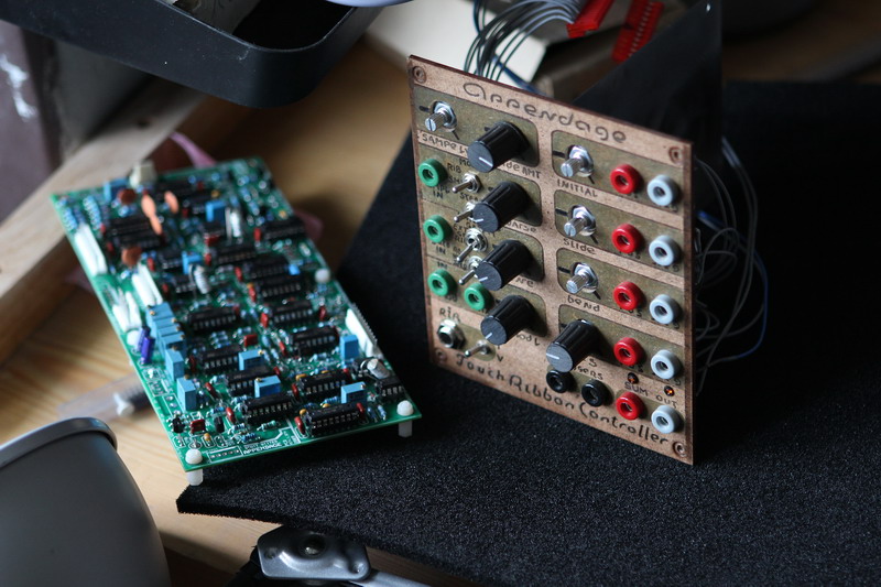

Hi guys!Almost done!My near third serious project,no need to say how it was difficult ,here in Leningrad find out those components..but thankfully online shops all is picked up and populated! I came with 500cm Spectrasymbol,the standoff I done is masterpiece.THE CALIBRATION.
If you thinking that there is something wrong you are absolutely right,so let's not pigeonhole and c'mon get close to my trouble!
I believe that all components stuffed correctly,same for caps,ic,etc.doublecheck
Step1. It's O.K. 1.5v I/V respectably
Step2. Trimming from0.009v I came to pos.rail at 13.7v with Gate led starting flashing,and after excessive turning couldn't come to reasonable response(specialy at low end of ribbon)moreover WITHOUT pressure applied the led is still tends to lit,and goes off only at extreme turning VR1.
Step3.5 no problem here -4.5v done
Step3.7oops..reads neg.-1.5v and all I could get is 0.v,no pos.voltage
Step3.9 VM reads -0.006v and VR2 can't do nothing..(it seems no effect from turning) so no pos.v is achieved .
I took measure at pin 10 of U13 it shows+4v(no pressure applied to rib)the same with disconnected ribbon.So little frustrated I stopped at this point waiting your healing tip.

PostPosted: Mon Apr 23, 2012 4:12 pm    Post subject: Reply with quote  Mark this post and the followings unread
the leds lit still.... Shocked
PostPosted: Mon Apr 23, 2012 6:19 pm    Post subject: Reply with quote  Mark this post and the followings unread
Your problem at Step2 sounds suspiciously like a problem I had when I was calibrating the prototype. (Not getting a definite on state, and then not able to get the led to turn off.)
In that case it actually turned out to be a dodgy softpot. Bill sent me another one, and it all worked perfectly. We ended up thinking it was because when he first sent them out, he kind of folded them up (gently, but even then).
Now I think he coils them into a loop around a former when he ships them.
Do you have a second softpot you could try? Did they "fold" them when they sent you this one?

PostPosted: Wed May 02, 2012 6:24 am    Post subject: My ApNdg Reply with quote  Mark this post and the followings unread
here is my not yet calibrated Apendage unit[/img]
 Filesize:  146.21 KB
 Viewed:  4795 Time(s)
PostPosted: Wed May 02, 2012 6:54 am    Post subject: Reply with quote  Mark this post and the followings unread
Looks very cool!
