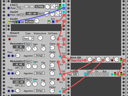

Hey, I found some extra modules in the editor that actually seem to work!
It's a "resonator" module and "driver" module. I don't know exactly how to use them or connect them, you can see them below in the screenshot.
There are some more modules that never made it into the G2, I tried some of them, but not all seem to work. Maybe because they don't exist in the G2 firmware, or maybe I haven't formatted the message correctly.
ModuleType ShortName
AR-Env
AudioIn
Blue2Red, seems to be a testing module
BusIn
ClkDivFix
35 Driver -> Works!
EnvDX
LfoD
Mixer6-1A
Mixer6-1B
OutBusA
OutBusB
PeakFollow
101 PolarFade -> Doesn't seem to work
120 PolarPan -> Doesn't seem to work
10 PulseOsc -> Doesn't seem to work
Red2Blue
56 Resonator -> Works!
207 RndChaos -> Doesn't seem to work
RndDistr
RndState
RndStep
SeqA
104 ShelvEQ
14 SyncOsc -> Doesn't seem to work
The bottom screenshot shows some of the modules I tried sofar, so only the Resonator and the Driver worked, but interesting none the less!
I wonder what the driver is supposed to do...

Seems like physical modeling. The Driver is clearly an exciter model, used probably to excite the Resonator (which is also likely to be a typical PM resonator - it's set to strings at the moment). Strange that it lists pretty much wind/brass exciters, while the resonator has strings added in (the "tube" would represent the body of the wind/horn). There is a bow exciter listed, so that must be it. Probably a short burst of noise could be used in lieu of a proper pluck exciter.

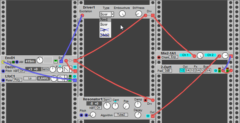

I suppose the "drive" inputs/outputs are meant to be chained like so.
These two modules seem to be the only ones that work. That's a pity, the RndChaos, PulsOsc and SyncOsc seem interesting also.
I'll try and make an intermediate release soon that include these two new modules.

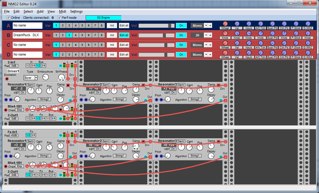

I tried the static clockdivider but sadly no, g2 won't have it. I guess we just have to be happy with whatever falls our way.
Alle these other modules have a distinct "test"/"prototype"/"not really ready" feeling about them, but I'm really happy with the driver/resonator.
The driver has 4 modes "Reed", "Bow", "Lips" and "Mallet" but for one reason or another the last two are crossed out. Maybe they don't want us to use them...
Then the resonater has 5 algorithms: 2 string and 3 tubes.
They are quite expensive DSP wise, can only have 6 per patch on an expanded G2 and the you have to devide them over VA and FX location.
But if you patch'm like this, taking the input from another slot, you can make some really big sounds. Razz

I did a little compare, they sound quite different. I bit more rough maybe. They are very sensitive around the self-oscillating frequency, especially the "tube2" algorithm, which can result in massive clipping of the output.
I'm very happy that it's these two modules that work, since they might be difficult to reproduce with other modules, so really interested what you can make out of these. Very Happy
Maybe you can als figure out what to do with the "Excitation" input of the driver module.
