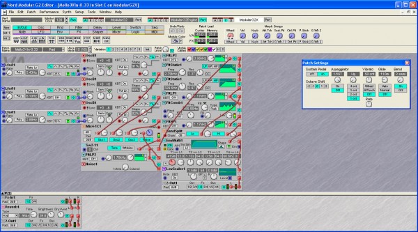

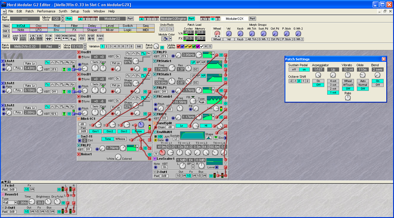

The last year has been busy with both professional and domestic duties severely minimizing my available time for music and G2 patching. If nothing unexpected happens, the second half of 2012 may be better.
While re-acquainting myself with the G2, I found this patch that is kind of work-in-progress. Since I probably won't have time to develope the patch in the foreseeable future, it seems appropriate to post it here so someone else can refine it (if it is good enough to deserve that).
The patch aims to simulate the Mellotron sound called "3 violins". It is based on 3 oscillators (with separate vibrato LFOs) and some filters (including a simple string filter). Filtered noise is added to the upper range of keys for increased authenticity. The mod wheel controls attack time. A simple G2 reverb is the only FX used.
The patch layout.
