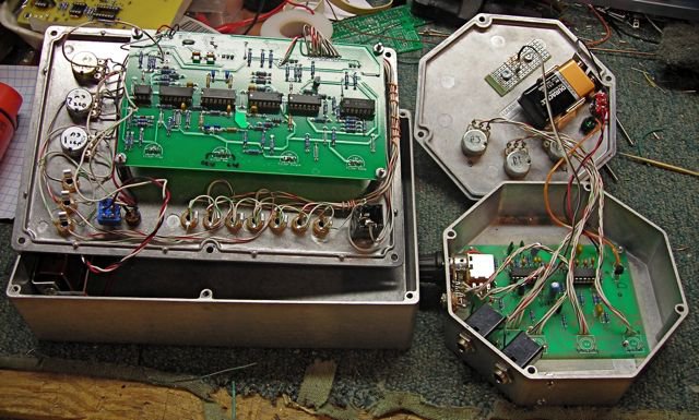

fetideye
Joined: Jun 22, 2015
Posts: 27
PostPosted: Sat Oct 10, 2015 2:37 am    Post subject: my benjolin
Subject description: banana
here's my benjolin i build (a while ago)
I rewired it yesterday, because the header pin wires were failing, those were very thin wires!
replaced the 7809 as well.
now all is well again Smile

PostPosted: Thu Jan 07, 2016 12:37 pm    Post subject: Reply with quote  Mark this post and the followings unread
Surprised Fetideye- what happend to your connector? And regulator too?
Nice looking box you have there. I´m still building my double benjolin (that will live in an old east german toolbox) and are interested in your xperiences happy smoker
Macumbista- Your butterfly benjolin is killer. And letterstamped is so beautiful if done well, I could never achieve that when I tried, maybe I should try again...

fetideye
Posts: 27
PostPosted: Thu Jan 07, 2016 2:33 pm    Post subject: Reply with quote  Mark this post and the followings unread
i etched the pcb myself. the holes for the regulator were a bit too small and i couldn't get a fitting regulator. because of this, I had some problems with the power (only 1 side worked sometimes)
i wired the headers with dupont wire (with connectors) , that was a bad choice.
ps: a a synth meeting I met a guy who had modded his benjolin with multiturn pots (as fine frequency control) . I think i'm going to do that too!
(wired over the existing frequency pots)

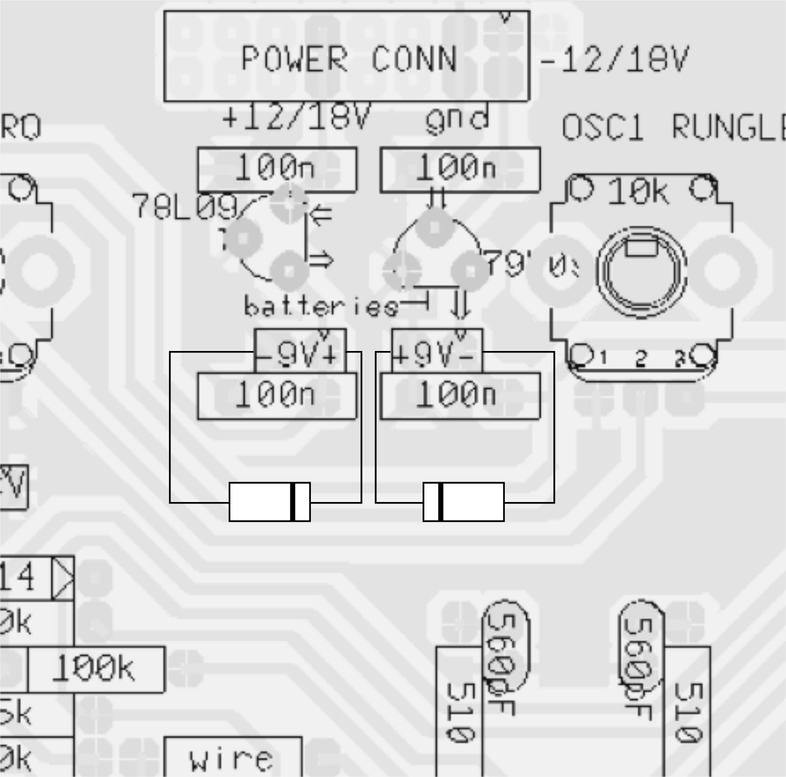

PostPosted: Fri Jan 08, 2016 6:05 am    Post subject: Reply with quote  Mark this post and the followings unread
This could also be because of the regulators themselves. Rob recommends putting reverse-biased diodes just after the regulators to prevent this, it's written somewhere in the documentation Wink

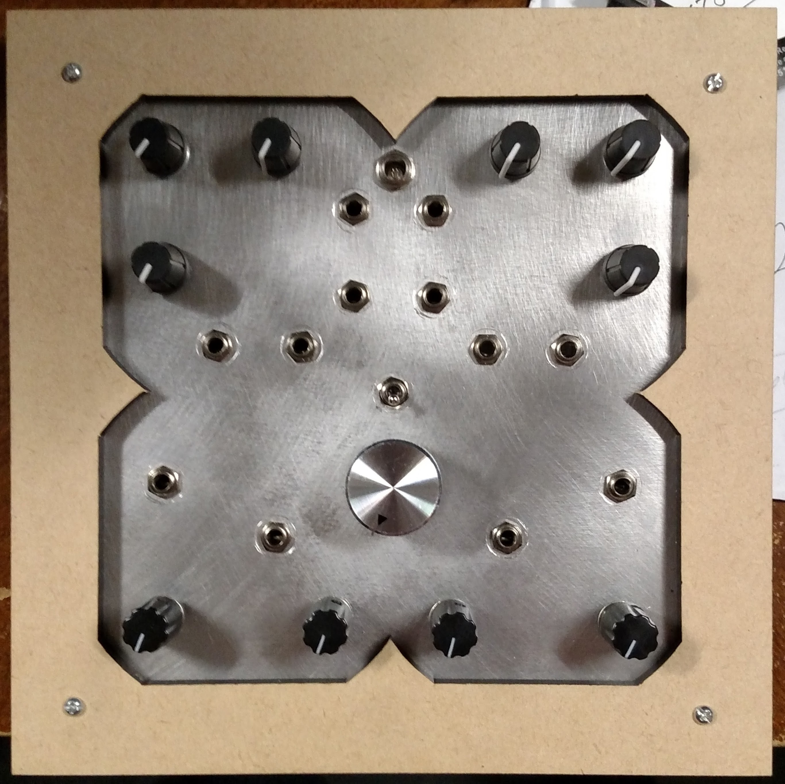

PostPosted: Fri Jun 24, 2016 5:11 pm    Post subject: Reply with quote  Mark this post and the followings unread
This is my Benjolin standalone unit adapted for an interactive art show in Santa Fe. The front selector switch chooses the various output. I added a rack mount compressor/limiter to the output which equalizes volume through the transition from filtered(low level) to pulse, sawtooth wave(high) nicely. Next time I will spring for the extra long potentiometer for the oscillator pitch. Thanks to MFOS for the power supply PCB art. I love my Benjolin!
 Filesize:  422.77 KB
 Viewed:  591 Time(s)
