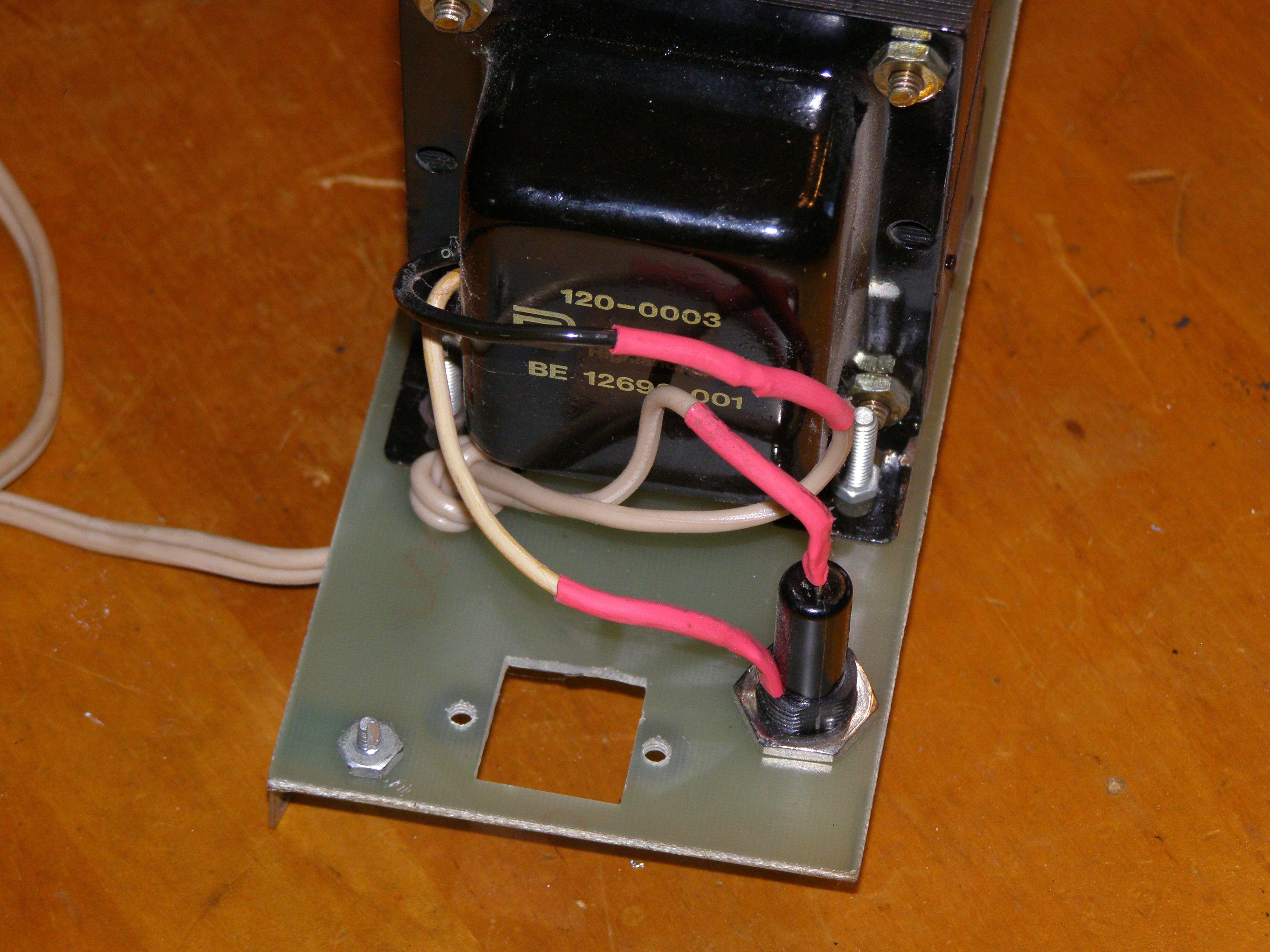

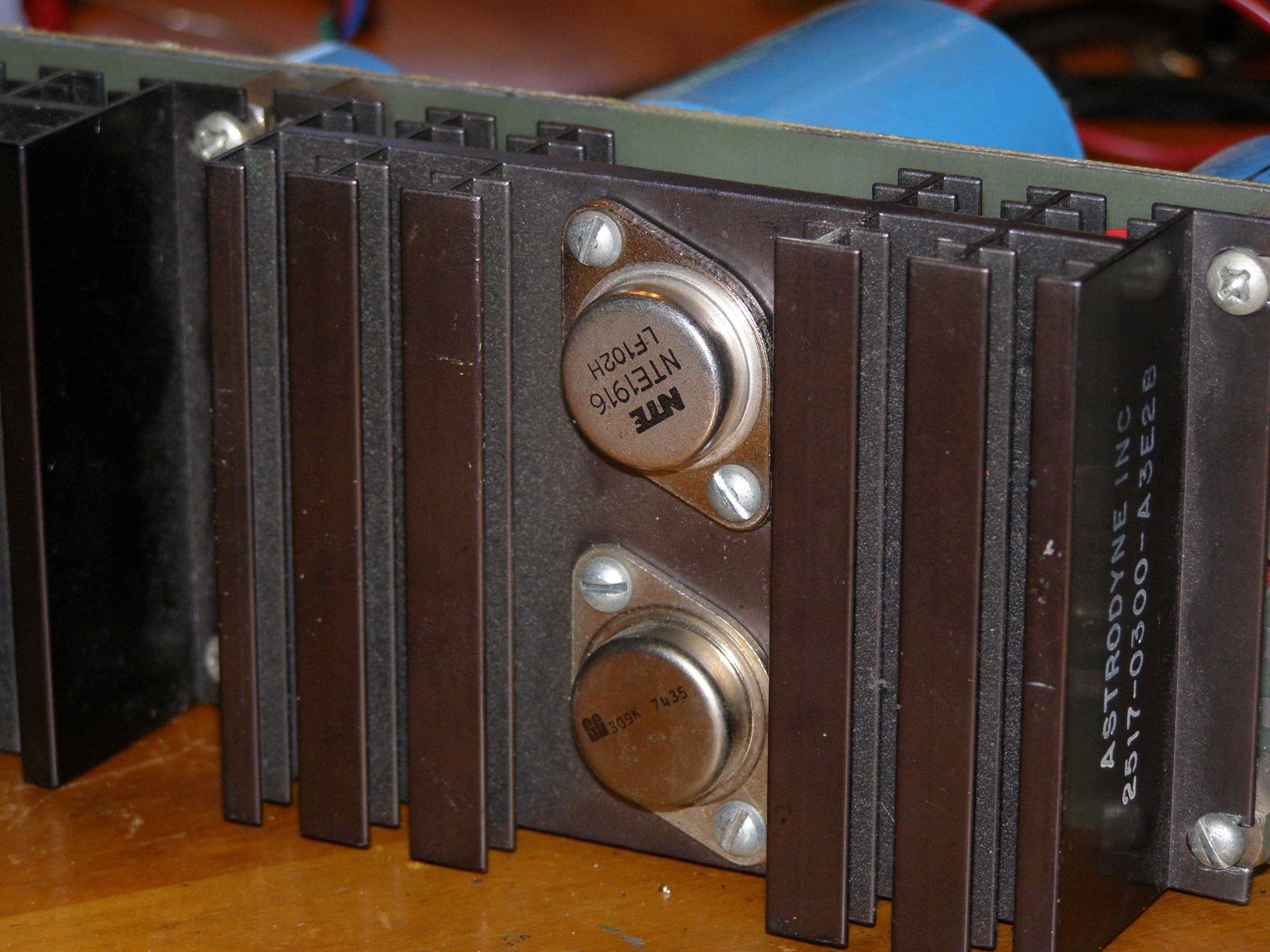

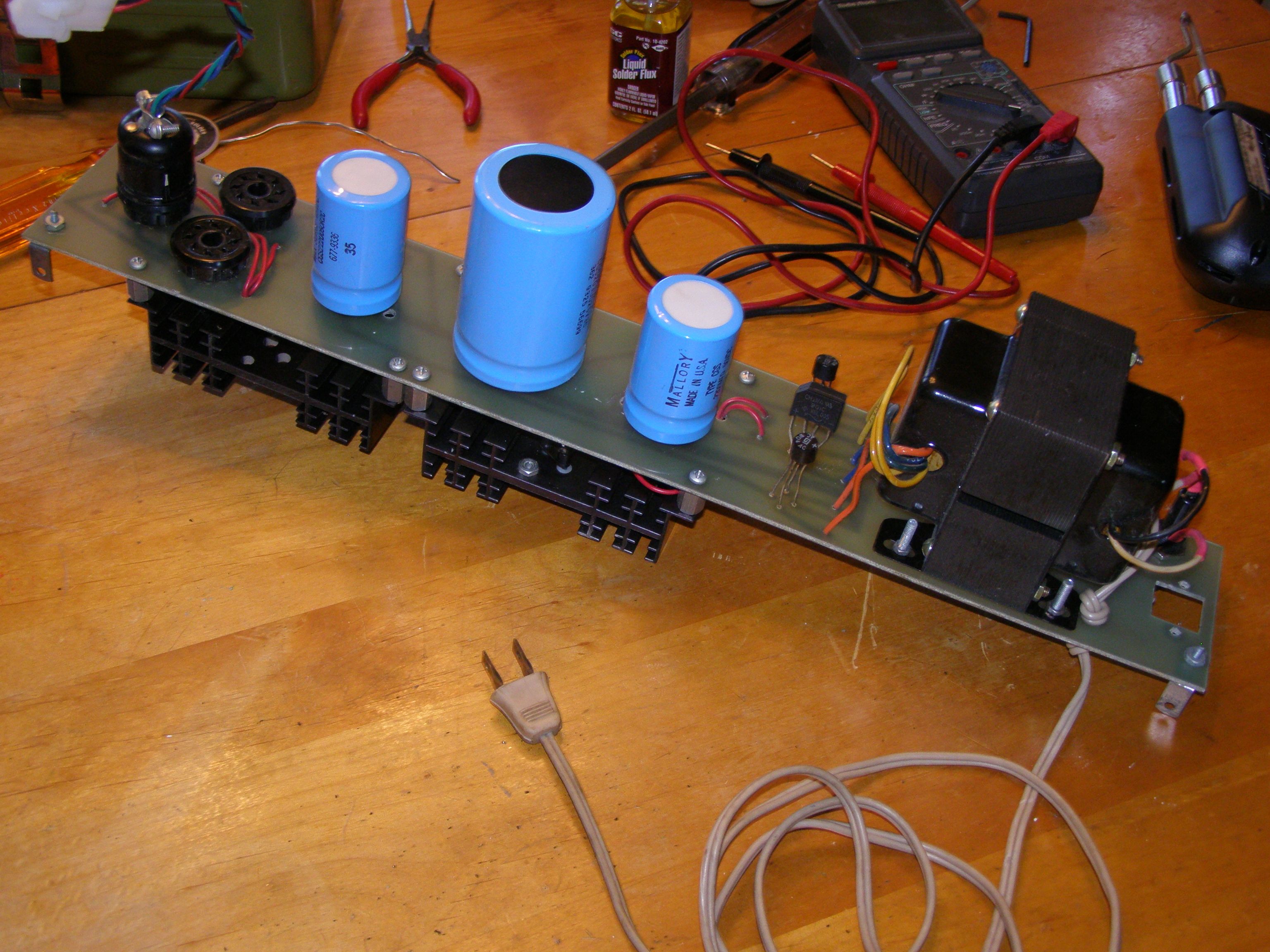

PostPosted: Mon Jul 20, 2015 11:25 am    Post subject: Repairs to my Aries Power Supply Reply with quote  Mark this post and the followings unread
One of the advantages of DIY is that one learns how to repair one's own equipment. My vintage Aries power supply still works to spec. Over the years I've had to replace the filter capacitors and the +15v rectifier and voltage regulator (my most recent repair). Attached are photographs with comments about the power supply and repairs.
The NTE1916 is the replacement Voltage Regulator. The pins (underneath) are not centered, thus the part can only mount in one direction. When I first installed this regulator, it didn't work. Then I looked and noticed that the labeling is "upside down" compared to the original. I checked the datasheet and confirmed that the pins were reversed! A quick swap on the pin connections did the trick.
The original Aries had two serious and hazardous design issues: 1) The mains voltage ran through an exposed fuse holder and, 2) the mains voltage ran through a front-panel mounted toggle switch. My solution was to do away with the power switch (it does not really need one anyway) and to replace the exposed fuse holder with a panel mount style holder.
While I have replaced this power supply with MFOS power supplies, this power supply will live on as a bench power supply (+15, -15, and +5 volts) and a backup power supply (just in case!).

PostPosted: Wed Jul 22, 2015 12:06 am    Post subject: Re: Repairs to my Aries Power Supply Reply with quote  Mark this post and the followings unread
Oh yes, I had the same problem with my 2n3055 power trannies in my Formant modular power supply. I had asked my local parts dealer how to connect them and he gave me a wrong pinout. I did not check the datasheet and finished the PSU. Unfortunately the PSU worked Shocked The output power was reduced and the output voltage had a kind of saw overtone, but this effect occured later when I added more and more modules. It took a long time for me to find that error Sad

PostPosted: Fri Jul 24, 2015 9:16 am    Post subject: Reply with quote  Mark this post and the followings unread
Hi Kevin! What made you decide to replace the PS with a new one? Also you did away with the front panel/switch. Does it simply power up when plugged in, or does your new power supply have a switch? I plan on learning as much as I can from you. As stated on my introduction post, I have a recent Aries addition to my synth-family. The power supply was off on the positive side, I replaced the regulator and it is working now, albeit not exactly 15, it is around 15.2+ VDC.. The - is at around -15.02. Also, I have been guessing what the +5 is supplied for? Is it for the osc CV outs on the keyboard? Thanks, John C. in Norman OK

PostPosted: Mon Aug 17, 2015 5:10 pm    Post subject: Reply with quote  Mark this post and the followings unread
The reasons that I replaced it was because I already had all the parts for a new (higher-capacity) power supply. I believe the Aries Power supply was a bit challenged to drive all the modules that I added over the years. Also, I really need a bench power supply and the old power supply is more than adequate for that. The new power supply is lighter, too. Incidentally, I am using the MFOS 3 Amp power supply -- I now have two of them in my synthesizer. Indeed, I don't have an on/off switch -- I just plug into a power strip that has a switch. I'd like to add a power switch at some point but it isn't really high-priority.

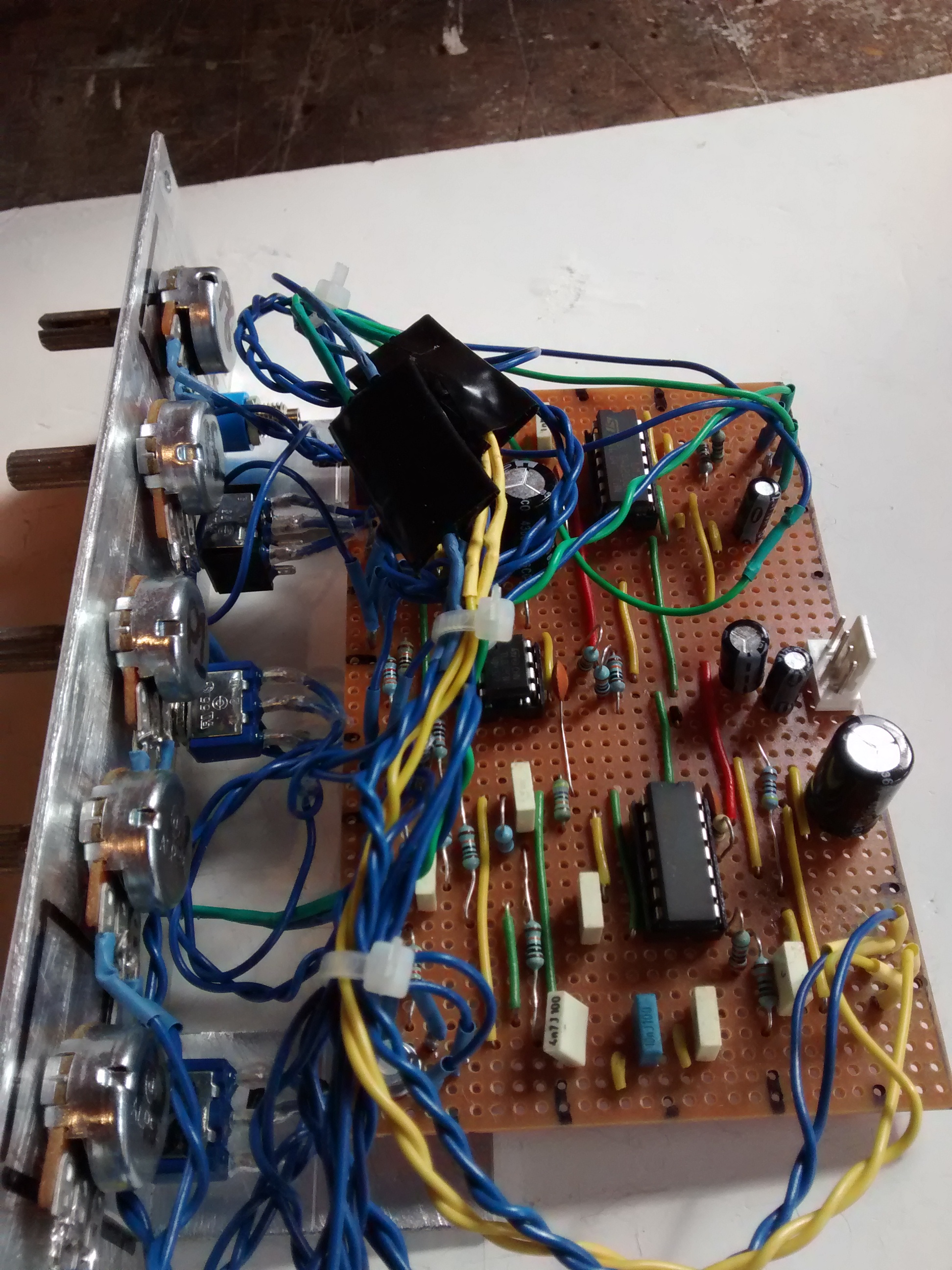

PostPosted: Tue Sep 15, 2015 5:29 am    Post subject: Reply with quote  Mark this post and the followings unread
Latest build - a four 40106 drone module by PhoBoS, with a few mods, chiefly adding in an external CV input for the PWM, which allows control by an LFO or any other CV source. I also added extra caps on a switch to give a range of low-pass filter options on the output.
The things in black insulating tape are home-rolled vactrols.
