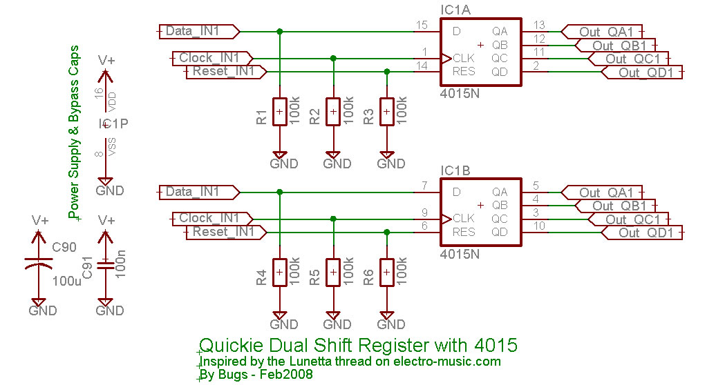

To get some ideas rolling, here's how I reckon you'd hook up the 4015 Dual Shift Register... As mentioned by Tim Servo in one of the other threads, the inputs are tied to ground with 100k resistors - that's a standard practice (I think?!) - so, if nothing is plugged into them then they'll be kept as a stable low state.
(As a slight aside, though -- sometimes you'll come across chips with pins that are active low - in such cases you'd tie the input to V+ via a 100k resistor)
Anyways, back to Shift Registers ------- you feed some pulse-train into the Data input and the value is read whenever the Clock input goes high. The stored value is then passed down the line (QA to QB to QC to QD) with each successive clock.
I haven't yet tried this circuit, but will soon, no doubt!
Looks right, I think?!

i just came across this schematic
http://experimentalistsanonymous.com/diy/Schematics/Oscillators%20LFOs%20and%20Signal%20Generators/Complex%20Waveform%20Generator.gif
i was planning on ignoring everything but the shift register and the xor gates
if this sounds good i figure it should be a nice way to hardwire one half of the 4015

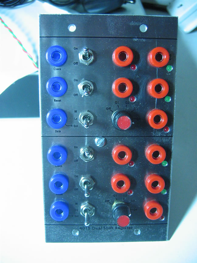

Hey, I got a couple more modules done up (and more on the bench too)
One was a dual shift register based on the schematic posted at the top of the page. I got some really nice and very compact rotary switches as an end-of-line from Farnell, so used some here..
Next weeks or so I'll be putting much more detail up on my site such as schematics and front panels, but just thought I'd share for now..
Working on a new portable frame for my modular system (or part of it) so ain't doing much playing until that's done....
Oh yeah - the for the Data input I've used a SPDT Centre off switch -- in the up position it ties the data high, in the middle its disconnected (so pulled low by a 100k resistor) and in the bottom position it is connected to the banana socket.. Seems pretty versatile!

what do the other knobs do? the schematic up top has no switches or pots?? i made this circuit too...good noise maker!!

Oh, its not a pot - its a 5way rotary switch --> so I've just taken the four stage outputs and passed these on to the switch with the 1st position offering Off.. I figured it'd be a useful addition.
So, the rotary goes: Off, Q1, Q2, Q3, Q4
(I'll do some more details over the weekend to show the panel.. Behind it is really simple -- small piece of stripboard with the 4015 and just a few resistors etc - that's the Lunetta joy!)

PostPosted: Sat Aug 15, 2015 3:41 am    Post subject: Reply with quote  Mark this post and the followings unread
Just found this old thread and breadboarded the circuit.
I can't hear anything Sad
0-5v square LFO as trigger and data but the outputs are 0V Sad
Whats wrong with it?
Steveg
Joined: Apr 23, 2015
Posts: 184
Location: Perth, Australia
PostPosted: Sat Aug 15, 2015 5:13 am    Post subject: Reply with quote  Mark this post and the followings unread
You will get that if you feed both clock and data from the same oscillator. Use 2 different oscillators.
