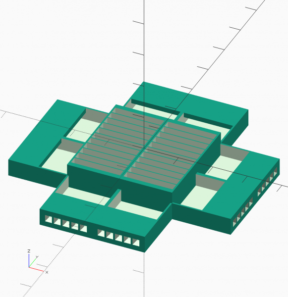

Joined: Oct 13, 2007
Posts: 6221
Audio files: 267
PostPosted: Mon May 15, 2017 2:11 pm    Post subject: Reply with quote  Mark this post and the followings unread
While the 3D printer prints a watch band sleeve to cover the buckle on my fitbit so it does not scratch the computer, I'm taking a moment to describe what I designed this morning. See the image below - it's a breadboard in a quadcopter arrangement. It is designed to receive those little breadboard clips taken from an old scrap breadboard and put them to new reuse in a custom arrangement.
The image shows a version with LEDs on the four arms and one central ATtiny84. This will work, however there is no threading for the ATtiny84 as mentioned earlier in this thread. So another version uses five ATtiny chips. At this point I'm not quite sure which to use. I am leaning toward the one shown as it has a much lower print time.
There were some emotional roller coaster type events earlier in the day, so I'm happy that the evening is arriving and I can work in peace.
Les
Posts: 6221
Audio files: 267
PostPosted: Tue May 16, 2017 12:55 am    Post subject: Reply with quote  Mark this post and the followings unread
I've been making progress on my new emSynth project. It's the optical interconnect one. I've figured out how to make it do Fuzzy Logic which I studied just a little back in college. The concept is very simple and I can explain it in time.
the images below show a custom breadboard design that I'm working on at the moment. The concept is to resuse the internal clips from old breadboards, placing them into a new plastic shell. This idea has been on my mind for quite some time now and it feels good to actually put it into practice.
Once built (and I am printing the first one as I write this), I will insert the clips and make a few modules. Actually now that I've made this design, I am thinking of a simpler way to make it. the difference is whether the four wings are printed horizontally or vertically like the rest of the design.
In the case shown, the goal is to make an initial foray into the realm of a fully three-dimensional breadboard, say like one wrapped around a cylinder or whatever. So it's an experiment as much as a prototype. Far simpler, I now realize I could have made those wings just like the rest of the breadboard, simply oriented at 90 degree angles. I may make both designs for comparison purposes.
Or basically if the first design does not turn out well, I have a backup plan. Either way it's a simple way to prototpe a small system!
