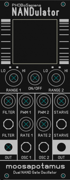

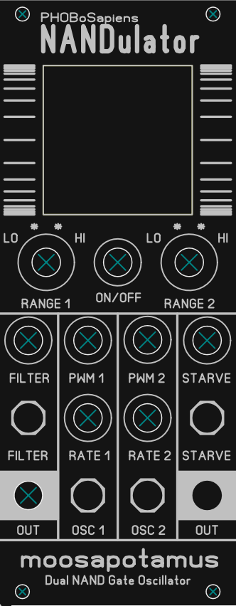

+1 and props to PHOBoS for this project and to electro-music for creating this awesome space for everyone to share their ideas. I may be late to the party on this one (The NANDulator) but I've been having so much fun with it on my breadboard that I decided to build it into a Eurorack module.

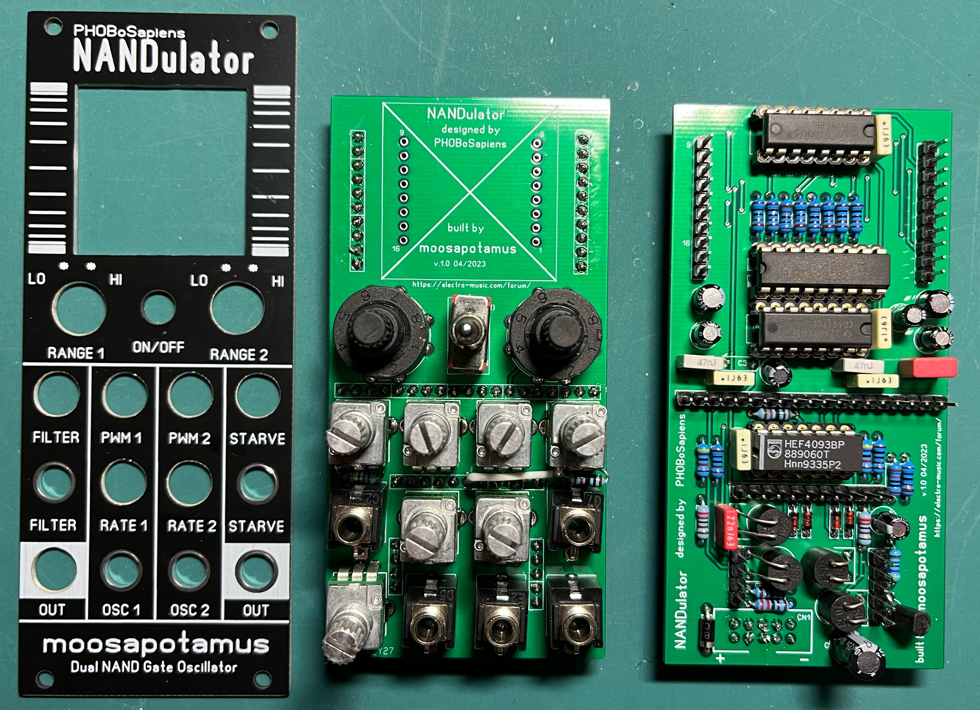

Here is my idea for the front panel. Added a Starve control and a pair of 2P4T rotary switches to change the capacitor values on each oscillator. Also added CV inputs with vactrols to modulate Rate 1, Rate 2, Starve, and Filter (P5 on IC1B). Not sure if 'Filter' is the best name for that control, but that's kind of what it sounds like to me on my breadboard. Also, the on/off is a 3-position SPDT on-off-(on) toggle, off in the middle, latched on in the up position, and momentary on in the down position.
It will have two PCBs. I'm almost done laying them out. Here's a look at what I am planning for the front panel. Thoughts and critiques welcome!

PostPosted: Tue Apr 04, 2023 1:31 pm    Post subject: Reply with quote  Mark this post and the followings unread
welcome to the NANDulator club or cult or whatever this is, great to hear you're having fun with it Razz
Making it into a eurorack module did cross my mind but I felt that without any (analog) inputs it might not be that useful.
I did make a board for Muied Lumens with a couple of comparators that basically function as a 1bit ADC for use with analog signals.
Vactrols should give you some nice effects though considering that those oscillators can be fun with an LDR.
I have actually not tried any starving which can be very effective with CMOS.
As for the 'filter', yeah that's kinda what it sounds like to me too,.
I think it's actually somewhat controlling/modulating the pulsewidth
What do you use for the output circuitry ?

I used the output buffer as in the schematic that you posted with the 8x8 LED display. Not sure if 100K to the LED in each of the vactrols is the right value. I still need to sort that. But, my schematic is below. It doesn't show the 8x8 display, but it is absolutely included in the module.
Of course, would be happy to hear any additional feedback or thoughts on the plan shown in my schematic.
I have PCBs on order. Still need to order the 8x8 display, too. I'm assuming that this one will do the trick...

I'll just order the Row Anode ones from Tayda, so it will be a bit before I can test my PCBs... which came today! I need to cut out the square opening for the matrix myself.

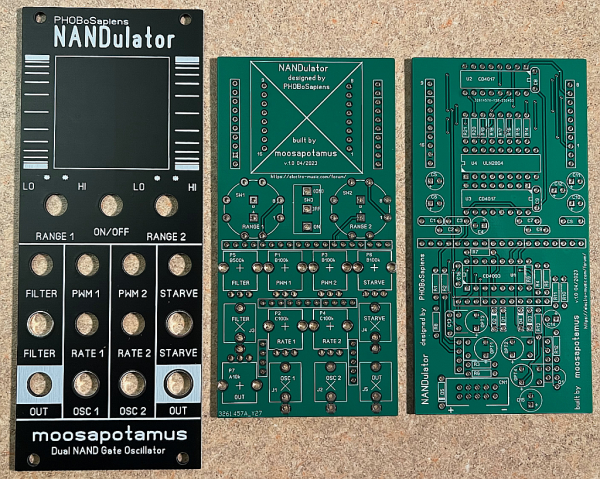

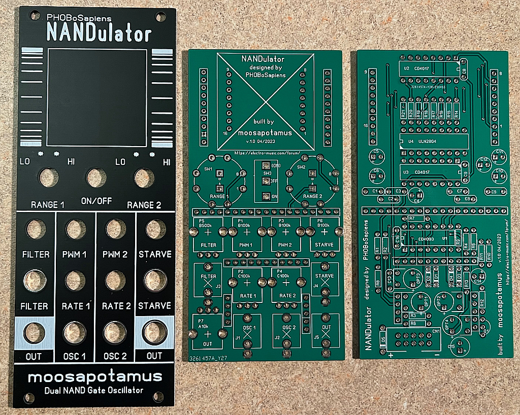

PostPosted: Wed Apr 12, 2023 5:07 pm    Post subject: Reply with quote  Mark this post and the followings unread
that looks very nice. Shocked Razz
appears larger than it is. knowing that it's eurorack.
hmm, it's not the worst material to work with but I hope that works out ok.
I did have a look at the schematic and nothing stands out as being wrong. I like how you shared the capacitors on the switches.
The output level might be a bit low for modular since it is designed as a line level output but you can easily boost it by reducing R9.
Not sure how the starve will work out with the display. If you are also starving that then it will affect the sound which could be
interesting but it could also limit the starve range. If you are not starving it then the 4017s might not get triggered properly anymore
beyond a certain point.

Cutting out the square opening for the matrix shouldn't be too terribly tough. Maybe I'm being optimistic, but having a nice silkscreen line to follow (as opposed to laying it out myself) helps a lot. I also have to drill out a few of the holes as the max diam that jlcpcb will do is 6.3mm.
Thanks for looking through my schematic! Well, it is mostly your design, anyway. Happy to send you a set of boards if you like (PM me). Although, based on your comments about the Starve control, understand if you'd rather wait and see/hear how v1.0 comes out. Just received the last of the needed parts. So, shouldn't be too long...
In this layout, I am only starving the 4093. It didn't occur to me that the 4017s might not get triggered enough to feed the display. Makes sense. Guess I'll have to just see what happens. I didn't have any displays when I breadboarded. Thought that part seemed relatively straightforward. Silly me!
OTOH, I don't quite see how starving the display (the 4017s) would have it's own affect on the sound. I had thought that would just cause the display to conk out, which is why I chose not to do it that way.
It should be possible to have larger holes but you probably have to make it a milling layer instead of drilling.
That's also how you could get the square hole to be cut out. The 6.3 might be the limit for hole metallization though.
Everything that requires current will have an effect when you limit the current.
At some point the display would indeed just stop working properly but it is possible that at that point
the rest of the circuit isn't producing anything useful anymore anyway.
Power starving is very experimental in that regard but that's also what can make it very interesting.

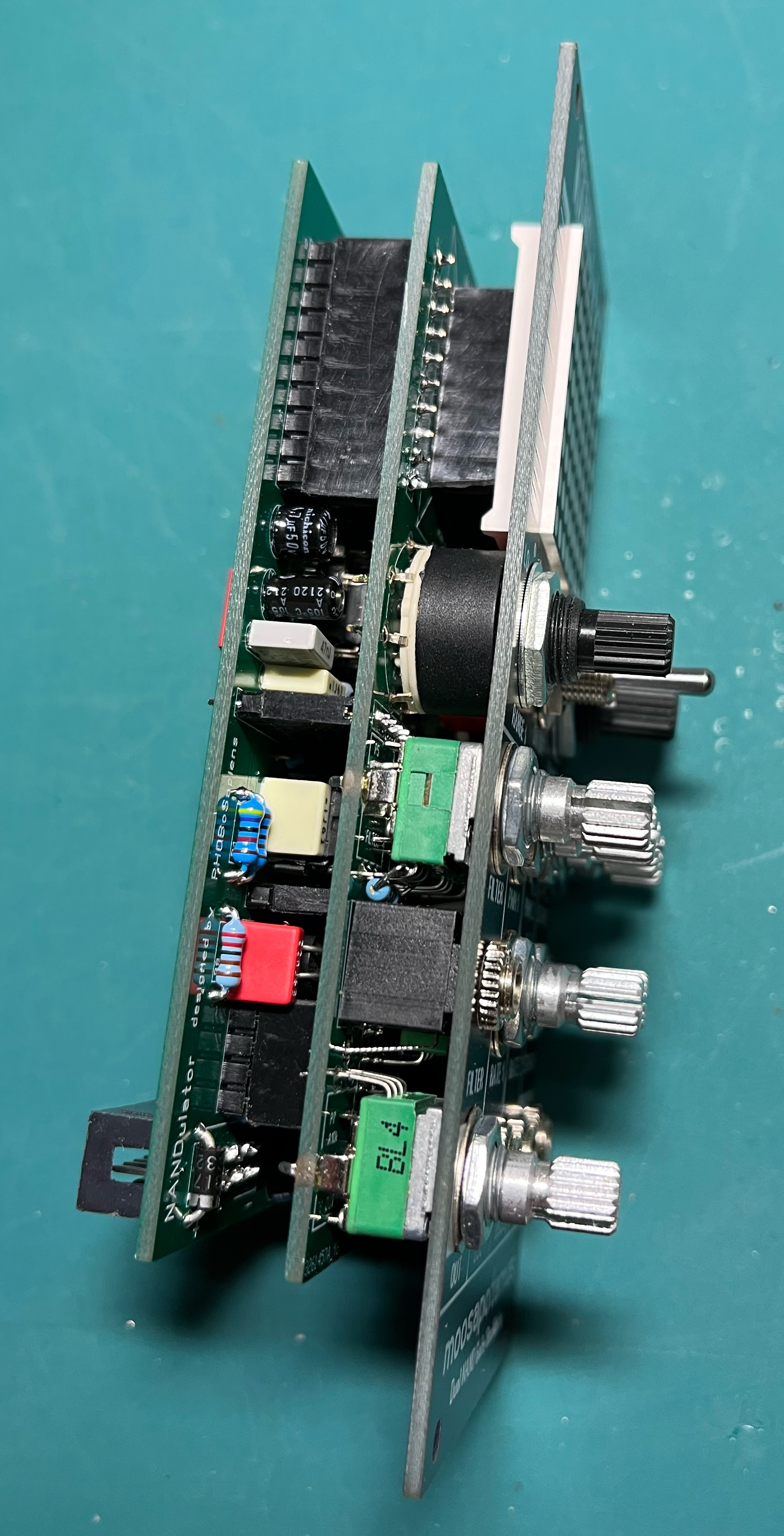

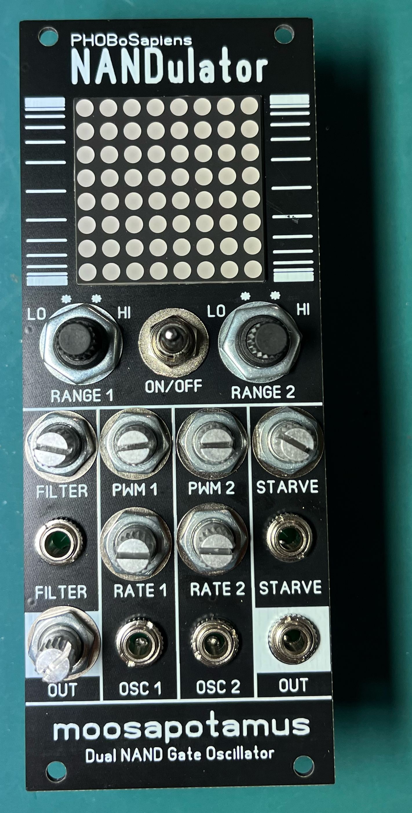

Here are some picks of how all the bits came out. Cutting out the square for the matrix was a little tricky. Honestly, I was a little too gung ho at the start and ruined one panel. But I took my time with the second and I'm relatively happy with how it came out. Just one minor blemish on the face.
I haven't picked out knobs, yet. Given the 10hp size, it's a little tight and the knurled shafts, while not being particularly attractive, I think allow for easier control. But the rotary range switches, at least, could probably use some knobs.
Getting some modulation from the Starve and Filter inputs, now. Turning Starve up all the way does eventually blank out the display, but doesn't necessarily mute the output. Starve also causes the output volume to drop. So, the volume control is quite useful. And the Starve control is a nice add-on.
The range switches are also a lot of fun to play with. I could stare at the display and doodle with this for hours! I'll post some better audio/video when I have a bit more time.
